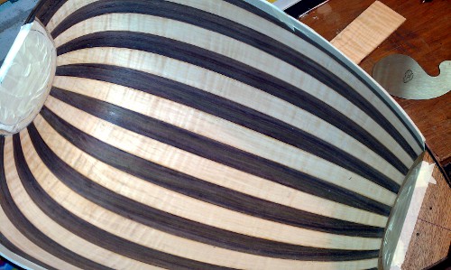

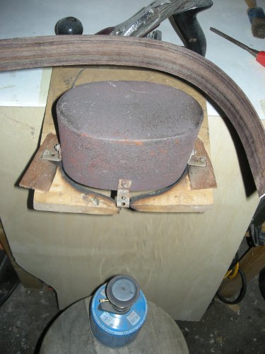

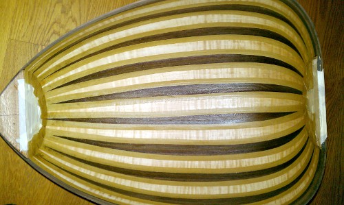

liner strips in between ribs
Thanks paolo, it is indeed a nice combination.
maker, I use Titebond glue.
Here is a picture showing how I bend (very traditional), and how I put the liner strips in between ribs., I first glue both sides of the ribs (not the strip) and startjoining them using the tape. it is an easy process, as long as the ribs are 100% flat to eachother.
bending.jpg - 50kB purfling.JPG - 48kB last ribs.JPG - 58kB
Best regards, Samir

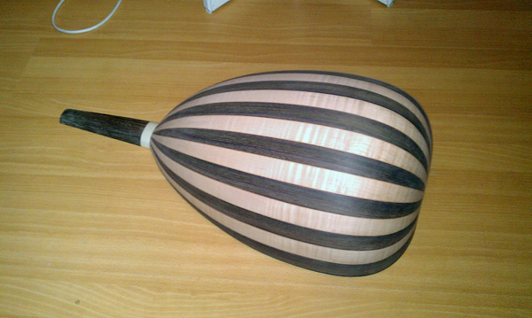

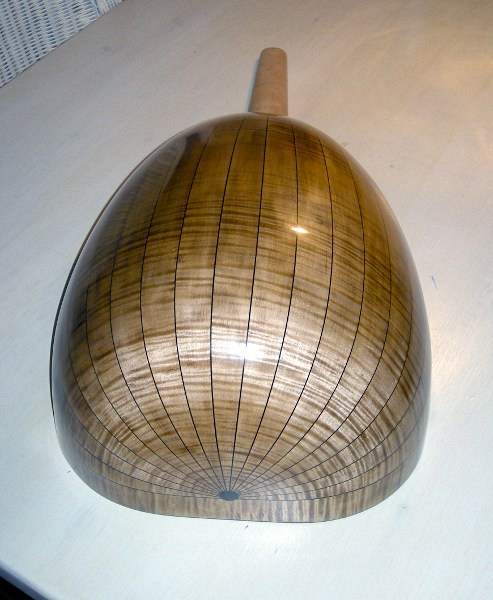

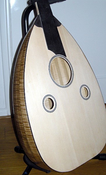

Flamed oud

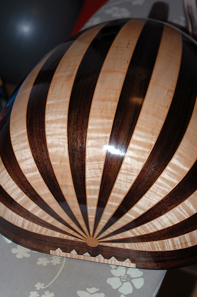

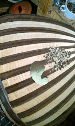

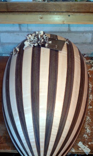

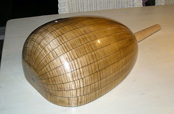

In between, I have cut the sound holes, mounted the soundboard and the neck for the flamed maple Oud.
scraping and sanding the flamed maple is difficult, but after couple of hours of intensive sanding up to 600 grid, the maple become very nice.
I have also appllied a combination of two light thin coats of stain . the wood came out beautiful (goldish), I have also applied some frensh polish.
The neck is also flamed maple....
flamed maple SOUND HOLE.JPG - 48kB flamed maple 3.JPG - 81kB flamed maple FRONT.JPG - 65kB flamed maple back.JPG - 75kB
flamed maple back 2.JPG - 69kB
Best regards, Samir

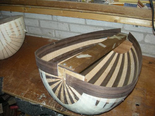

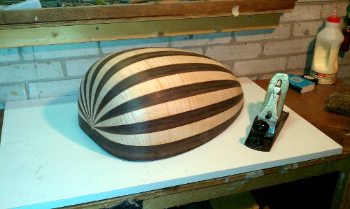

The bowl is now finished:
Some thoroughly scraping is done from the inside to remove any glue, bump or dirt.
a.jpg - 59kB
A circle is drawn inside the neck and the back and covered with tape. This is done to achieve a nice and clean paper strips ends when applying hot glue
b.jpg - 65kB
Paper stripes with hot glue to reinforce the ribs
c.jpg - 58kB
d.jpg - 61kB
After the hot glue is cured, the back is now scraped.
e.jpg - 56kB
The bowl is flattered to a flat board with a hand planner.
f.jpg - 53kB
Best regards, Samir

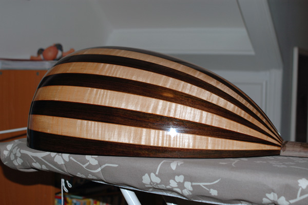

Hi Kelly,
Thank you. I always mount the bridge at end of the oud building process. it gives much more flexiblity, as the lenght, lining etc...I don't think mounting the bridge to soundboard before fitting to the bowl is good Idea. it need to be adjusted also to the fingerboard.
the neck is 19,5cm, which mean the strings lenght will be 3x19,5= 58,5 from bridge to nut.
Best regards, Samir

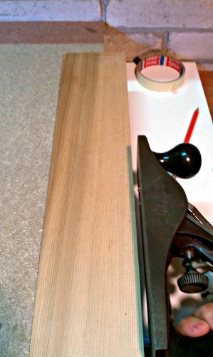

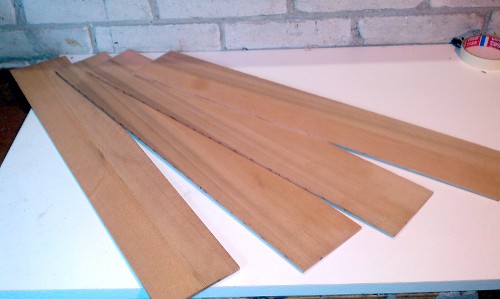

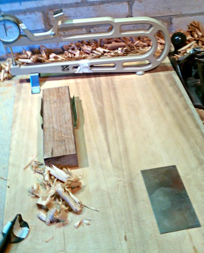

Soundboard
I have choosen for this project an aged peace of cedar wood. I have sawed 4 peaces (book matched) couple of years ago and stored them in a dark dry spot in the basement and hope this will be rewarded with a nice sound.
g.jpg - 37kB
The sides are planed flat with a planner until there is no light gap between the boards.
ha.jpg - 46kB
Joined together with Titebond glue.
h.jpg - 46kB

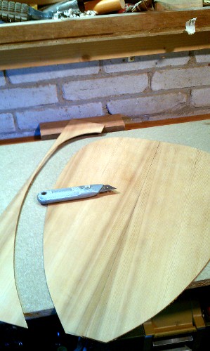

Planned, scraped and sanded down to 2.0mm.
i.jpg - 68kB
The soundboard is cut following the bolw shape
ja.jpg - 51kB

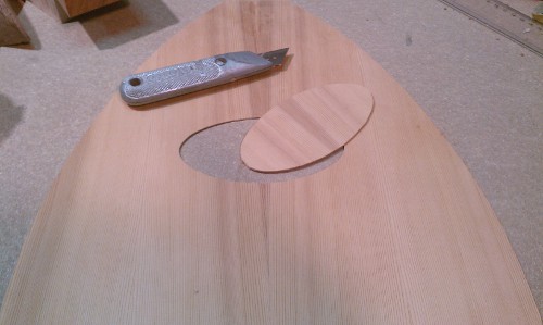

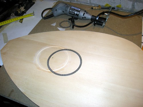

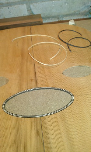

I have choosen an oval design for the holes with a (not fixed) bridge this time. this is my first mobile bridge by the way. the centre of the big oval is 19,5 cm away from the top of the soundboard.
k.jpg - 33kB
3 holes open.
ma.jpg - 48kB
the holes are rounded (decorated) with 5 lines strips: Tulip/ebony macassar wood tripes
m.jpg - 46kB

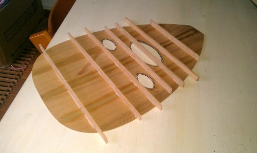

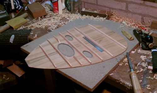

7 braces are also in place.
5mm thick 18mm high at first place(all of them)
n.jpg - 35kB
The braces are then lowered and shaped to a pyramid shape
from top to bottom:
13mm,15mm,15mm,16mm,13-14mm,16mm,13mm
and lowered at both ends to almost 5mm, 4-5cm away to the ends.
o.jpg - 53kB
Best regards, Samir

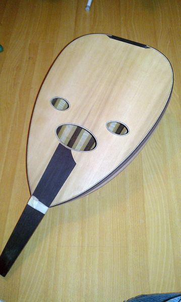

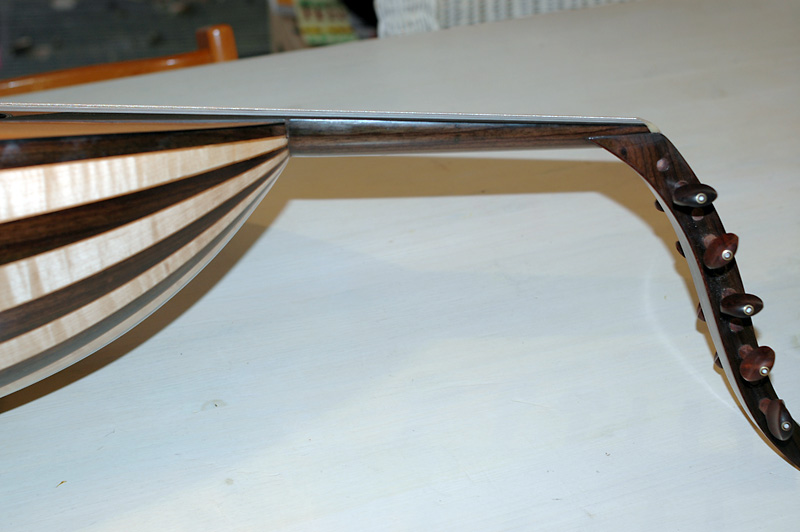

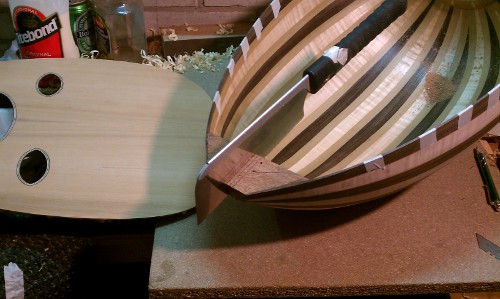

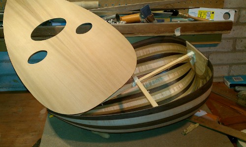

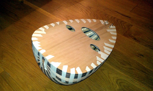

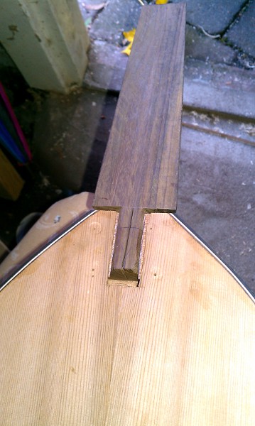

soundboard mounted

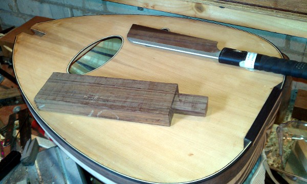

before the soundboard is mounted to the oud bowl, a dovetail opening is made to the neck. the outlines of that frame is projected to the neck with an exacto knife for later.
p.jpg - 53kB
the soundboard then mounted, everything need to be alligned, the braces need to fit exact inside, touching the bowl but not pushing it.
q.jpg - 69kB
the neck is then hand sawed to fit in the dovetail.
r.jpg - 71kB s.jpg - 70kB t.jpg - 61kB
Best regards, Samir

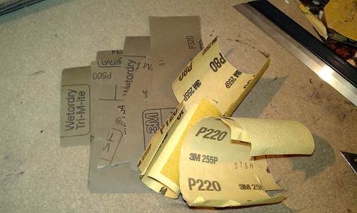

Sanding paper from 80 grid to 2000 grid.
IMAG0191.jpg - 90kB
After couple of hours of hand sanding the oud is ready to get the firt fillers and an oil coat:
the soundboard is also finished , 500 grid is fine enouph
the 800 and up to 2000 is for the bowl. but used later when using french polish.
IMAG0193.jpg - 109kB IMAG0194.jpg - 125kB

yes it is my first floating bridge. no major changes between this one and the fixed one. the braces are 1/2 mm thicker and the placement is to achieve less bass.
I started applying shellac and from time to time sand with 2000 grid and a filler. it's a real killer for smooth surface
DSC_9265.jpg - 157kB
Best regards, Samir

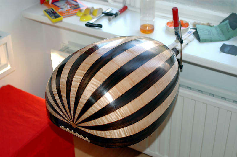

[*] posted on 11-16-2010 at 02:16 PM
shellac and pegbox
After a dozen of shellac coats, the bowl looks very nice. I will leave it to cure for 24 hours.
DSC_9279.jpg - 95kB
DSC_9277.jpg - 129kB

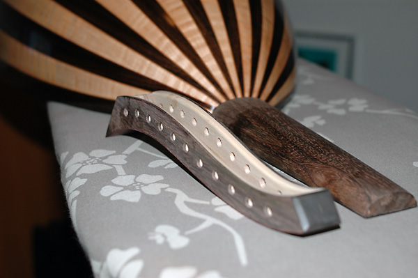

in the mean time, the pegbox is also ready.
DSC_9275.jpg - 89kB

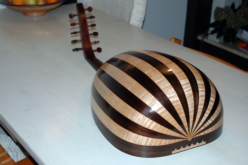

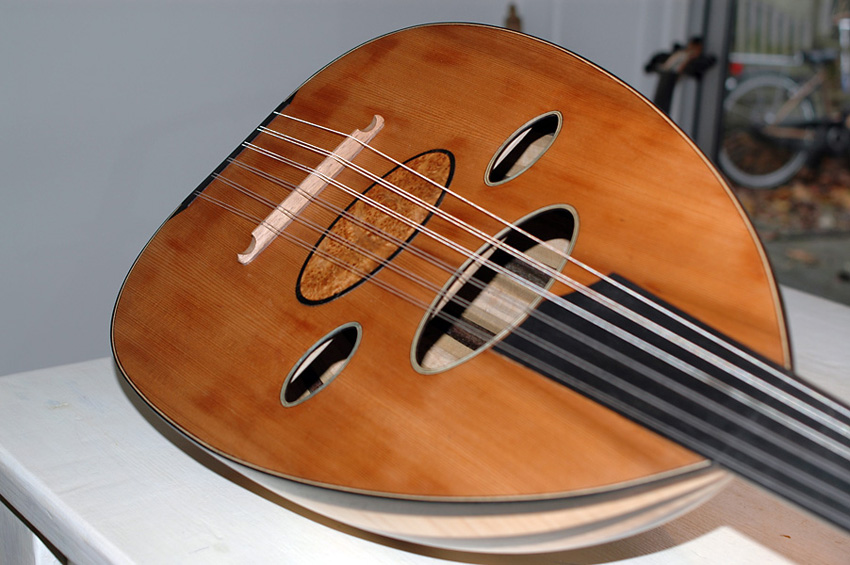

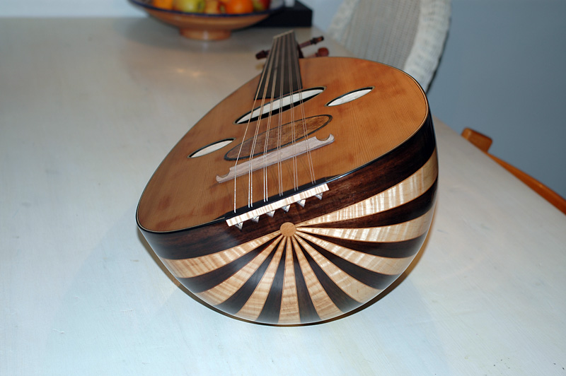

[*] posted on 11-19-2010 at 04:50 AM
END

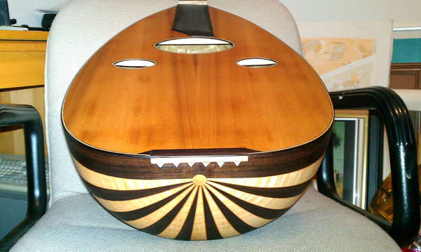

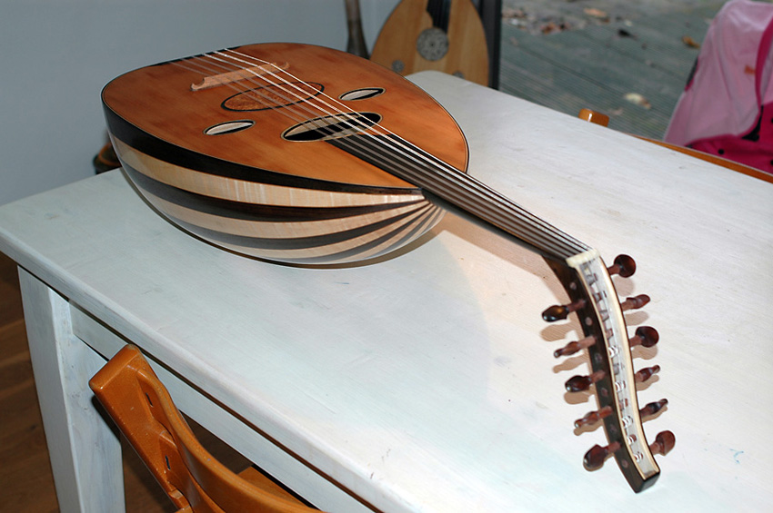

The oud is finished and strings are up. a sound sample will follow up sometime...but it is very promissing already
thanks everyone for following this project.
soon another one.
DSC_9308.jpg - 136kB DSC_9312.jpg - 116kB DSC_9328.jpg - 150kB
DSC_9316.jpg - 176kB DSC_9320.jpg - 182kB
Best regards, Samir
