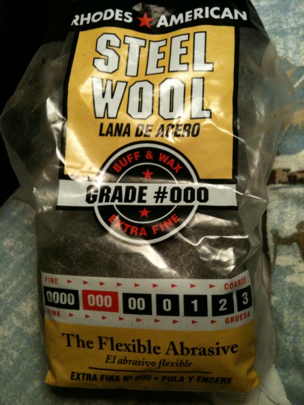

[*] posted on 3-9-2010 at 02:57 AM
Mehran,

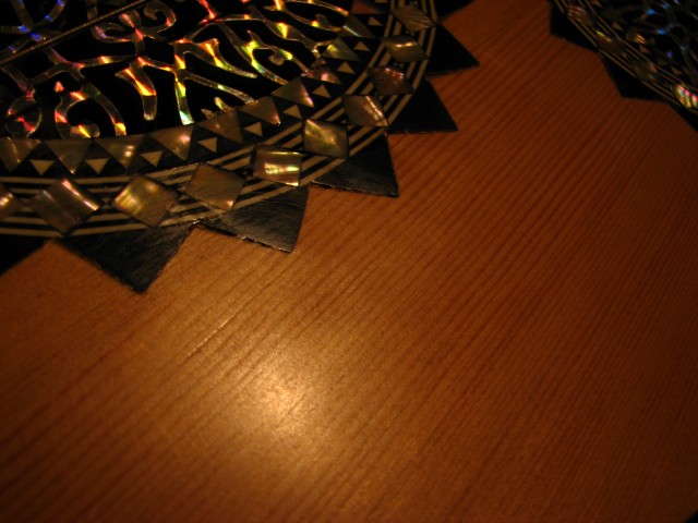

Here is the exact steel wool I used. I am familiar with several synthetic "plastic wools" and they are very different from metal, not recommended. Steel wool CUTS and does not abrade. It shaves off the peaks and leaves a semi-gloss surface. Just do it slowly and lightly with a circular motion, and you will discover the ideal pressure and motion to use. The hardest part was working around and into the "bays" of inlays.
I was about to embark on my own stripping odyssey when I read about this trick somewhere, and I was amazed at the simplicity of the method and the resulting look and feel. I wanted to show you, but it's hard to photograph. Below you can see the texture of a typical fugly raised-grain brushwork varnish from an e-bay wallbanger. Although the wood is different, that's about how the soundboard on my Egyptian was textured at first. On the next image you can next get a sense of how it turned out. It's better than I ever expected. I don't know if it works as well on all varnishes, and I certainly wish you the best results on yours.
SteelWool_photo.jpg - 149kB BadVarnish.jpg - 11kB Img_6897m.jpg - 67kB

[*] posted on 3-9-2010 at 03:38 AM
Cheers - From the photo the overall finish looks nice and even, the finish im looking for :-) .The finish being uneven and shiny is the main reason im thinking of this, if the sound opens up as well that would be an ultra bonus indeed.
