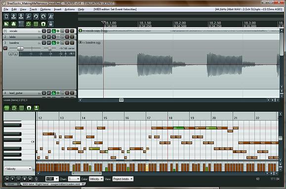

[*] posted on 4-17-2010 at 03:39 PM
Modern Digital Audio Workstations (DAW) can record sound data and MIDI on parallel tracks, like a multitrack tape recorder. MIDI is a recording of strokes that were played on a device like e.g. a drum pad with a MIDI connector, or a piano-like keyboard. An audio track that was played on an oud can play in sync with a drum track played by a virtual darbuka triggered by a MIDI keyboard or MIDI drum pads. The MIDI data is just "strokes", and the same MIDI data can play different sounds interchangeably. A pianist can play a synthesized french horn, etc.
There are string, wind, percussion and other instruments that output MIDI, and these are called MIDI controllers. Take a look at some of them:
http://keyboards-midi.musiciansfriend.com/midi/controllers
You can buy synthesizers, but why not let the powerful PC synthesize a bunch of synthesizers? Modern DAWs have "slots" that accept so-called VST virtual instruments that are programs that act as sound synthesizers, that will respond to MIDI that the DAW is playing, wherever it came from in the first place.
Finger pads are nice to play drum parts on:
http://keyboards-midi.musiciansfriend.com/product/Akai-Professional...
A good VST module will alter the sound in proportion to how strong the hit is on the MIDI controller, and there are ways to choose different drum strokes, etc.
With a collection of VST instruments entire arrangements can be played. A whole industry has developed around making the best simulated instruments. A typical piano, that is very hard to distinguish from a natural piano, might consist of 4 GB (!) of data that can be purchased for $200. This is much cheaper and takes up less space than the Steinway from which the sounds were sampled.
In addition VST modules include processing modules like echo, delay lines, filters, etc. Most of the commercial music we hear (good and bad) is recorded and edited on DAW systems, just as film and video are edited on worsktations.
Reaper, like any DAW, can be used with microphones as a high-power multi-track recorder without any use of MIDI or VST instruments. But the most important "processors", like filters, reverb etc. come in VST format as well.
Reaper has many of the features of the best commercial DAWs, and is worth exploring at no charge. People who are intrigued by this concept should look on Youtube by searching on MIDI, DAW, VST, Reaper Tutorial, and so on.
What Chris was saying is that (if you are interested) many virtual instruments and processors that are in VST format can be downloaded for free and tried out. They need to have their .DLL code modules in a common folder that the DAW program can find, the folder being usually called VSTPlugins. So activating or inactivating a specific VST is usually as simple as moving the VST's DLL in and out of that folder. Very handy for testing which %$#@%* module is crashing your DAW.
Virtual instruments/processors come in different formats. The VST standard is very popular. Those that are in DirectX or other formats don't work that way and have to be installed so their location is placed into the operating system's registry.
To illustrate the concept, the image shows a project in Reaper stopped at measure 18, with an audio track open above showing waveform of the bass line, displayed like an oscilloscope trace, and a MIDI track open below showing MIDI notes as little rectangles, with pitch vertically and duration horizontally.
ReaperAudMidi.jpg - 55kB

[*] posted on 4-17-2010 at 11:35 PM
MIDI is a recording of strokes ...
Thanks for your detailed explanations, Tony. I forgot, that many beginners might not know what the concept of MIDI is.
Quote:
The MIDI data is just "strokes", ...
And that's why it's easy to edit this data in Reaper. Imagine you played a MIDI track by keyboard and it is fine except one note being hit too late ... no problem, you open the midi editor and correct it with one or two clicks with your mouse. But you can also edit the notes if you have hit the wong one (maybe C instead of D) or the volume of the notes. Theoretically you can even compose a whole track in the MIDI editor, for example if your composition is more complicated as your fingers are able to play on the keyboard.
Right, but besides that, many high end VSTi are available free.
AND ... Reaper also has a plugin, that enables you to use your own samples.
Image you take a glass of water and hit it slightly with a tuning fork to tune it to A by filling in the needed water level. Then you record this "pling" with a microphone and use this short recording as a virtual instrument in Reaper. Then you can play melodies with this sound and have some kind of strange xylophone.
These are called VST (virtual studio technology), while virtual instruments are called VSTi.
Yes, while Photoshop is the tool for photographers, DAWs are the tools of sound/music engineers.
Such crashes occur, if a VST is buggy, which is seldom. But each VST needs processor time and RAM, so if you use more VSTs than your PC performance can process simultaniously, the DAW software encounters problems ... usually the sound stutters or the DAW might even crash/freeze. A common problem with ressource intensive free VSTs is, that you encounter performance problems, when you use the same VST on several tracks. I have a fantastic grand piano VSTi, that works like a charm as long as I only use it on one track. If I use it on two, they sound begins to stutter.
This all is the reason, why often it is recommended to use a high end PC as a DAW. But even with my old notebook I am able to process a minimum of 10 tracks as long as the VSTs are good.
But I think most oud players will use less tracks ... maybe 1 or max. 3 ouds and maybe the same amount of percussion tracks, so Reaper should work like a charm even if your PC isn't the newest model.

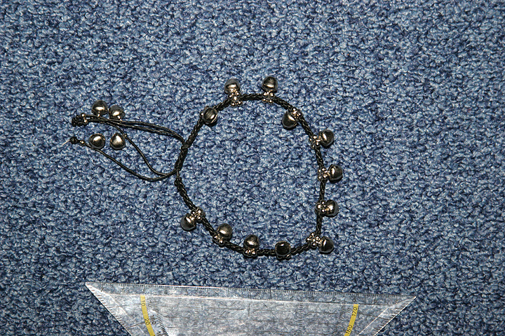

at the weekend we visited a medieval market, where I found a nice wristband with small bells and I thought, it might be a nice percussion instrument.
And, yes it is ... listen yourself ... I created a short beat with virtual tablas and the recorded bells and put a slight stereo effect on the bells (the tablas are mono so far). No further effects used.
This should give you a first impression of the sound quality of the above mentioned equipment. If you have good ears and audio equipment, you might notice a slight humming noise on the bells track ... the microphone was placed too close to my notebook.
bells.jpg - 332kB
Attachment: Tabla-Beat.mp3 (631kB)
This file has been downloaded 293 times
Stay tuned ... oud recordings will follow soon ... it's not easy recording with microphone in my house ... too often noise ... grrr.
PS: The MP3 is in 320 kbps for best audio quality.
