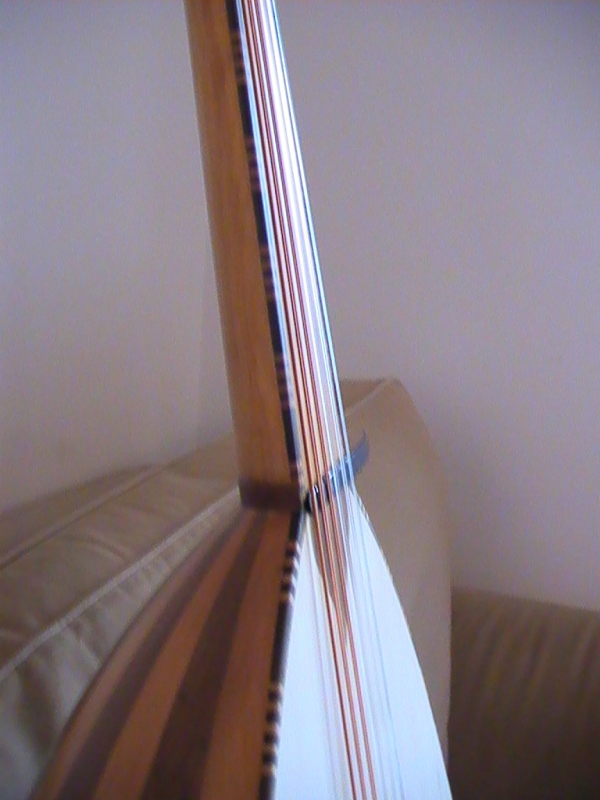

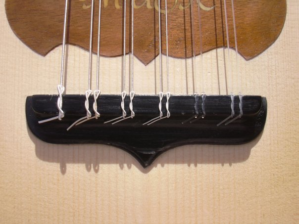

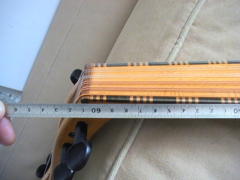

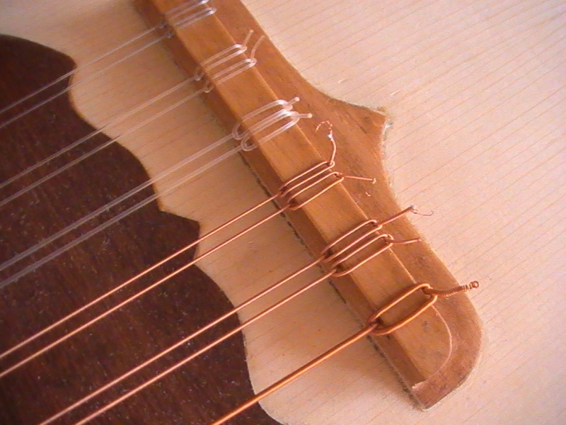

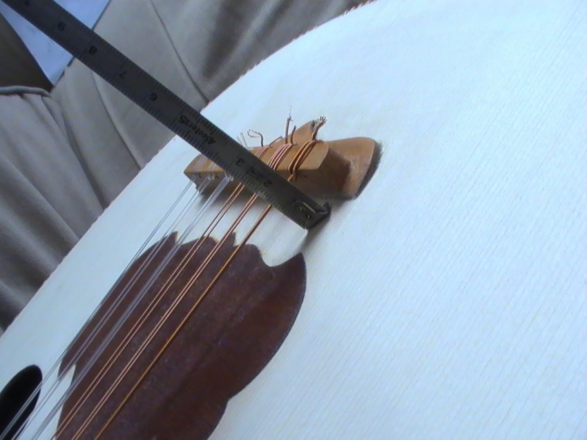

I have a small distance beteen the strings and the neck; may be 1 mm ( I was with 1 cm with the other oud)
see the photo: the risha did not fall...
the distance between the bridge ( inside) to the nut is shown...
PIC_0436.JPG - 189kB
PIC_0452.JPG - 191kB

Quote: Originally posted by mrkmni
I have a small distance beteen the strings and the neck; may be 1 mm ...
At the neck-body-junction, where you placed the risha in the photo?
If yes, than this is most likely the reason ... 1mm is too low ... try 2mm. Most people use 2.5-3mm to avoid buzzing.
I have 3mm on my oud, but would prefer 2mm. Too bad I can't ajust it as you.

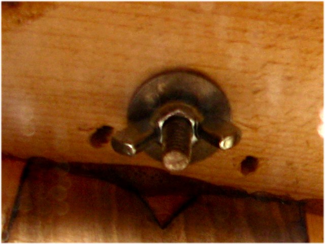

how to high the strings 1 mm?

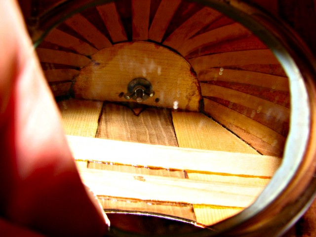

With the neck screw inside the bowl ... read FernandRaynaud's explanations above.

Iteresting discovery.. did not know about this before, and I am not sure I have on in my oud..
I will check; I need to remove the strings and get in my hand right?
Iteresting discovery...
Yes, that's one of the greatest advantages of sukar ouds.
It might be enough to loosen them ... check Fernand's explanations or ask him for further details ... he has the same oud ;)

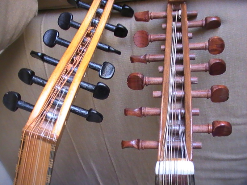

The factory strings are so bad you can't tell anything until you get some real strings on it.
Yes ! Change the strings !
Even with good brand new strings my Sukar buzzes. It needs a few days before it fits correctly. Also, always keep the butterfly nut screwed (better for the health of your oud).
At last, try the way I tie the strings, it will stop untimely buzzes (when it's a mess in the peg box or when the dead part of the strings on the bridge are too long)...
6090_1146227826731_1558601928_347687_4602541_n.jpg - 52kB 6090_1146227786730_1558601928_347686_6845486_n.jpg - 49kB

You should shorten the length of your strings, I see way to much enrolled all over the peg, it can give you headache for tuning.

Quote: Originally posted by Manil
David,
Yes, these photos are a bit old... Now I use Daniel Mari and the length is perfect ! Except for the CC which is a bit short.

I just unscrewed the butterfly, it was easy task, I can do it without loosening any string, it is amazing. I red a notice of the maker about this tip, i could not understand eventhough I read arabic well...
I loosened the butterfly , I could get only may be 2.3 mm , maybe with time it will bend because the oud spent almost 2 years untuned...

It's strange that you cannot get more than 2.3mm height at the place where the neck and body meet. Of course if you had 1 mm it would buzz!
The neck will not bend. But if you gently pull the neck forward as you loosen the butterfly nut, it may settle a little higher. Don't leave the butterfly nut completely loose, the neck could take an unhealthy turn ;-) you should tighten until you feel it is pulling the neck, then pull gently on the neck and turn Back and forth, and feel the nut work against the pull of the strings, and tighten again and loosen again. You will start to feel it better. You want to leave it just a little looser than when it is pulling the neck down. You can gradually develop the feeling. Normally you should be able to get 1.5 mm to 5 mm string height adjustment exactly where your risha was not falling. 1.5 mm is buzzy, 5 mm is hard to play on.

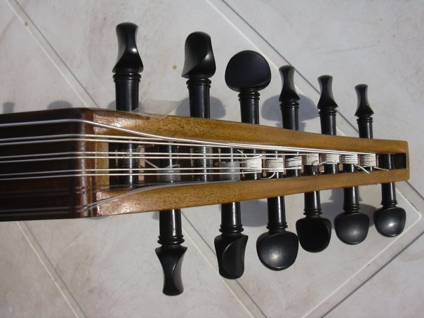

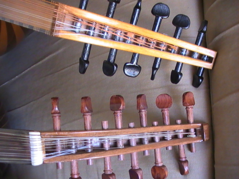

OK this is my peg box with black pegs ( in the photos)
I am going to buy Mari strings with ff.
Dear Fernand, enjoy your trip in Central America...did you bring a oud with you?
PIC_0455.JPG - 186kB
PIC_0456.JPG - 206kB

Hey Tony, I can't understand your whole post (no time to check a dictionary) but Houzam and Sikah are very painful for western ears ;)
mrkmni, when you cross the strings in the pegbox it might buzz...
