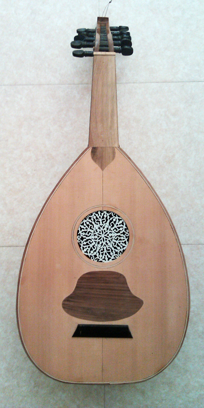

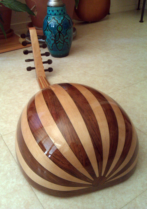

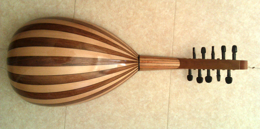

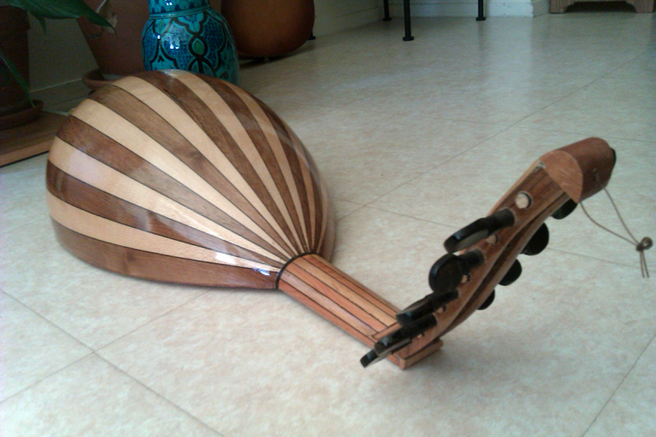

Small Oud 44,7 cm scale
Hello !
Hope you are all fine.
I want to present you my small oud, 447 mm scale.
First, is it a oud ? It have 5 double strings.
Buy it 51 euros on ebay. I love the wood grain of the bowll, I don't know what wood it's made of.
The pictures know, and other questions after that.

As I understand, it's not a barbat, the scale is too short. It may be a children oud.
I tryed pyramid string, this set : http://www.pick-et-boch.com/produit.php?prodid=930&bd=Jeu+de+co...
I know now that they are not good for this scale.
So, do I have to buy personalised set from the manufacturer for this scale ?
Nobody have a oud with this scale ?
Thanks for your info.
