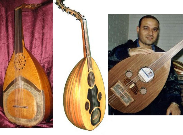

Maurice Shahatah had once built a breed of wood & leather soundboard, situating the leather patch underneath the fixed bridge, but he never
repeated this, as far as I could detect !

The wooden plate probably makes the skin not sink too much and helps with the sound. That's why it sounds like an oud and not a robab. I put up a
picture here too. The first one is Iranian made, the second one is from an encylopedia or instruments from Azerbaijan and the last one is Maurice
Shehata's that was mentioned before.

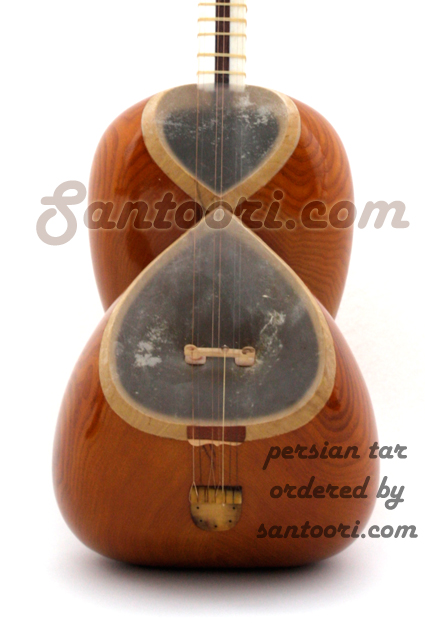

Another thing to consider is the thickness of the skin. Iranian tar uses lambs skin that is gently stretched over the two bowls. The bridge is
floating on the skin, but it stretches it quite a bit. This material is very light, has almost no perceivable grain, and is similar to some fish
skins used in riqs and percussion. On the other hand, the aforementioned Oud appears to have a rather thick goat skin. Also, I know that the
shourangiz (see Hossein Alizadeh) uses the same thick skin as in the tonbak drum, made from camel.
