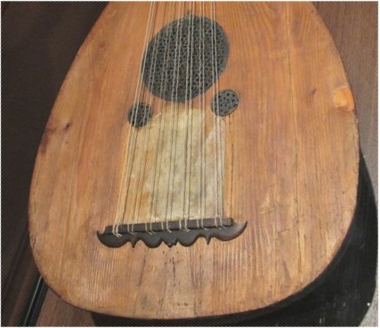

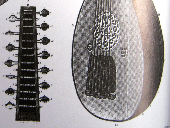

There is an engraving of a 7 course oud in Napoleon Bonaparte's 'Description de l'Egypte' that appears to be almost identical to the old (late 18th
C?) 7 course oud Cat. #0164 in the Brussels Musical Instrument Museum. This surviving example has 7 double courses and has a geometry that is very
similar to that of the traditional Turkish oud.
Note also that the oud drawn in 'Description de l'Egypte' is described as an instrument known in Egypt but not of Egyptian origin.
Also the engraver has only represented single strings whereas the engraving of the peg box confirms that 7 double courses were fitted.
