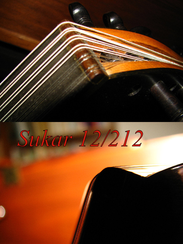

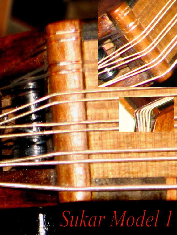

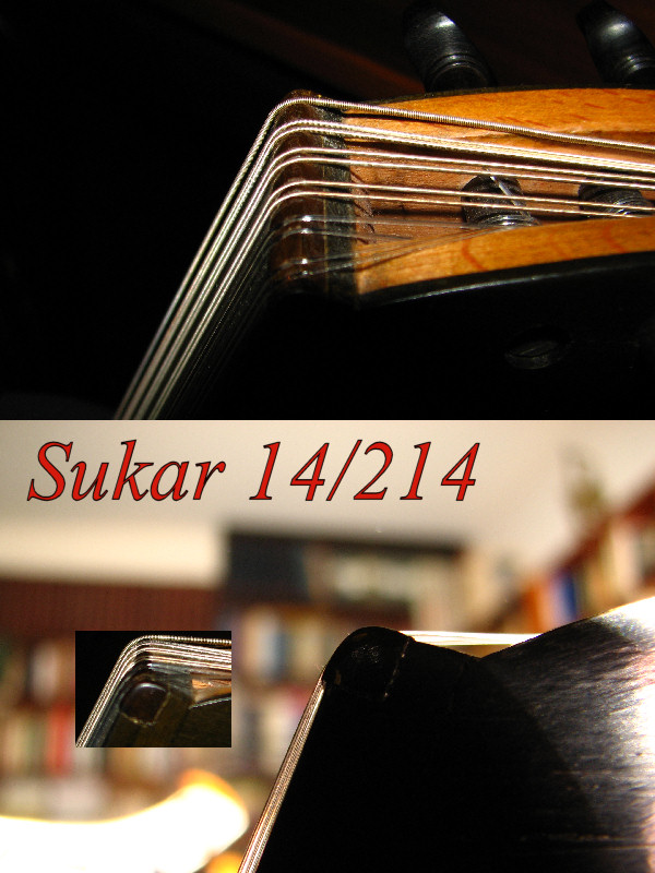

Can you post pictures of :
-the strings in the pegbox
-the nut
-the bridge
it will help to clarify your problems
Dan

Your pictures are too small
Seriously, you should first cut the string ends at the bridge, they are far too long.
If the buzz persists, you can do the same in the pegbox (it's not clear from your picture that something is wrong up there).
Sometimes also the buzz comes from bass string between the nut and the peg, you could put a small piece of tissue between the string and the pegbox
side.
The nut seems ok.
If all this does not work, where does the buzz seem to come from, is it high or low frequency, is it only for open strings ?
Dan
I'm not crazy about the look of that nut. It's not a very "typical" Sukar job. We all know that there's no such thing as standard anything in the oud
world, but I've seen a number of Sukars, and have never seen a nut fitted like this (see images below). The REAL question is how well it works. You
don't say whether the buzzing is on open strings or fingered or both, what happens if you mute which courses, and then if you mute individual strings.
There are so many possible sources, including the soundboard bracing and the pegbox. You need to more fully analyze and describe your buzzing.
As to the bridge, the second string on the second course should be redone, you can't have true intonation that way. Your loops on the wound strings
aren't great either. Ideally a string should be hanging from the edge of the bridge on a single loop, and there shouldn't be any twists below the edge
of the bridge, as that throws off the intonation and could buzz.
The neck block wingnut provides a narrow range of adjustment. It's not like a Fadi Matta. If you are unable to get ANY change in the height of the
action between when the nut engages and when it bottoms out, something is wrong.
It's not impossible for a "problem oud" to be sold. It's not even a question of honesty, the Palmyrami people have zero understanding of musical
instruments, they sell pretty wooden things, and you have purchased one. Since your oud seems to have all the right wooden elements, it's likely it
can be made to work.
Hopefully you can find someone local who has worked on ouds or lutes. A guitar tech knows about the bridge, soundboard and bracing; a violin guy knows
about the neck and pegs, but nothing about a braced soundboard.
p.s. your wide images are throwing the whole forum formatting off, you might want to use the standard attachment technique.

Thanks to everyone who has responded. I've halved the images so they are still big enough to examine but don't jack up the forum.
I did all of the stringing myself, and it was my first attempt at stringing an oud. I definitely need to re-do it. If there are any good guides out
there on HOW to string one, I'd love to see it. I tried searching around, but unfortunately my Arabic is college-level, and Fusha to boot.
I agree completely about the look of the nut. It looks like a shoddy job; I can see the glue and it just doesn't look right at all. The person in
the violin shop says he's dealt with ouds before and he sounds like it's familiar to him, so I really don't have much of a choice there since nobody
else in the Kansas City area seems to deal with ouds.
I haven't localized the buzzing yet. I can tell that some courses, particularly the lower ones, seem to be buzzing against each other rather than the
neck and the bridge. The intonation of the higher courses gets a little flimsy when I reach the higher part of the neck, but that really could be due
to the poor stringing job I've done. Open strings tend to buzz near the head, though, because that action is really insanely low. My paper-thin
risha barely fits underneath them at the very top near the nut.
So, yes, I have some more analysis to do. Obviously this is not a fake as I feared (I jumped to a conclusion based on my lack of knowledge about how
the oud works, but I'm learning).

That's a heck of a lot of great information, fernand! Thanks!
And thanks for the stringing thread. That'll help a lot when I gather up the patience to remove and reset these ones.
from looking at your pictues I can give you a couple of pointers for stringing.
1- That is way to much string wound on your pegs. You want about 5 turns on the nylons and 3-4 turns on the wound strings. The strings should be tight
against eachother and never overlap. use a little cofee stir stick or even a risha you dont care for to assist you as you wind the strings.
2- Try to look at the hole in the peg and determine which side of the peg box it is closer to, wound the strings towards the side of the hole that has
more space before it hits the pegbox wall. I always try to wound the strings towards the thick end of the peg because I find it holds better.
3- The strings should be as straight as possible from the peg to the nut, try to avoid angling the strings to much but especially try to avoid strings
from crossing over eachother in and resting on eachother in the pegbox. This will create buzzing in the pegbox.
4- The loops on the bridge are at different length, that is going to mess up your tuning which is compounded the more you play down the neck. I am
especially talking about that nylon G-String at the bridge.
5- If you dont want to change the nut, I sugest rubbing the head of a pencill in the groves of the nut. You can then use a wound string to polish the
grove, like agressive flossing it will make your wood nut perform much better.
6- the main issue I see with your nut is that it is too low. This will create open string buzzing at the fingerboard. The best remedy for this is to
take an discarded peice of the C-String and cut it the with of the fingerboard at the nut. Slide that nylon string under the strings with the help of
a business card or a reesha all the way up to the nut. This will make tuning easier since it creates an even resting point for all the strings.
after you do this and you still have buzzing, the action may be too low or you may have a loose brace.
What Samir is suggesting if your nut is indeed too low, which I can't tell from the photo but maybe he can, is to create a sort of pseudo-nut with a
piece of the thinnest (c) string. That would be something like 0.020 - 0.025", so it would set the nut side action to that height, which is pretty
high for my taste, but it won't buzz for sure.

Yo, Novice! I tried Samir's suggestion of jamming a piece of thin string up against the nut, and it's a very VERY useful tip. For one thing,
diagnostically it's very helpful, you can isolate some buzzes. It's also a great fix for a low nut, which otherwise would have to be shimmed. This
doesn't even require loosening the strings. Great tip, Samir.
Now, being the compulsive that I am, here's the issue I see with using it as a permanent solution. The timbre of the oud results from many factors,
one of which is the height of the action. If you like the very "Egyptian" sound, you want a rather high action so the notes are very distinct and
percussive. If you like a slightly Turkish flavor, you want the action dangerously low so you get some sizzle and what on a fretless bass they call
"mwah", both of which result from borderline buzz. What some people might hear as a slight but annoying noise, a Turkish oudie considers heavenly.
That's also helpful in shopping for an oud, if you hate high actions, to know that a Turkish oud will generally have a lower action.
The open strings are used a lot on the oud, so the sound of the action at the nut is heard a lot. It has to match. If you raise it with a piece of
nylon string, it should match the effective action further down the fingerboard, or you will have a different timbre on open and fingered strings.
With say a 2.5 mm action at the neck-body junction, you need a very low action at the nut to duplicate the same zingy timbre you get when fingering.
And that works out to something like the business card thickness I was mentioning. I found a 0.015" high ff "mumtaz" nylon and that worked. For a more
"Egyptian" timbre, with say a 3.5-4.0 mm action at the neck-body junction, a piece of typical 0.022-0.025" cc nylon string is more appropriate. So
there.
