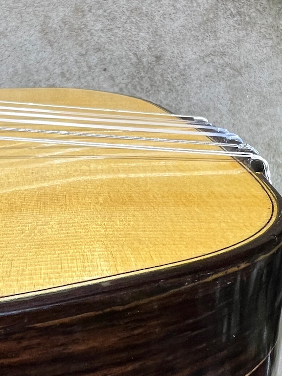

The final example, at this time is this. Here the string is attached through a special loop (the string goes first over the endpiece, then under and up in it, and over the string and back down). I do not know how its made. It seems, that the string is somehow inserted into the hole twice, but I cannot understand how it is made possible with the wounded strings due to their thickness. Any clues? As far as I have found out, this idea comes from saz-strings, but they are much thinner and have an end-loop where strings go through.
(Source: Instagram Hafezalsleman)

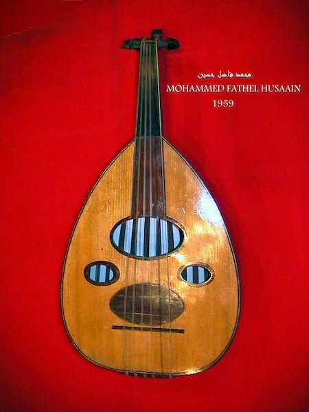

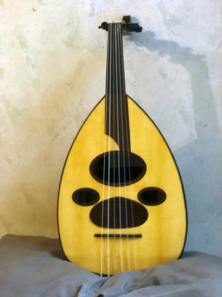

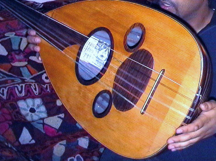

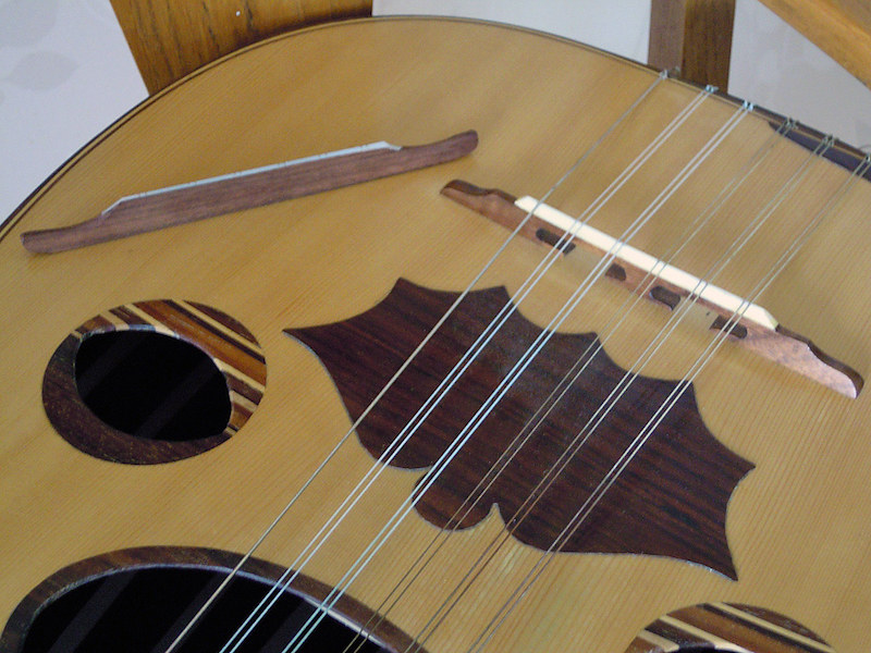

The oud that Fadel built for Munir Bashir is influenced by the classical ¨Mandolino Napoletano¨ with its slightly bent soundboard that handles the string tension with its floating bridge.
Many ouds today built with this concept ¨floating bridge¨ are reinforced much more than what Fadel did in 1957.
What one can note is that the majority of newer oud builders do not understand the benefit of the bent soundboard.
I myself have had several floating bridge ouds more or less well and some that can not handle the string tension and the soundboard collapses under the pressure.
How the strings are attached is called ¨cordiera¨ in Mandolino Napoletano in english called ¨tail piece¨. This part performs no more function than fixing the strings. Of course, you can discuss more about the bridge whether it should be in solid wood or with an edge made of bone.
I attach couple of pictures one of a oud by Munshed owned by me with a bridge designed by Dr Oud. Also a picture of my new oud I ordered this year following the concept used by Fadel when he built the oud for Bashir in 1957. This maker is a professional luthier in Hungary.
259725865_4627730783963241_2081743745163452878_n.jpg - 389kB IMG_0954.jpg - 137kB

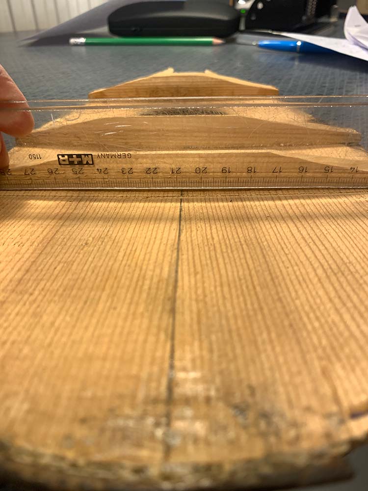

Thanks, Ronny, for the comments and pictures! Most interesting regarding the necessity of a bent soundboard. That reminded me of a repair project I had some time ago of specifically a Napolitan mandolin. Here are some pictures of the backside of the soundboard and the slope. The soundboard is bent twice: in a curve over the brace, and sloping after the last brace. In order to achieve this latter slope, the soundboard is cut halfway through. This cut is not visible on the outside. Are the same methods used for a floating bridge oud?
The last picture is of the repaired mandolin where the sloping soundboard is visible. The endpiece is in steel, as custom here.
Does anyone else have pictures of different tailpieces? I guess that is better than endpiece? Does anyone know what it is called in arabic?

There seem to be few of his ouds with this typical ¨cut¨ made by Fadel. The majority of his floating bridge ouds are without this typical detail and he seems to have abandoned this quite early and instead changed the string action and the angle of the bowl.
Can not answer with its pros and cons but definitely the sound in these ouds is easy to identify. A friend owns an original Fadel Bashir model from 1983 and differs from in string action and the angle of the bowl/soundboard.
My new oud Bashir model made in Hungary sounds very good and I have always used the A415 when the majority of older instruments sounds much better than then in modern pitch.
That Bashir had problems with the bridge on his traditional oud is due to humidity and hide glue that was used.
This reminds me of the sensitive Renaissance lutes of the past that had a limited lifespan.

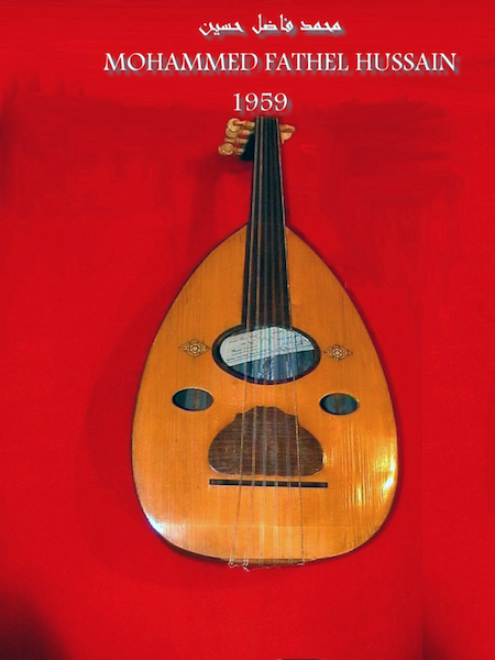

First picture Bashir original -57. The one from -59 without the ¨cut¨.
Picture 023.jpg - 441kB
imga0069.jpg - 237kB
