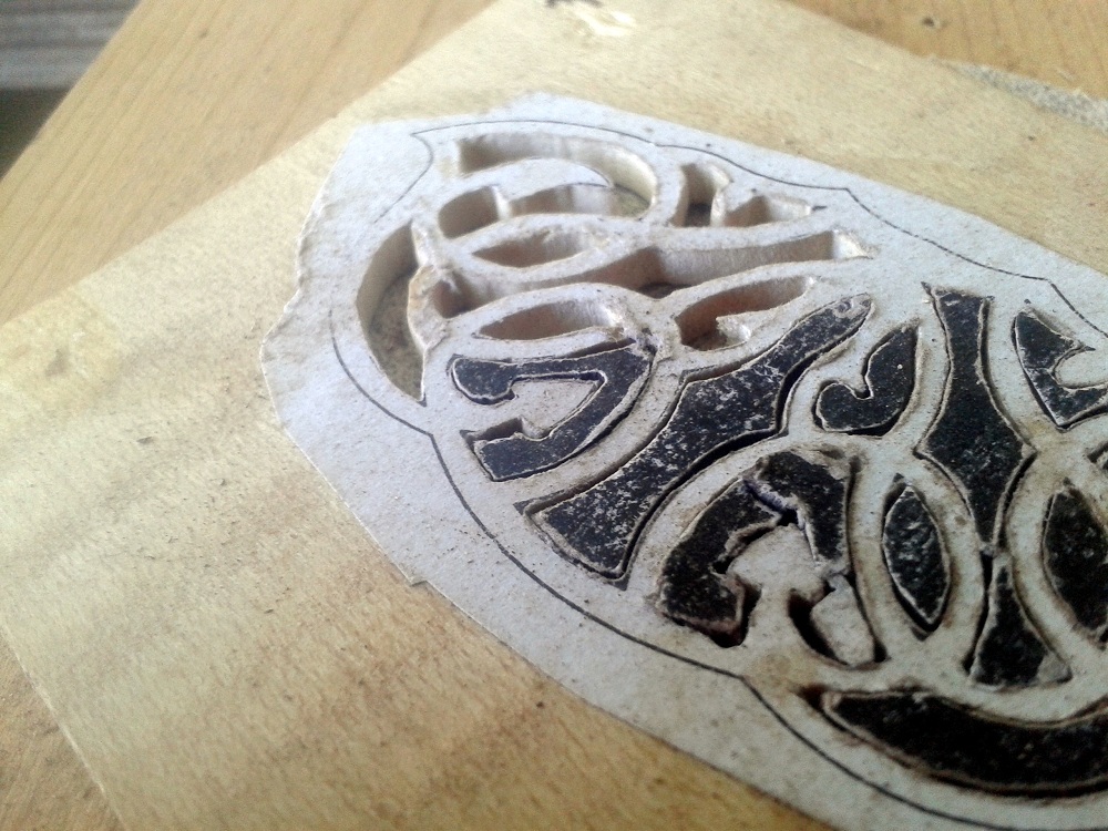

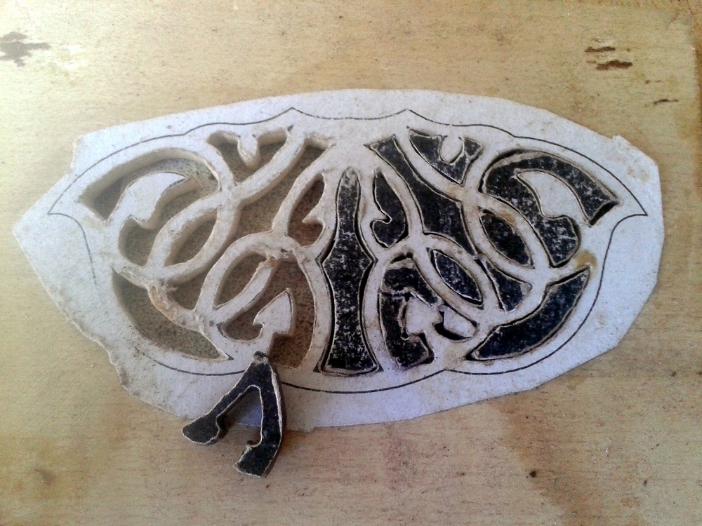

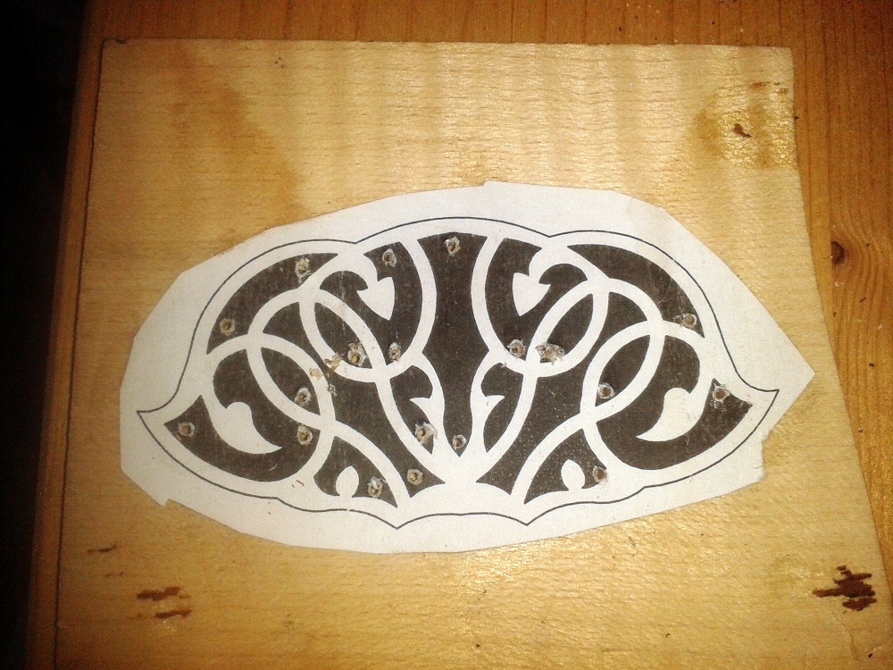

Meanwhile, I am preparing a decoration to the bottom of the bowl to
cover imperfections of the arrivals of the ribs.
some image. I have yet to perfect the lines with a scalpel and fill in the gaps of the design with glue and dust rosewood!
I took it from the drawing images from the internet. I hope the author of the design hasn't a problem.
2015-05-02 16.20.49.jpg - 272kB 2015-05-02 11.12.22.jpg - 303kB

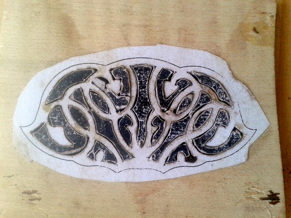

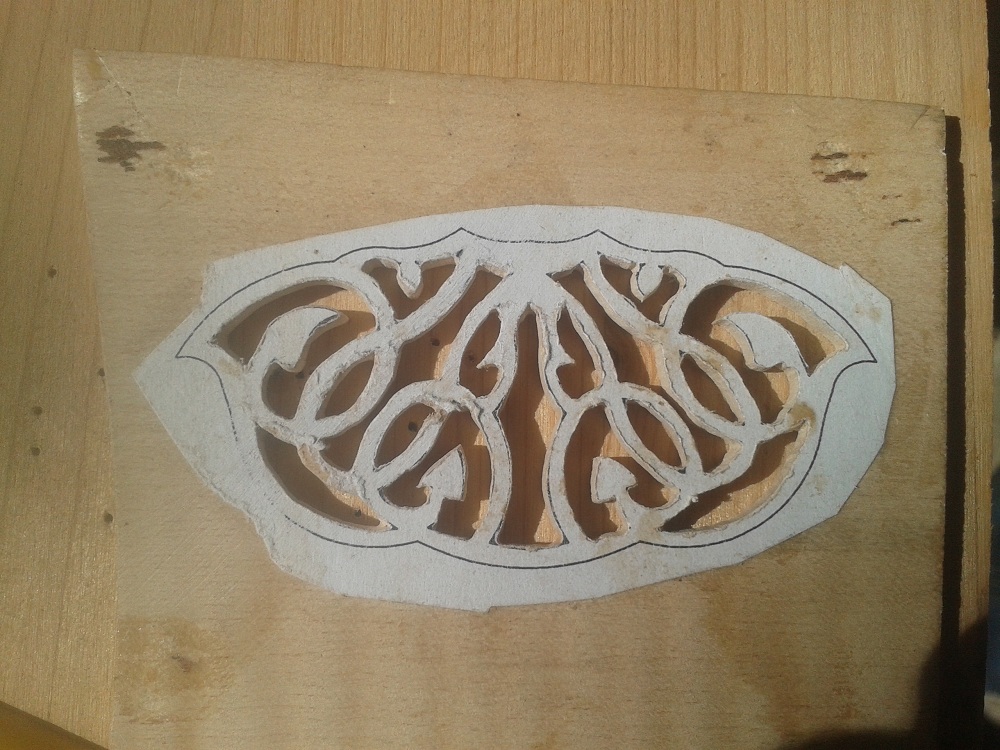

faggiuols - 5-4-2015 at 12:10 AM
some other image
2015-05-03 11.20.22.jpg - 292kB 2015-05-03 11.20.22.jpg - 292kB 2015-05-03 11.17.23.jpg - 303kB
faggiuols - 5-4-2015 at 12:12 AM
the end... (front and back)
the technique is correct?
thank you all!
