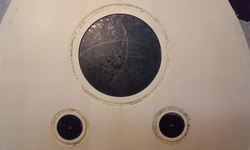

faggiuols - 11-3-2015 at 09:22 AM
here is a picture of the inlay of the holes.
I proceeded to a grouting to try to correct, but the result is still poor ..
I hope to make beautiful rosettes to look away from mistakes.
tomorrow maybe I post a picture sharper.
the small holes are still to be cut, will be larger. large hole instead is only to be finished.
thank you!
jdowning - 11-3-2015 at 12:22 PM
Do not make the sound board too thin at this stage as you can always remove some material later but you cannot put it back on!
The chosen optimum thickness depends to some extent on the properties of the wood as it affects the stiffness of the sound board - thicker = stiffer all else being equal. So in general a softer sound board in say cedar would be made a bit thicker than one of spruce, however, due to the range of densities for each wood species (denser = harder) there could be some overlap of properties between wood species. Also the quality of the soundboard - exactly quarter sawn, no spiral grain etc - are all factors that can significantly affect sound board stiffness and 'acoustic goodness'.
Usually the sound board will be made a bit thinner around the edges and with inlay banding to introduce a deliberate slight weakness at the edges to help sound board vibration.
This - together with sound board bracing - is all in the realm of luthier 'black magic'. There are no hard and fast rules to guide you only experience in building instruments! So just play it safe, follow an established bracing layout, construct as precisely as you can with minimal forcing of fit of components and you will be pleased with the result.
The sound hole inlays look fine for a first attempt - better than some I have seen coming from small commercial shops.

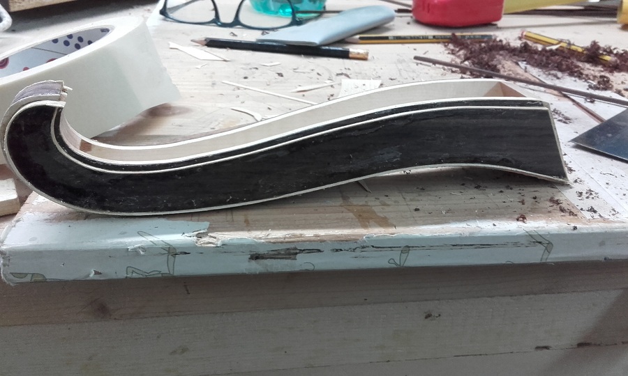

faggiuols - 1-25-2016 at 01:41 AM
Hello everyone
a little update on my slow work.
I am realizing the covering of neck with maple wood. Small splints because the single piece I can not bend it (unique piece was in my original plan).
I'm deciding whether to insert the inlay of rosewood between a cue and the other or leave it white.
If someone wants to say their opinion is always well accepted.
the next update.

faggiuols - 1-27-2016 at 01:41 AM
thanks David
a nice answer .., I would greatly appreciate your words.
I do not have to sell this oud, it will be "my" oud!
actually, after this remark on the color of the neck, my idea of the colors of the oud was broken, and I no longer very safe.
I enclose below the images of how it should be, the veneer is also given by poor technical capacity, in fact I preferred all white, but I can not get over the good bonding between the pieces. for this reason I prefer to put the thread of rosewood.
Certainly I follow my heart as soon as this has stabilized again.
I hope to soon overcome this uncertainty
Thanks so much, David.
[file]38006[/file] [file]38002[/file] [file]38004[/file]
jdowning - 1-27-2016 at 04:34 AM
Nicely done faggiuols! Neat workmanship.
The built up veneer blank is quite thick (that you will be trimming down to finished size once glued in place) so your decision to use black strips in the joints is a wise one. The use of contrasting woods in this way was often employed by some of the finest luthiers in history where the joining of wood segments (such as non symmetrical lute ribs) was a bit complicated. The contrasting woods (dark against white) disguise any slight discrepancies in the joints so they will never be noticed.
As for appearances the choice is entirely yours. It looks just fine to me. I have made instruments with light coloured, dark veneered and black stained or painted necks - all techniques found in historical instruments. A black neck is often preferred only because it is less likely to show marks in use - that is all.
If you are planning to add a traditional 'bracelet' strip covering the neck joint this will be a natural break in the continuity between the ends of the bowl ribs and the neck veneer and will also cover any slight discrepancies that may be visible in the neck joint itself.
Varnishing (a penetrating finish gunstock such as Truoil) will protect against staining of the white wood in use and will bring out its natural grain figure as an additional decorative feature.
Good progress.
faggiuols - 1-28-2016 at 12:44 AM
Thanks mr. Jdowming
for your words .. I feel much better!
I needed solace.
naturally I will put the bracelet between the neck and the bowl. I think it will be in continuity with ebony for the keyboard also made of ebony. also off well with rosewood with maple.
The pegbox is maple interior and exterior rosewood and, if I can, I would put the wires maple on the outside .. this will update my thread later.
thanks for the appreciation for my work too!

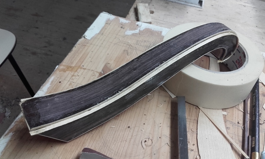

faggiuols - 2-1-2016 at 01:05 AM
I think you needed more clamps and rubber tubing for gluing the strips. :rolleyes:
thanks Samir
for your advice ..
I glued the veneer and I think came pretty well.
I also got a first cleaning the neck and it seems to me that it came good. I attach some pictures of the work. I would be happy if you tell me what you think!
if I could do the job again, maybe I would do the slats of maple much tighter. seem disproportionate to the ribs of the bowl .. what do you think too?
[file]38051[/file] [file]38053[/file]

SamirCanada - 2-1-2016 at 06:31 AM
it came out looking excellent! I was just joking my friend. The amount of tubing on that thing it wasn't moving even if you had a tornado come through your house.

faggiuols - 4-11-2016 at 08:01 AM
The pegbox takes its form!
faggiuols - 5-16-2016 at 07:29 AM
hi at all.
an update on my work, as usual, is going slowly.
I'm doing the pegbox and am entering Maple fillets on the corners ...
everything is always much more difficult than I had thought! .. but I'm coming to the end. I now have to enter the rosewood on the corners.
I think it will be very difficult to bend the rosewood to enter it, Rosewood is a hard wood and curves it is narrow ...
I hope in a well work!
to the next...

jdowning - 5-16-2016 at 09:09 AM
Hello again faggiuols.
That is an ambitious design of peg box with the tightly in-curved end that - if I understand correctly - you are intending to cover with rosewood bent to fit. Rosewood is quite brittle to bend in tight curves so best to first boil the veneer in water to soften it before bending and then bend at the highest possible temperature. No matter if the wood is scorched as this can be removed later by filing or sanding. You can improvise a small diameter bending iron from a piece of iron pipe or rod of the required diameter held in a vice and heated with a propane torch to the required temperature (of course, the propane flame is then removed prior to bending). Repeat the heating/bending cycle until the work is complete. The veneer should be of sufficient length for ease of handling (so there will be some waste material remaining). Bend slowly with minimum pressure to avoid breakage - rocking the veneer over the surface of the iron as bending proceeds to better distribute the heat. The thinner the veneer the easier it will be to bend. Bending cross grain is also easier than along the grain of the wood.
An alternative to hot bending would be to build up the veneer in thin layers like plywood or to apply a thicker veneer in strips glued side by side together.

faggiuols - 5-17-2016 at 12:53 AM
Thank you so much Jdowning
I will follow definitely like your advice.
I have a small bending iron. Do you think it's fine or rosewood need an even better hot iron?
definitely it will be a difficult!
the solution of the thin layers do not really like, only if I can not use the method of mounting the strips.

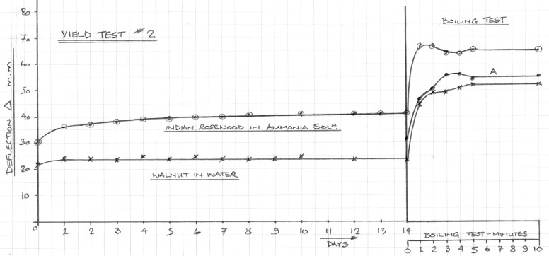

jdowning - 5-17-2016 at 12:07 PM
Another alternative for bending very tight curves in veneer is to soften the wood by chemical means. Five years ago I posted a series of experiments with the quest to make deeply fluted ribs using a combination of a marinade of household chemicals and/or heat.
http://www.mikeouds.com/messageboard/viewthread.php?tid=8363&pa...
This topic has so far escaped any image losses past or present. I found that soaking woods in chemicals such as household ammonia and wood alcohol resulted in sufficient softening so that they could easily be bent into tight curves. The trials included Indian rosewood samples that were the least affected by chemical softening (and consequent cell distortion) but responded to being marinated then boiled in water. The attached graph shows the experimental results from the trials.
It is a lot to read through and take in but you might find something useful there. At the end of the topic I also tested wood cold bending using compression rolls that is an interesting technique.
Yield Test #2 (776 x 362).jpg.jpeg - 51kB

faggiuols - 5-23-2016 at 01:13 AM
... I decided that the decorations of the sound holes were too ugly and poorly made, so I cleaned up the ruts and I will do them again ...
20160519_233959.jpg - 150kB
