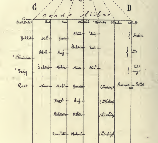

I've just read pages 208-209 and I'm wondering about the oud described by Meshâkah (under Eli Smith's pen) : Does it correspond to the tuning I drew ?
At the top the nut (head), the bottom goes to the bridge. The green numbers represent the ascending, the red ones descending.
1847 oud tuning.jpg - 57kB
fernandraynaud - 7-24-2010 at 01:29 AM
Why are your strings in that order? I think Smith's text is all mixed up.
I can't make any sense out of this, except one single way, and that's to think that if we read them from right to left, and convert the Arabic names to Germanic letter notes, the strings would be tuned:
Nehuft E A D G C F
I don't know what the %$#@ Nehuft would be doing there, but if that was mislabeled and we call it a low C, "Base to Rast", that sequence
C E A D G C F
suddenly looks exactly like a contemporary 7 course oud, except that your drawing is mirrored, pitches rise to the left. Then all the notes you marked are correct, though not necessarily in the right octaves.
If you draw a line across all strings at the level of Mahur on the Nawa string, that's the 5th fret, so at that level you can write on each string the name of the one to the left of it, and then it looks OK. The Rast string is really the Mahur string, and the one labeled Base to Jehargah is actually Response to Jehargah, or high F. The two rightmost courses are the drone courses, here tuned C then E (how I tune anyway), then the melody courses A D G C and a high F "mumtaz" course.
Is that how you interpret it?
David.B - 7-24-2010 at 01:36 PM
When I first read :
"1. Among the stringed instruments, is the `ûd. It has seven strings, each of which is double, to increase the strength of the sound ; only four of the seven, however, are much used. The first string on the left of the `ûd, is tuned to the base to jehârgâh ; the second is tuned to rest ; the third to nawa ; the fourth to dûgâh ; the fifth to `ösheirân ; the sixth to bûselîk ; and the seventh to nehuft. Thus each string is fourteen quarters [My MS says ten quarters, which is evidently a mistake. - E.S.] above the string on its right, or the base of that string ; and the interval between the pairs of strings is of three tones or not, accoding to the occurrence of the greater or smaller interval."
If said to myself : "There's a mistake"
The strings from left to right should be base jehârgâh, rest, nawa, muhaiyar, response to huseiny, response to huseiny-shed, response to the response to nehuft if we follow the progression of fourteen quarters, even if I don't understand "or the base of that string".
Then I read :
"Moreover there is a mark made across the lower part of the neck of the `ûd, under the strings, at the distance of one third from the head to the bridge. Its use is, that if you press upon any string over this mark, and then strike the string, the sound may be the same with that of the entire string next above, or with the response to that string. For if you take two thirds of the string of a musical instrument and strike it, the sound will be about fourteen quarters higher than the sound from the whole ; and from the half, the sound will be the response to the sound from the whole. E. g. if the length of a string consists of 3,456 parts, then will the half, viz. 1,728 ge the length occupied by the first octave, and 1,148 the length occupied by the fifth, which is about a third of the whole, being only 1/288th less than a third. The following table shows the length occupied by every interval, and every quarter, of the first octave. For the second octave, the distances will be half as great ; for the third, a fourth as great, &c. The proof of the whole will be evident to one who is achainted with the principles of geometry." -> The reason why I draw the 1/3 of the string (and 1/2).
And the last part sounded like such a mess that I needed to draw it to be sure of what I was reading :
"The four strings most used are rest, nawa, dûgâh, and `ösheirân. The other notes are obtained by pressing upon these strings with the ends of the fingers of the left hand. The manner of ascending and descending the octaves, is the following. Yegâh is taken from the base to jehârgâh by pressing upon it with the fore finger. `Ösheinrân is taken from the fifth string entire. `Arâk from the same string with the fore finger. Test from the same also, with the ring finger ; or sometimes from the second string entire. Dûgâh from the fourth string entire. Sîgâh from the same with the fore finger. Jehârgâh from the same also, with the ring finger. Nawa from the third string entire. Huseiny from the same with the fore finger ; also Auj with the ring finger ; and mâhûr with the little finger. For muhaiyar press upon the same third string with the fore finger at the point where the mark is drawn on the neck of the instrument : then for buzrek press upon it with the middle finger ; for mâhûrân with the ring finger : and for remel-tûty with the little finger. In descending proceed in a reversed order note by note to muhaiyar. Then, from the fourth string, reckoning from the mark toward the bridge, take mâhûr by pressing with the ring finger ; auj with the middle finger : and huseiny with the fore finger, [i. e. over the mark.] After which, take nawa from the third string entire, and then, returning to the fourth, complete the descent by reversing the order of the ascent.
When a quarter is wished instead of a regular note, in the circumstances described in the third paragraph of Chap. I. § 5, it is obtained by moving the finger up or down, as the case may be, on the string from which it is to be taken."
So if my draw corresponds to what E.S. had written, I guess he didn't understand Meshâkah. Also my purpose is not to interpret, I would prefer to check out Ronzevalle translation or better, the Arab original one to know the tuning used in 1847.
BTW, you interpretation is interesting Tony. I thought about that too but as you said E.S.'s text is all mixed up and it's really too unfocused to give a clear answer.
At last, I just wanted to be curious and know the tuning in order to have a better understanding of the 95 melodies.

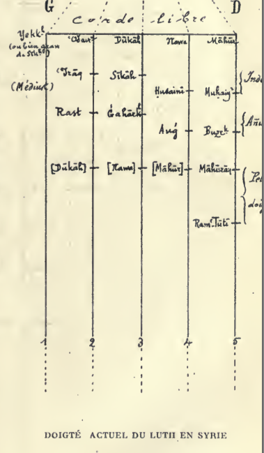

David.B - 8-19-2012 at 10:31 AM
What I drew corresponds with what I found in the translation by Ronzevalle. (PL. II)
In 1913, this tuning was already obsolete. (PL. III)
PL. II.png - 285kB PL. III.png - 178kB
