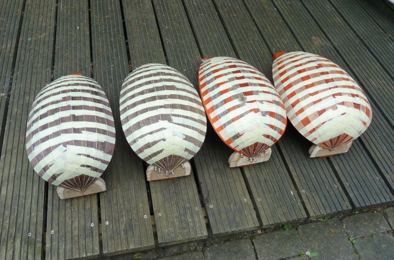

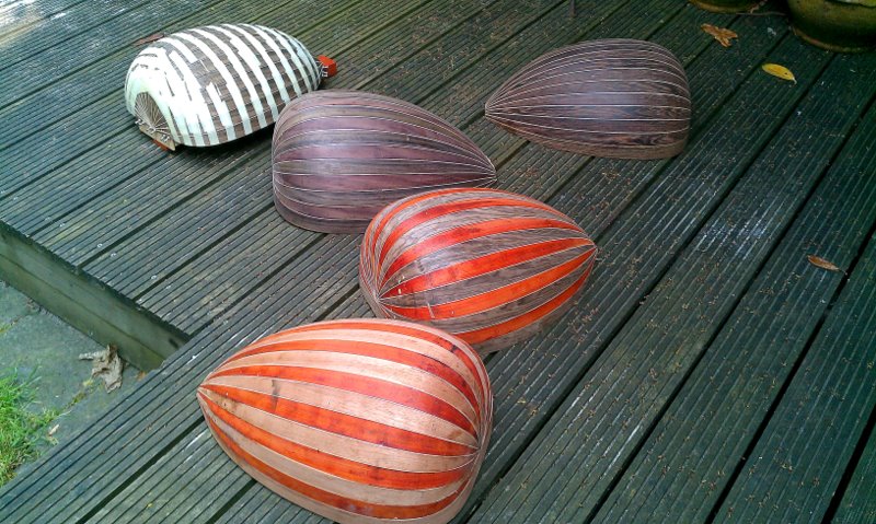

sabbassi - 5-20-2011 at 05:20 AM
After 2 rolls of tape and lot of Titebond glue, 4 Bowls are finished. the last oud still need the last Rib.
So far so good, every things goes smooth. The Padouk was hard to bend but with lot of heat and steam it was possible.
The padouk is known of its good sound charachterisques and very nice in combination with Walnut and Mahogany.

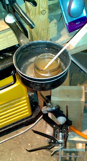

cleaning the bowl, paper stripes and Animal glue

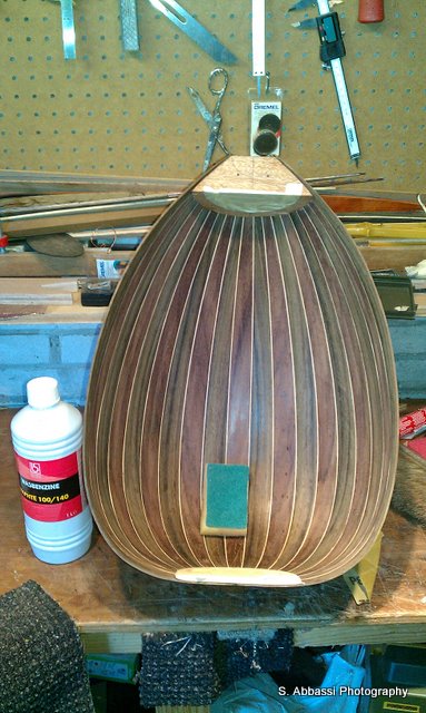

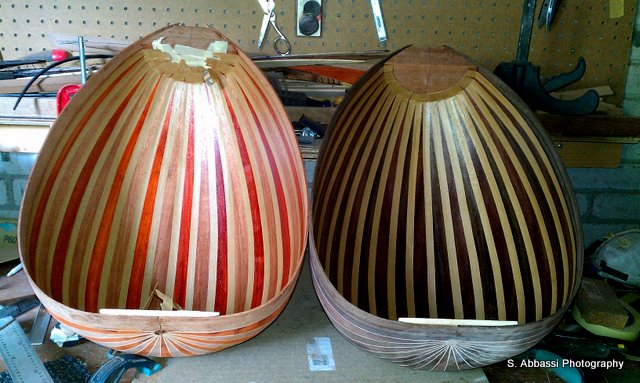

sabbassi - 5-23-2011 at 01:21 AM
The bowls are cleaned and scraped inside. Some Naphte is used to check any irregularity and remove any glue or bumps.
The stripes are cut from a cement bag, very strong for the rib joints.
Hot Animal glue is applied and the stripes are in place
IMAG0041.jpg - 77kB IMAG0043.jpg - 77kB IMAG0045.jpg - 79kB
