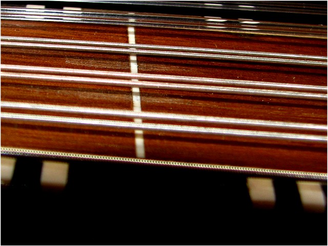

To prevent strings wearing the fingerboard on my Sukar Model 1, I did what I've done on my fretless basses, namely put on a few coats of Tung Oil. The stuff sets to a pretty hard surface that can be made more or less glossy, and on basses anyway, improves the sustain a little. It's a natural polymer, a bit like the linseed oil used on rifle stocks, but with its own properties. Formsby's "glossy" works well and sets in under 24 hrs.
I was amazed at how much it enhances the sustain on the oud, after I was done with the sanding and installed strings. Here is a very short before and after video with decent sound quality. No effects are used: the sound is just the natural sustain and sympathetics. The Canon camera's mics are used, closer in the second case. Yes, new (Mari) strings were used.
I do like the result. I used a lighter coating on another oud with a more classical "Arabic" sound. It also enhanced that instrument's sustain and personality -- a lot.
It's easy to control the timbre change by making the Tung surface more or less thick and glossy with sandpaper, steel wool, etc. The coating can be touched up as needed, as the strings wear it, and it is (almost completely) removable by re-softening it with liquid Tung Oil and rubbing it off.
The appearance ranges from matte-invisible to glassy. I think it's a bit of a "lucky discovery", hence my enthusiasm. :) Has anyone tried any (other?) finishes on the fingerboard? On the inside of the bowl? Comments?
Before & after Tung, Sukar Model 1, Windows Media 9 Video
[file]11381[/file]
Before final sandings
[file]11382[/file]
Final look
[file]11379[/file]

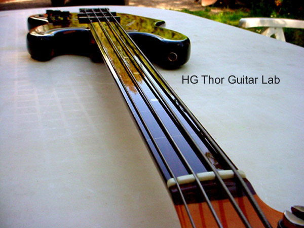

Yes, but there is a limit. On fretless bass and guitar glass and metal has been tried. It sounds and feels "foreign". For a really integral resonance, I'm not sure how best to word this, a sort of impedance match between all the parts is necessary.
Metal and glass will cause a very bright tone, but it doesn't couple back as well into the loop which consists of soundboard, strings, fingerboard, neck, etc. Epoxy and CYA are better than that, but still too hard. When I first tried Tung Oil, I thought ho-hum, nice, and THEN it fully set -- Wow! into a polymer with an acoustic impedance much like hardwood, and the impedance match was close to perfect, all the way around the loop. That's the best way I can comprehend it. A fretless bass is very heavy, the acoustic coupling is not as dominant. On the oud, because of the light construction and great resonance, it's nothing short of mindblowing. Pluck the string, and the vibration keeps on going, nudge it with a little vibrato and it's like pushing a swing in sync, it keeps getting stronger. Slide your finger up the neck and the next note is practically waiting for you. Hard to describe.
I would imagine ivory and tortoiseshell might also be very good, but another big advantage of Tung Oil is that the first layer soaks into the wood, eliminating a discontinuity, making the fingerboard conduct, rather than placing a smooth but distinct surface on top of it. It's important to both soak Tung Oil into the wood, sort of "plasticizing" it, and then add a thick enough series of coats to create a perfectly smooth and hard "petrified wood" flight deck. And it's still the same wood, it feels silky-organic-woody!

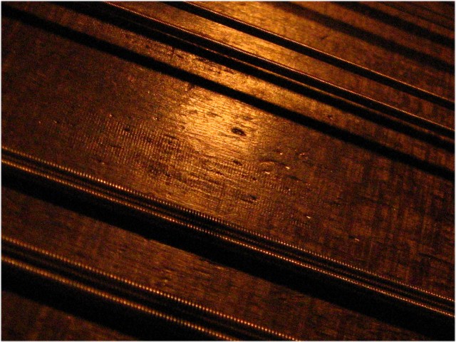

fernandraynaud - 11-21-2009 at 11:44 PM
OK, this has been a good test, there were some doubters. The sustain is still amazing, and the wear is as expected.
Under note Rast, the original varnish was peeling away within 2 weeks of intense playing and the wood was starting to wear. With the Tung oil, after two months of heavy playing you can't see any wear to the naked eye,
[file]12422[/file]
but if you put the light just so and blow up the picture, you can see slight string "snake marks" as I get on my basses.
[file]12424[/file]
This is so shallow your fingernails even can't detect it, and a wipe of tung oil when changing strings blends it in and strengthens the coating.
I'm very happy with these results and can recommend Tung oil coating in good conscience for an oud's fingerboard, especially on the softer woods. The fingerboard's wood is protected, the feel is very good, and as a bonus the sustain is increased.

Here is a photo of the treated neck on my Sukar where you can barely see the "serpent-skin" wear on the mostly Jasco's finish, and on my Egyptian, where the wear on the Formby's finish is "whitening". This is after about six months of daily playing on both. It looks on the photo like the "whitening" is wearing down into the wood but that is an illusion, the whitish wear is only more visible. Both can use a touch up by now, but neither is anything like the original neck-varnish (that was peeling and exposing raw wood after only a month). You can guess there is likely a plastic resin in the Formby's that makes it more "crunchy", and the slower-setting Jasco + Japan Drier mixture is probably more flexible and wears down more slowly. Hard to say if either is really better.
The best fingerboard coating might well be Cyanoacrylate, as long as it's not turning out too hard, but the process intimidates me. I cannot find the illustrations, but here's the article text:
http://www.bassplayer.com/article.aspx?id=20674
Img_5823xm.jpg - 106kB IMG_6997XCM.jpg - 88kB

Be patient. I am coating a neck that started out rather thickly varnished. I used alcohol and naphta and sanding and it still didn't completely come off. It's harder to bond anything to it, the oil mix cannot soak in well, and it hardens more slowly. The first coats with oil mixes can be tricky.
I was researching some coatings used for billiard cues, but the maker just answered it won't work well for us. But I also found fume-less cyanoacrylates, so there is probably a cyanoacryl-fingerboard in my future. I don't believe in segregating "organic" vs "synthetic" finishes, everything is bio-chemistry. If it bonds and polishes easily into a tough coating that can be touched up, it doesn't matter whether it came off a tree last year as seed oil or millions of years ago pressed into crude oil. After this neck, my plan is to do some tests with cyanoacrylate on wood scraps.
Here is what some people buff epoxy and cyanoacrylate fingerboards to, if they like the bright sound and long sustain. Wow! A semi-matte surface is of course much easier to do and more appropriate for the oud.
