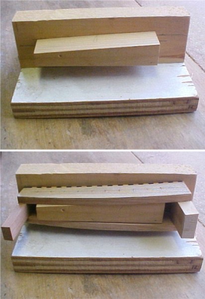

[*] posted on 11-24-2009 at 12:44 PM
The pegbox sides will be made from Beech wood veneered with Ash. Beech has been chosen because it is one of the woods recommended as best for oud making in the early Arabic and Persian texts. Also Beech was often used by lute makers of the 16th and 17th C for pegboxes and my old Egptian oud has a pegbox of beech veneered with Mahogany.
I only have a small piece of old Beech wood (50 or 60 years old) to work with - just about sufficient to make the peg box sides - so there is no room for error. The Ash veneer has been selected with a curved grain pattern to match the curve of the pegbox sides. The Beech wood blanks have been sawn to about 8 mm thick and the Ash veneer to about 2mm. After the veneer has been glued to the sides, the Beech will be planed down to about 6 mm thickness and the veneer to about 1mm.
In order to hold the small pieces of Beech securely for the planing operation, I used a strip of double sided carpet tape to temporarily secure the blanks/ veneer to a flat piece of wood held in a vice.
This is a technique adapted from Dr. Oud's (Richard Hankey) recently published (and recommended) e-book 'Oud Repair' - for sanding thin patches. (For those interested, the book may be purchased on line at

[*] posted on 12-7-2009 at 12:40 PM
To support the peg box at the correct angle for drilling the peg pilot holes, a simple jig has been made from wood offcuts. - to be used on a drill press. This jig will be used one time only and then scrapped so does not need to be too fancy but does need to be accurate.
The support block on the jig is planed to the inside taper of the peg box. This provides backing to the inside face of the sides to eliminated any splintering due to the drill breaking though. The block is reversible so that the peg holes may be drilled from either side.
I prefer to drill the holes from each side (two operations) rather than from one side and drilled right through in a single operation. This requires accurate set up of the jig (square and level) and use of a metal layout pattern to ensure matching hole centres on each side of the pegbox.
The holes are drilled to 7 mm - just a bit less than the minimum diameter of my peg reamer - using a utility grade brad-point drill (designed for drilling wood). I do not like this type of bit as much as the (much more expensive) lipped brad-point kind as they do not cut as cleanly or as accurately but, as the holes will eventually be opened up with a peg reamer, this does not really matter at this stage. The main concern is to achieve as close an alignment of the holes as possible (although any slight misalignment may be corrected when the holes are reamed out when fitting the pegs). Hole alignment can be verified by pushing the drill bit though the holes and checking for squareness against the peg box sides.
Pegholes drilled.jpg - 71kB
Pegbox Drill Jig comp (550 x 800) (412 x 600).jpg - 55kB
