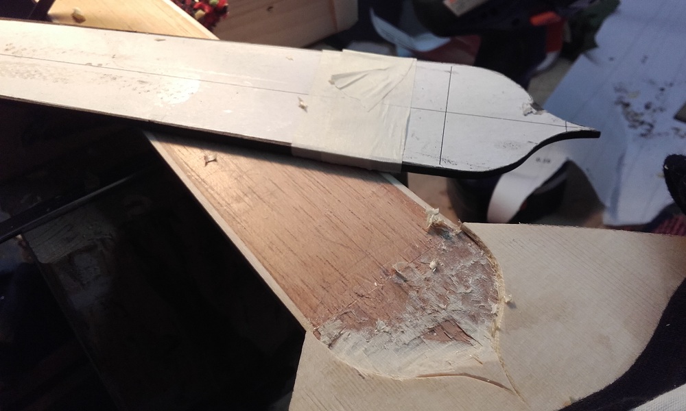

[*] posted on 1-4-2017 at 08:54 AM
Goodmorning everyone
I'm coming to the final stage of the construction of my first oud.
I attach the picture of the current state. I'm digging the position for the beard.
soon I'll be ready for painting and, finally, to hear the voice of the oud.
I need some suggestions for the strings to mounted on. someone could advise me make and model of strings that I have to buy?
I thank you all in advance.
20161222_230918 (1).jpg - 161kB 20170103_215823.jpg - 151kB

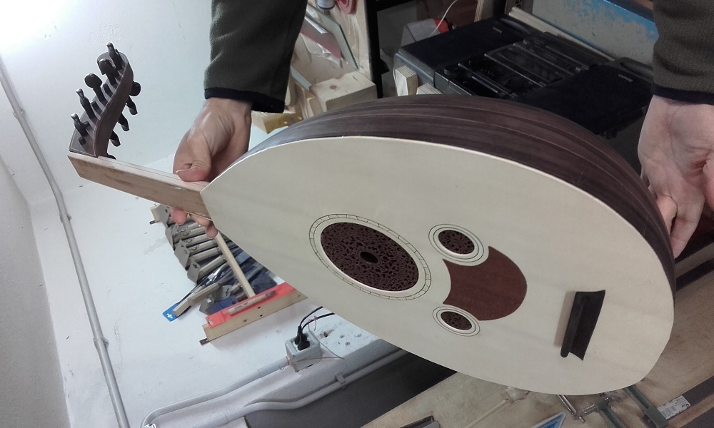

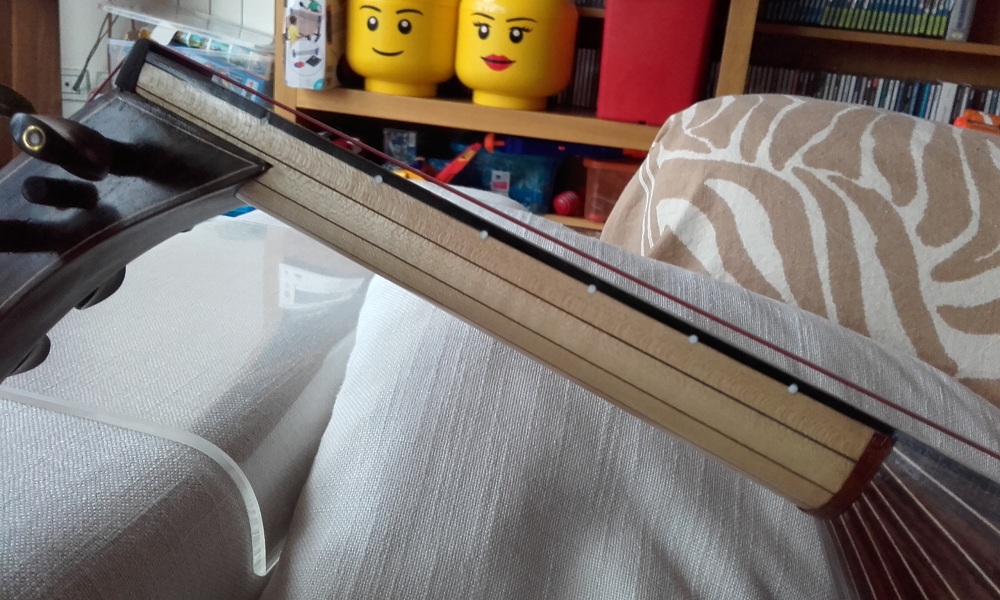

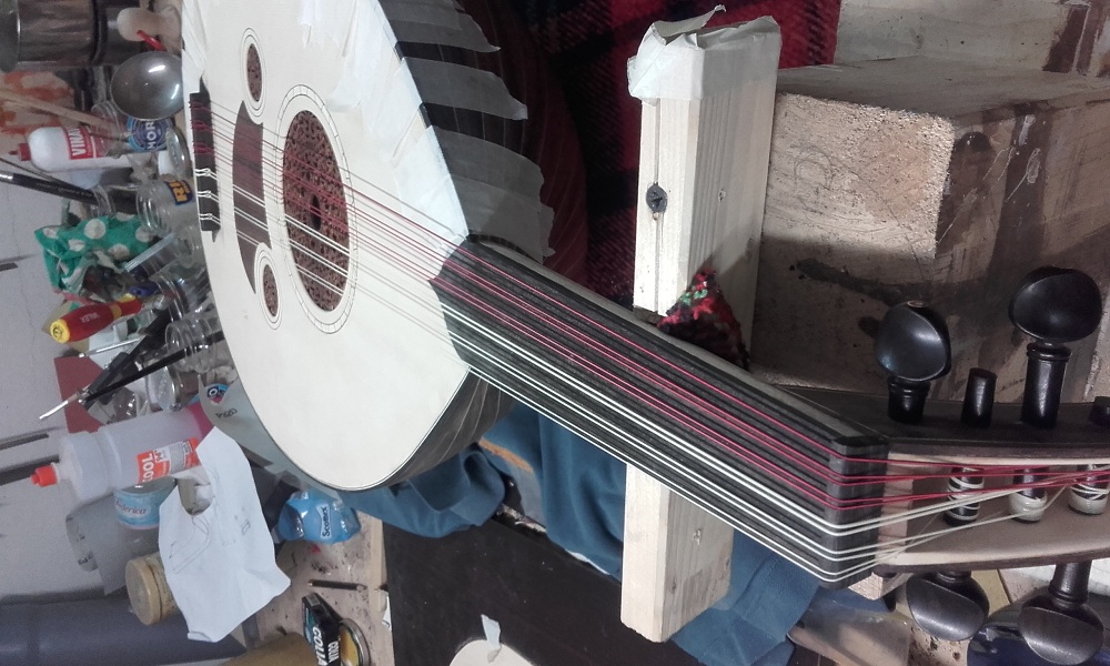

[*] posted on 3-22-2017 at 01:57 AM
I finally arrived at the end of my big trip in the construction of my first oud !!
They are ready to paint it.
I have a big doubt! The fretboard is to be painted or left to wood?
thanks to those who will help me.
20170321_232714.jpg - 182kB 20170321_232734.jpg - 249kB
[*] posted on 3-22-2017 at 05:37 AM
Leave it to wood. you can put some lemon oil on it if you want to condition it a little bit.
faggiuols

[*] posted on 3-22-2017 at 07:42 AM
thanks a lot Samir
can I also use tru oil?
[*] posted on 3-22-2017 at 08:49 AM
tru oil is a varnish that will dry on top of the wood. What happens is after playing for a few weeks the strings will make grooves into the varnish and it will start to buzz.
lemon oil will penetrate the wood and give it a darker appearance but not dry on top.

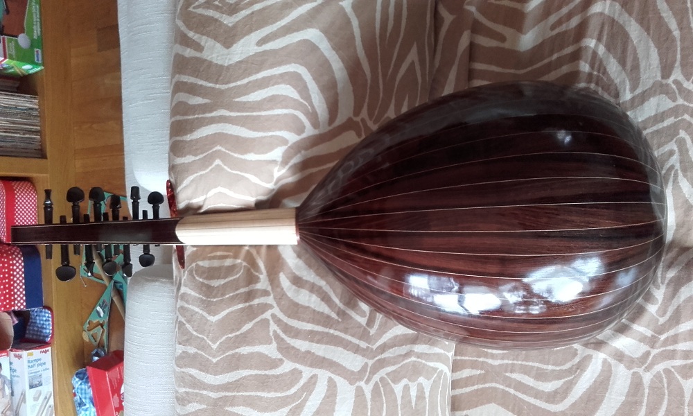

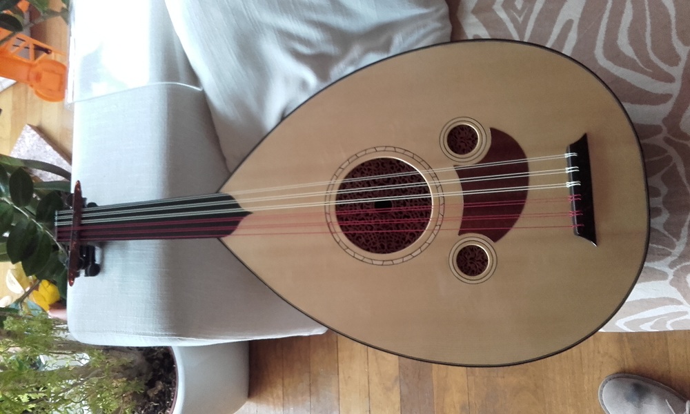

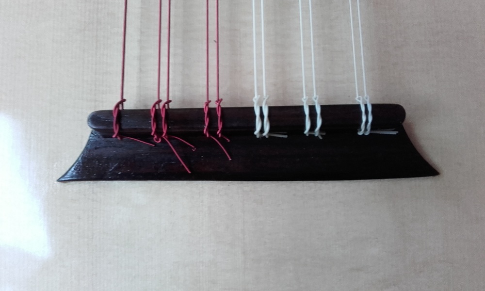

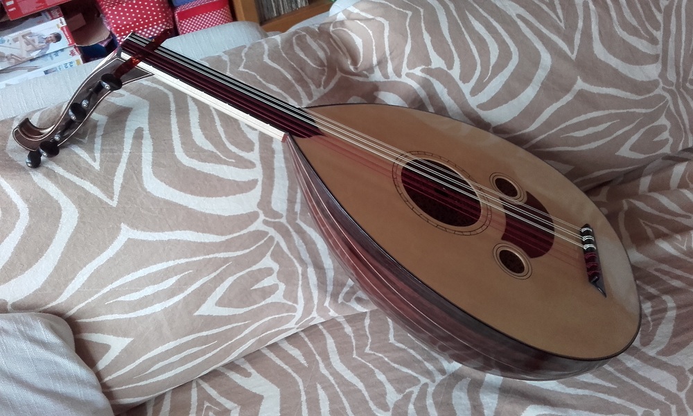

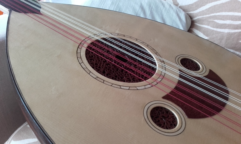

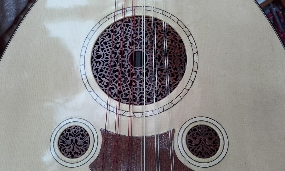

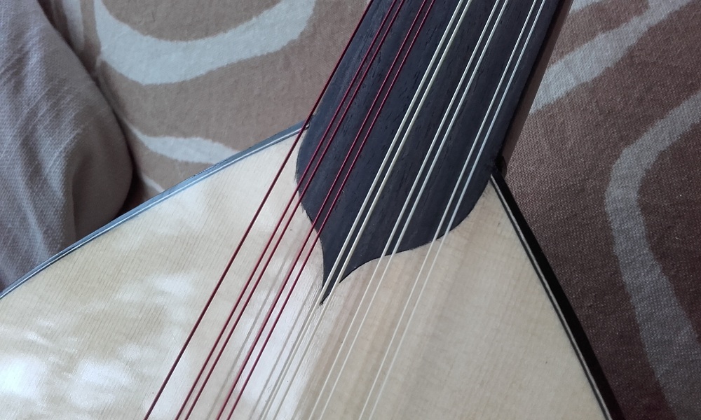

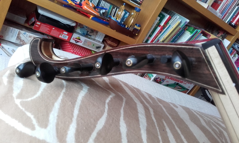

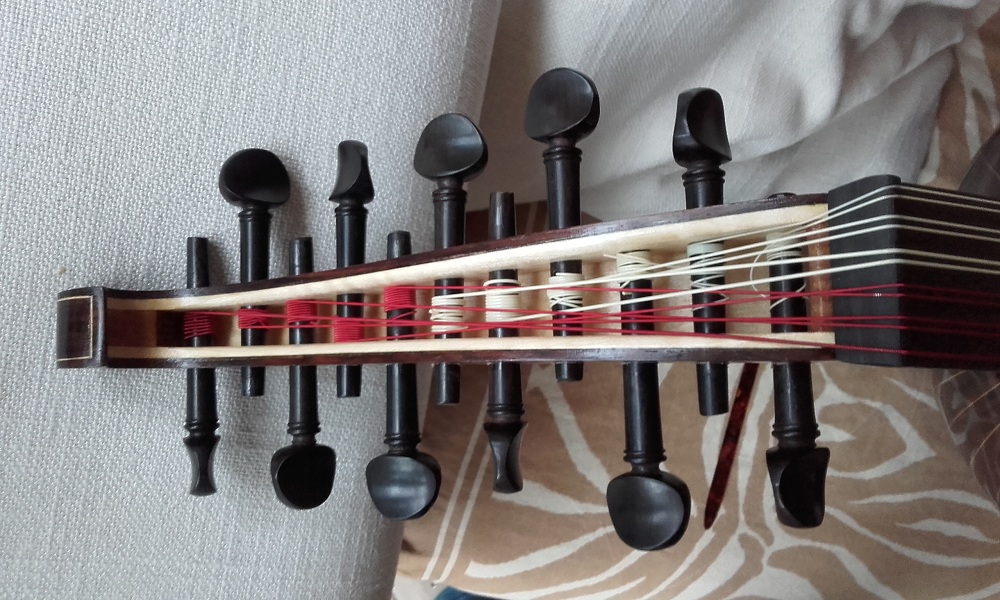

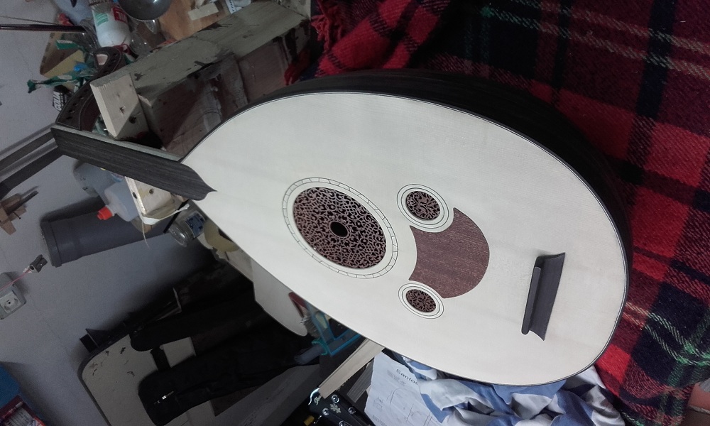

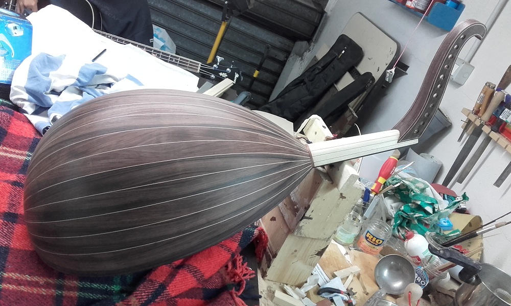

[*] posted on 4-29-2017 at 12:09 AM
Here it is.
I've attached the pictures of my first finished oud.
I built it for over two years. I started in September 2014!
It was a very difficult time of my life, totally devoid of beautiful things, so I decided to devote myself to my passion, always neglected, the luthiery.
Oud has always been my favorite musical instrument!
Today my life is not in the same difficulty as two years ago, even because of my first oud.
I want to thank all of you who have followed me in this difficult journey, having no experience nothing of luthiery.
Special thanks to Jdowning, who has made available to me his immense culture to help me in this building, and Samircanada for accompanying me with many suggestions and valuable advice to Alfaraby for giving me beautiful roxette designs! Without them, it would not be possible to realize this dream!
Thanks also to all those who have spent a few moments to follow the topic that ends here!
I also hope to attach an audio file to show the sound that sounds great to me!
Soon, friends .. maybe for my second oud!
20170428_192528.jpg - 213kB 20170428_192456.jpg - 193kB 20170428_191641.jpg - 232kB 20170428_191630.jpg - 215kB 20170428_192437.jpg - 171kB 20170428_192536.jpg - 217kB 20170428_192617.jpg - 225kB 20170428_192626.jpg - 244kB 20170428_192644.jpg - 222kB
20170428_192552.jpg - 126kB

[*] posted on 4-29-2017 at 12:59 PM
Dear faggiuols,
Fantastic work man ! You've got a tremendous eye for detail, the pegbox, contrasting neck, position dots, are so beautifully crafted. The bowl has some terrific grain, and a lovely deep finish. The purfling around the center soundhole is a trip and a half ! I'd been following your oud building journey - just on and off over the past 2 years, so congratulations ! Can't wait to hear how it sounds !!
Best Regards,
Paul

[*] posted on 4-30-2017 at 03:05 PM
Dear faggiuols - so you made it! Fantastic effort and fine workmanship for which you must be justly very proud. May this instrument be the first of many to come and I trust that it will return beauty, joy and tranquility to your life.
All the very best
John
[*] posted on 5-1-2017 at 05:23 AM
I don't deserve your compliments Faggiuols. You made a beautiful first oud and as you say I also hope its the first of many. I really like the wood and inlays combination. great job.
If you allow me, the nut where the strings go over neck looks very high! it will be hard to play like this, it needs to be 1mm or even less away from the fingerboard. Now it looks like almost 3mm! It will also lower the action a little bit which seems high at the moment.

[*] posted on 5-2-2017 at 12:18 AM
Dear Samir
As always, you don't miss the details.
it's very true. The bridge has to be lowered and the action is still high. All setup has yet to be done. Even pegs are unmanageable and I have great difficulty tuning the oud.
All this I will do in the next few days with calm, but what scares me is to play it !!!
As soon as I finish the setup, I will try to post an audio file!
