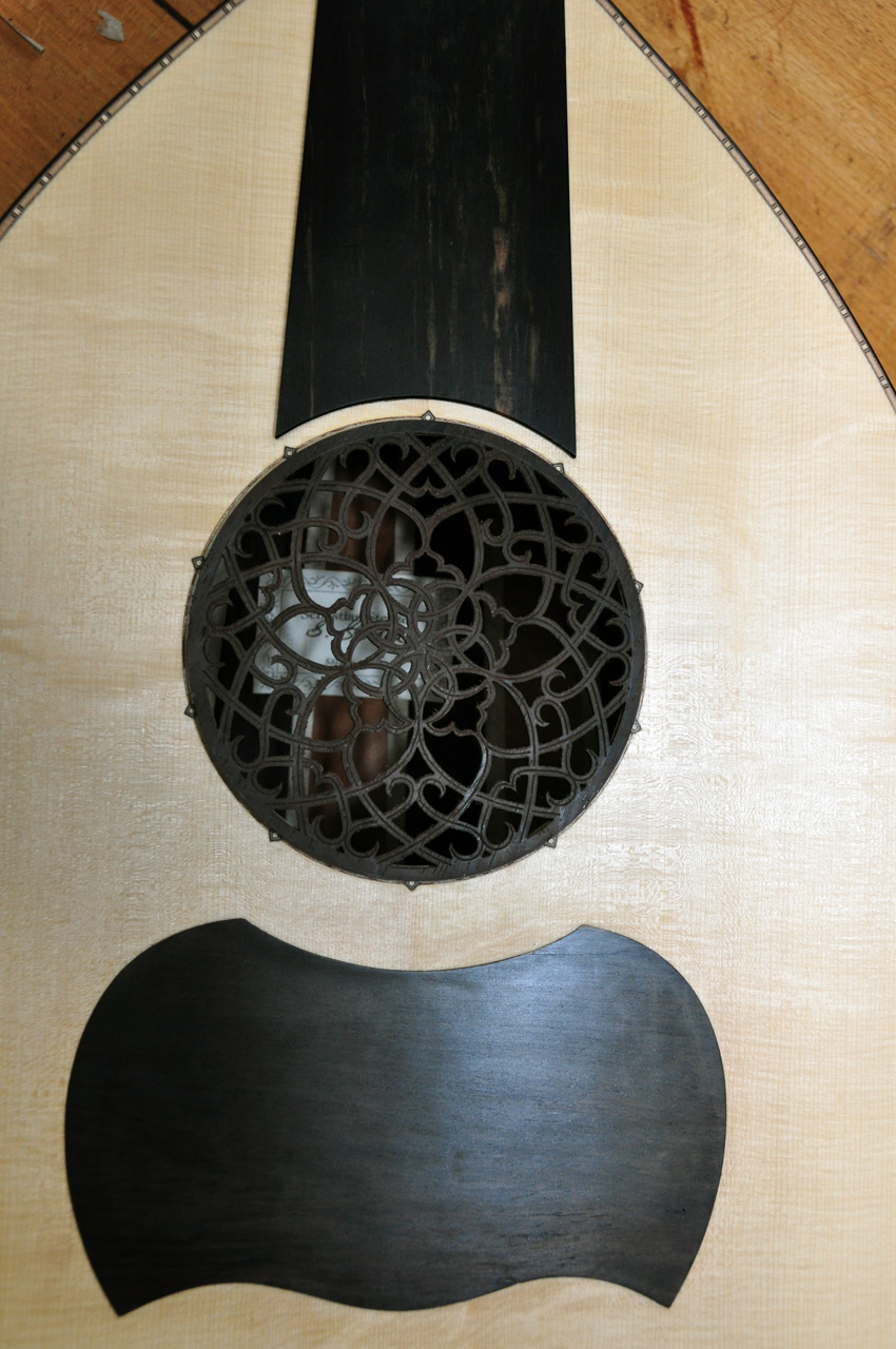

Hello, today again progress ...
- french polishing is moving towards the end
- the rosette is now here (see the raw form before the cleaning ...
- the rosette is now cleaned and glued in - so the bowl is now closed.:)
Tomorrow the oud will be finished and stringed - and I (howl howl) will be working the whole day from morning to evening, no way I could play it tomorrow ...:(
best wishes
Robert

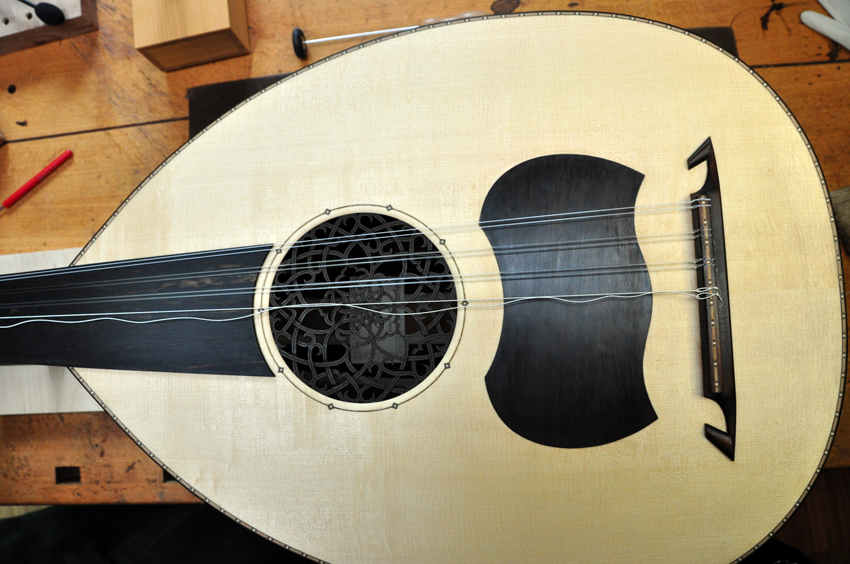

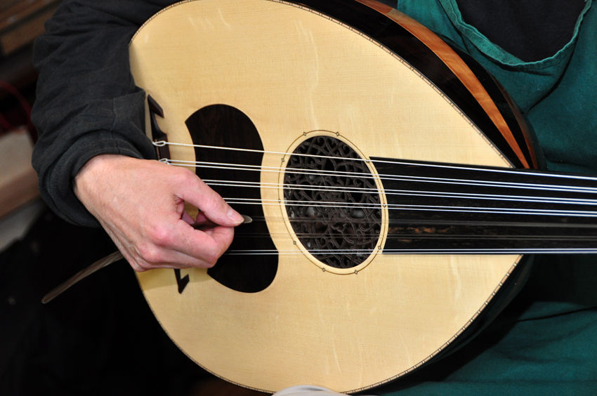

Dear oud friends ... the oud is ... almost ... ready!
Only minor cosmetic works on the varnish have to be finished and left some time for drying up ...
Today the first strings were put on the Oud ...
Oud18.06.1StringMike.jpg - 407kB

[*] posted on 6-18-2010 at 08:51 AM
Then Sebastian Stenzel tuned very slowly up until we had a minor third below the standard tuning. He wants to make sure that the structure grows accustomed slowly to the full tension of the oud. So, the strings being Daniel Mari strings plus Aquila high f, everything is quite slack yet; though the sound is more than promissing.
The Sebastian Stenzel played the first notes ...

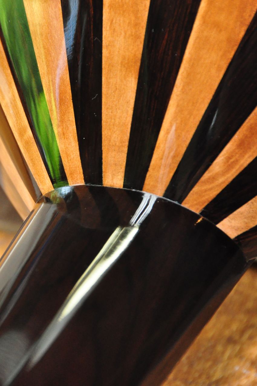

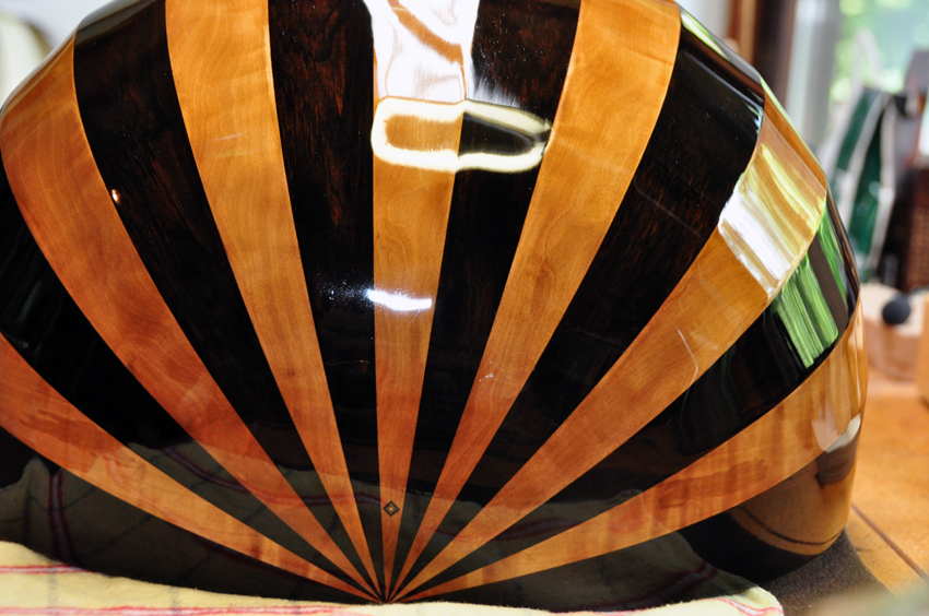

Here are some detail pictures:
oud18.06.DetailMike.jpg - 411kB

[*] posted on 6-18-2010 at 08:59 AM
Here is the junction between body and neck ...
best wishes
Robert
Oud18.6NeckJunctionMike.jpg - 672kB
