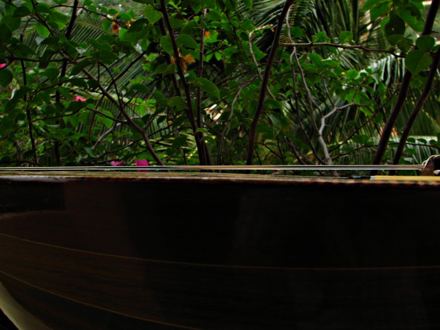

My remaining problem is that the soundboard has swollen, probably from the lysol adventure, maybe just from the ambient humidity, and I don't know if I can expect it to go back down. Do I need to wait for dryer climate, or is there a trick I can try here? Might it never return to the old shape? Does anyone have experience with the spooning soundboard effect?
You can see how much it has risen, maybe 1 cm, certainly more than 1/2 cm. Are there any known tricks for quickly absorbing humidity? Run hot air from the hair dryer through it?
I think I'm going to try to sell the oud here, as all instruments are horribly expensive, apparently due to high duties. Absurd prices. And nothing made locally. Ibanez bass: $1350. Mexican Fender guitar: $1400. Of course they have never imagined, let alone seen, an oud. i will have to explain it is muy popular in America!

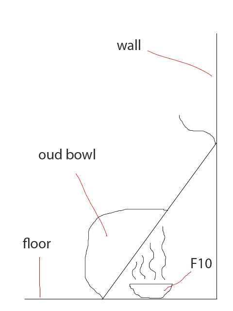

First I would buy F10 and make a F10 water mixture of 1:125, which is the highest concentration for viruses. I'd do that because I wouldn't want contact of the fluid with the oud. But F10 would evaporate at room temperature, if the humidity isn't to high in the room ... maybe max. 50%. If he puts the F10 mixture in a bowl and places the oud's soundhole above it, the F10 gas would reach and kill the bacteria over a time of several days. See picture.
After the bacteria are killed, he could fill in coffee "powder" through the rosette holes, which can be shaken out later ... the rest might be removed with a vacuum cleaner and a thin tube ... if that fits through the rosette holes.

If you do the procedure in winter you can use F10 without any risk. If I remember it right, you live in New York, where you will use a heater to warm up your appartment. And as we all know, heaters dry out the air, so that owners of valuable instruments need to take care to raise the humidity to a level of around 50%. Without that care, it would be around 30% in winter ... much too low.
And that's where F10 comes into place again. You use a F10-water mixture instead of pure water to raise the humidity.
That should be the easiest method without any risk, when done in a small room and the humidity is controlled by a hygrometer.

I would definitely buy F10 and first use it on the hardcase and then dry it again. Here you can spray the inside slightly with F10 without any risk (don't wet it too much), let it "operate" closed for half an hour and dry it with a hair dryer, that is not too hot. An alternative approach would be to put a piece of cloth soaked with F10 on a piece of plastic bag inside the closed hardcase for half an hour so that F10 will operate as a gas. After that, I would use it on the oud as a gas as described above.
I my opinion you have a good chance to solve the problem this way and if not, the problem will be that worse as Fernand reported ... complete reglueing ... unbelievable, what this would cost.
