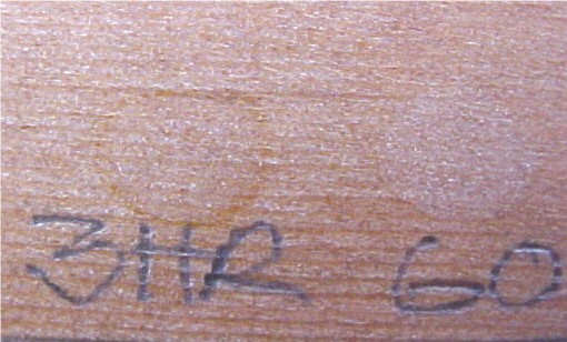

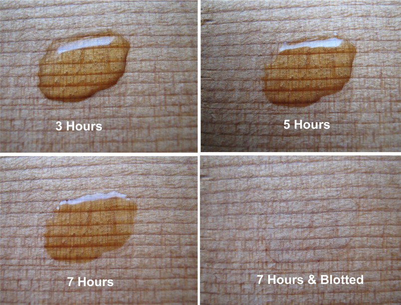

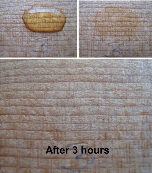

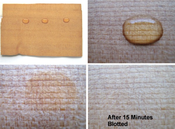

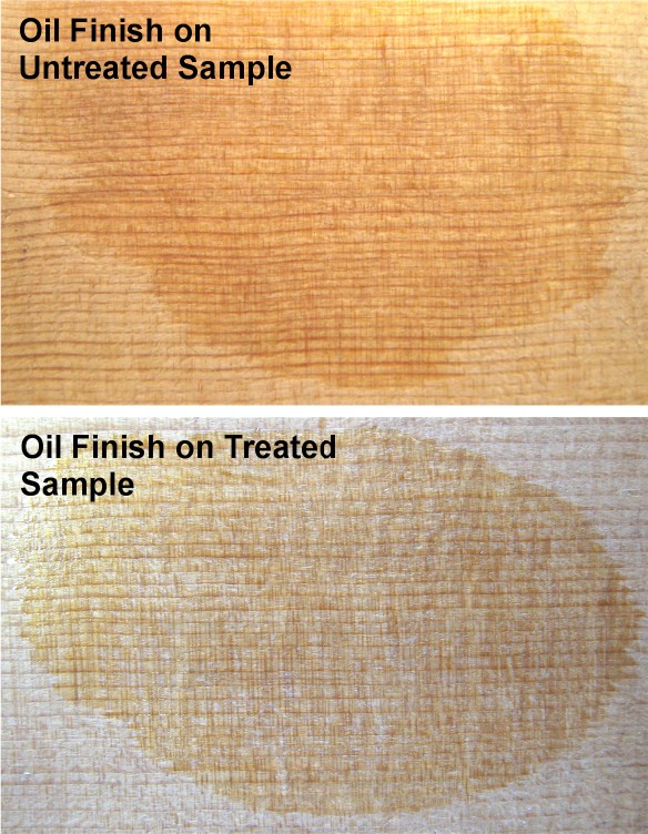

The test piece with two coatings of distillate showed the same level of resistance as the single coating in the water droplet test. In this test a
water droplet was allowed to remain on the surface until fully evaporated (3 hours) and left a visible 'ring' or watermark that did not polish out
with a cloth. The attached macro image shows the 3hr residue next to the faint white residue left after a water droplet had remained on the surface
for 60 minutes, blotted and then allowed to dry.

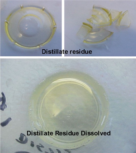

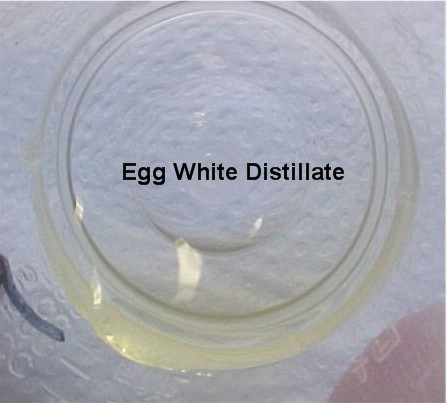

A small sample (2.5 ml) of batch #1 of the egg white foam distillate had been set aside for a few days to completely evaporate.
The resultant residue remaining in the bottom of the measuring cup was clear and transparent with a very slight yellow tint. The dried residue was
brittle.
Water (2.5 ml) was then added to the residue which immediately started to dissolve (like a gum) becoming fully dissolved with stirring in about 5
minutes. The resultant fluid was clear and transparent with a slight yellow tint and tested at about pH 10 alkalinity.
The residue is therefore fully miscible in water and appears to have the same properties (?) as the original distillate when reconstituted.
The reconstituted distillate will again be left to fully evaporate - just to see what happens.

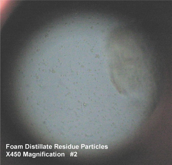

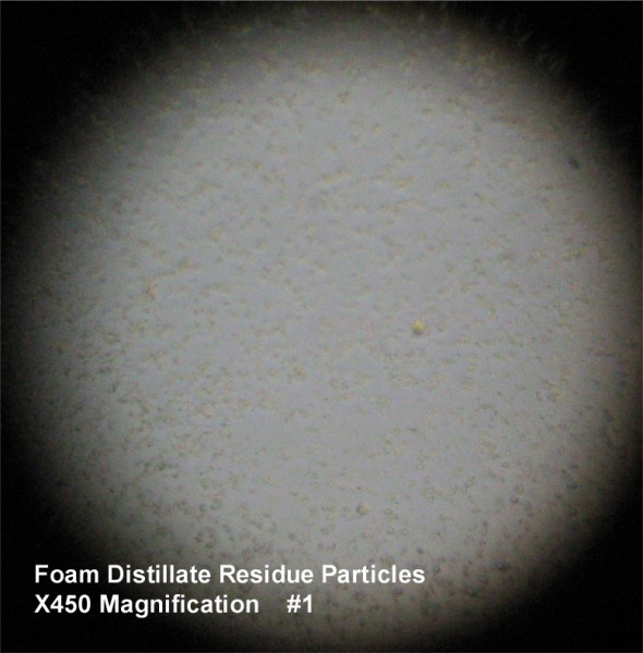

This morning - after a period of 48 hours - the 'reconstituted' foam distillate residue, set aside to evaporate, had a slightly cloudy appearance due
to the presence of a lot of small particulate matter in suspension. So far there appears to be very little - if any - fluid lost due to
evaporation.

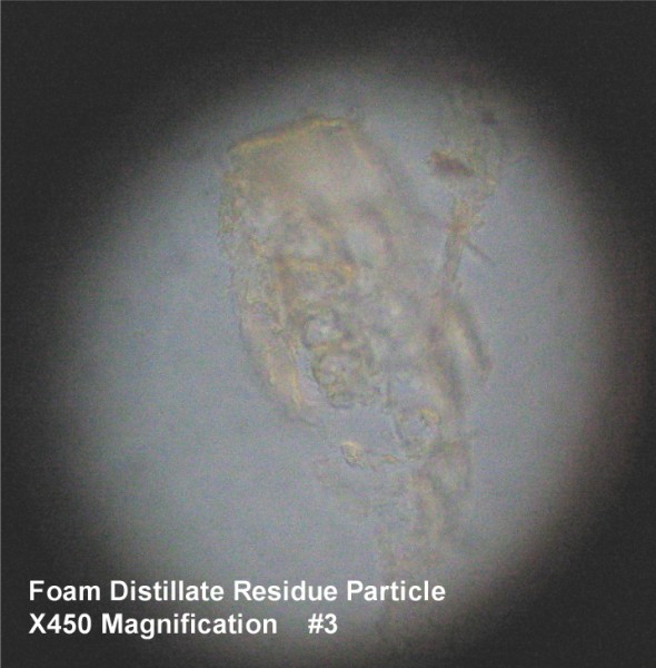

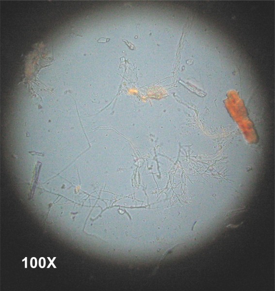

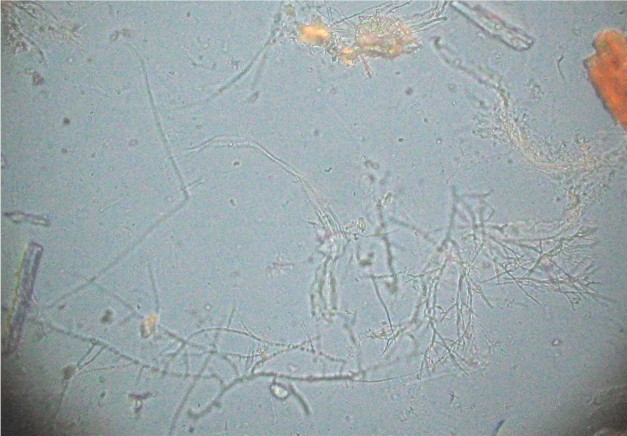

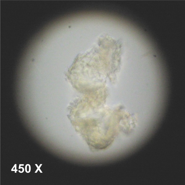

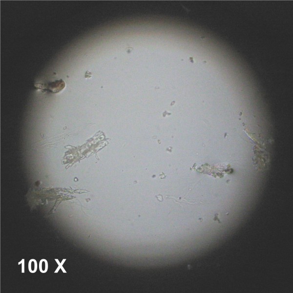

The fluid was examined under high magnification (X450) using a laboratory standard microscope. This revealed - apart from a few larger visible
particles of what seemed to be distillate residue (transparent, light yellow tinted) - a mass of microscopic particles of the same material
(transparent, light yellow tinted) in suspension, so small as to be invisible to the naked eye.
Hard to know what is going on here but it would seem that the addition of a relatively large volume of water to 'dissolve' the dried distillate
residue caused the residue - initially - to break up into minute fragments (molecular sized?) that then begin to rejoin together (by molecular
attraction?) over time into increasingly larger sized particles of the residue.
In order to test if the particles are joining together by some kind of molecular attraction and not as a result of fluid evaporation, water will be
added to the sample daily to compensate for any evaporation losses.
The microscope is an old but high optical quality Leitz compound microscope. It took a bit of adjustment to obtain the best light contrast to show up
the particles.
The attached images were taken with a Canon Powershot A470 digital camera, in 'point and shoot' mode, simply held over the eyepiece of the microscope
- hence the 'vignetting'. All a bit 'rough and ready' but it worked well enough to give a reasonable appreciation of what could be seen under the
microscope.

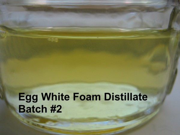

After a long period of hot, humid conditions, the weather has moderated sufficiently to allow preparation of batch #2 of egg white foam distillate.
Separation of egg white from the yolk is a delicate enough operation in order to avoid breaking the yolk and contaminating the albumen. The best way
is to tap the egg shell (in the centre) on a hard surface just sufficient to crack the shell. The shell halves are then separated sufficiently to
allow the albumen to drain into a clean, grease free mixing bowl.
The albumen of two large sized eggs was then beaten to a stiff foam with an electric whisk - set at half speed - for 7 minutes. The foam was then left
overnight (for 12 hours). Conditions at start were temperature 26 Celsius, Relative Humidity 57% and at finish 21 Celsius, 63% Relative Humidity. The
distillate collected measured 50 ml - clear with light yellow tint.
The remaining foam was quite firm and stiff.
The pH value of the raw albumen was about 8.0 and that of the distillate collected about 10.0.

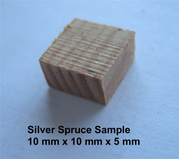

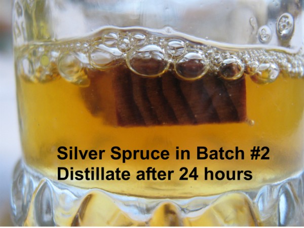

With sufficient quantity of batch #2 distillate available samples of silver spruce have been prepared and left to soak in the distillate in a sealed
container. This test is to find out if there might be a reaction between the alkaline distillate and the wood.

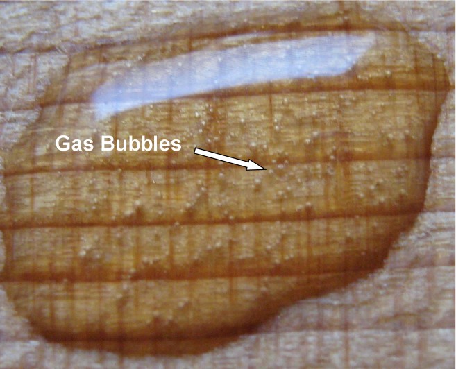

After 24 hours immersion of the wood samples, the distillate had darkened in colour from the pale lemon of the distillate to a light brown tint that
appeared to be slightly cloudy. Small bubbles of gas (air?) could be seen coming from the wood samples forming larger, stable bubbles on the surface
of the distillate.
Microscopic examination showed that the cloudiness is due to many solid particles in suspension. The particles have a random shape and lemon yellow
tint looking very much like the distillate residue particles in the microscopic images previously posted.
This morning (three days later) the surface bubbles have reduced in size and quantity and emmission of bubbles from the samples seems to have ceased.
This may indicate complete saturation of the samples with the didtillate.
The distillate is now full of particles - visible to the naked eye - giving the distillate a clouded appearance.

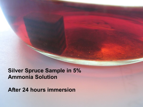

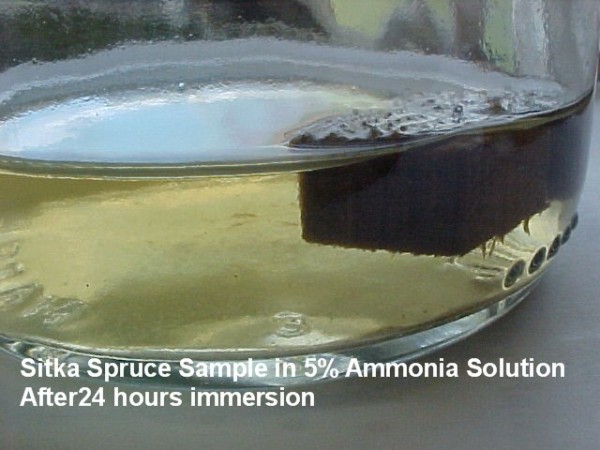

As a further test - for purposes of comparison - samples of silver spruce and sitka spruce have been allowed to soak in household ammonia solution in
sealed containers. Household ammonia is a 5% solution of ammonia in water with a pH value of about 11. The greater alkalinity should, therefore,
accelerate the test into a shorter time period than for the distillate.
After soaking for 24 hours in the clear ammonia solution the solution in the silver spruce container had changed to a clear wine red colour and that
of the sitka spruce to a clear pale yellow colour. Clearly some kind of chemical reaction is in progress.
After 6 days immersion in Distillate #2, the silver spruce sample seems to be fully saturated. The distillate is 'muddy' in appearance due to the
presence of many particles in suspension.
Under the microscope - in addition to larger particles of what seem to be distillate residue there are a number of 'tree like' growths (dendrites)
where individual cells seem to be joining together into longer chains.
Not sure what to make of this at present - so just for the record and information.

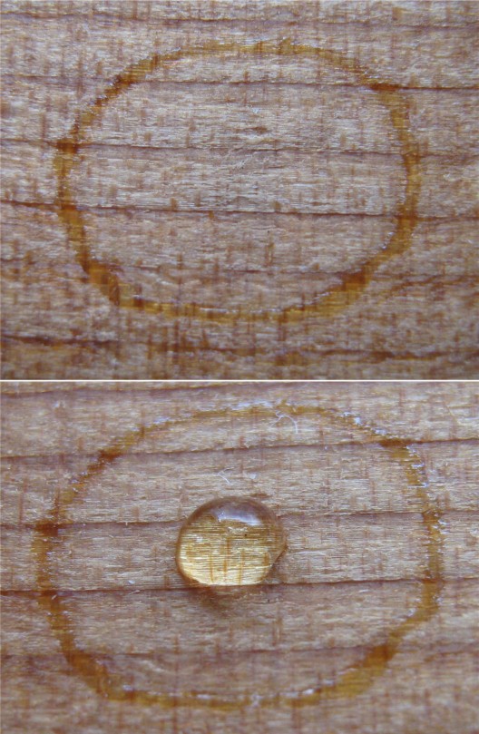

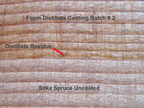

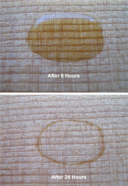

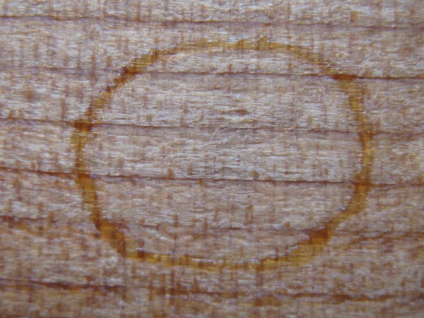

Batch #2 foam distillate is being tested as a coating on a sample of quarter cut Sitka Spruce sound board wood. The distillate was brushed on so that
the surface of the sample was 'flooded' and then allowed to dry for 24 hours. The distillate caused the wood to darken in colour and a distinct
distillate residue accumulation was noted at the edge of the coated surface.
The coated surface was then tested for water resistance by allowing a large water droplet (11 mm diameter) to remain on the surface until completely
evaporated (several hours). This left a ring of distillate residue at the perimeter of the droplet. The area inside the ring was paler in colour than
the distillate coating outside
So it would appear that the water 'dissolved' the insoluble component of the dried distillate into smaller residue particles which then migrated
(under surface tension?) to the outer edges of the water droplet.
The area within the ring of distillate residue appears to have been cleared of residue on the surface of the wood sample. Is this area water resistant
due to a chemical reaction and/or molecular bonding between the distillate and the wood cells?

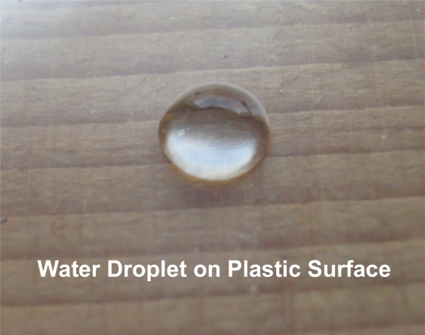

To answer this question a droplet of water was placed in the centre of the ring and allowed to remain for 15 minutes. It can be seen from the shape of
the droplet that it is sitting upon an impervious surface (compare this to a water droplet on a waterproof plastic surface). After 15 minutes the
droplet was removed by blotting with an absorbent paper towel. After all moisture had dried there was no visible evidence of any water staining by the
droplet or absorption of moisture into the wood.
This confirms that the surface is at least water resistant due to the presence of distillate that has soaked into in the wood cells. So it would
appear that after flooding the surface of the wood some distillate is absorbed into the wood cells sealing them against moisture absorption while the
surplus distillate dries out on the surface of the wood as a 'varnish' layer that can be 'dissolved' by the addition of water.

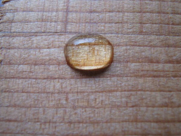

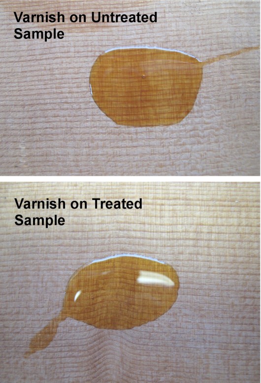

The next test was to 'wash' the dried surface of the test piece - coated with distillate - with water. Water was brushed over an area of the test
piece (measuring 30 mm X 60 mm) - flooding the surface - and then allowed to dry for 24 hours.
Even with an area of this size distillate residue was observed to accumulate around the edges of the 'washed' area.
Two water droplets were placed on the surface - a small droplet measuring about 4 mm in diameter and a larger drop measuring about 12 mm across.
After 90 minutes the small droplet was blotted with absorbent paper. There was no visible evidence of water stain or absorption by the wood.
The large drop was allowed to remain on the surface to partially evaporate for 7 hours before being blotted and dried. There was no visible evidence
of the water being absorbed by the wood although there were some slight traces of distillate residue that had formed around the perimeter of the drop
- presumably due to traces of distillate residue remaining on the surface after 'washing'.
Enlarging the macro images of the large drop revealed what appeared to be minute bubbles of a gas on the surface of the wood - presumably similar to
the gas bubbles observed during the immersion test previously posted. Sign perhaps of a chemical reaction taking place within the wood cells?
The next trial will be to coat a larger test piece of Sitka Spruce with distillate followed by a water coating and buffing to remove any dried
distillate residue remaining on the surface. Then to run the water droplet test again

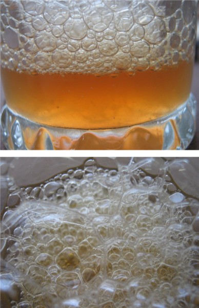

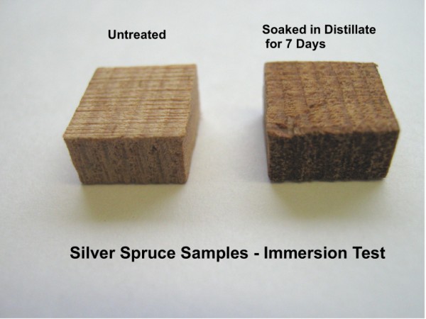

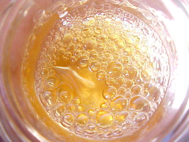

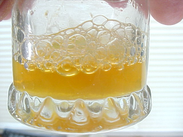

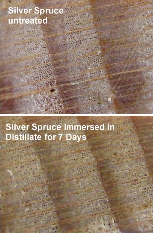

After soaking in foam distillate for 7 days, the silver spruce samples have been removed and allowed to dry. The colour of the distillate has changed
from a transparent pale lemon tint to a cloudy orange.
For information, bubbles initially forming on the surface of the distillate had remained stable for several days but eventually disappeared after 7
days. It is interesting to note that stable bubbles formed again on shaking the jar containing the distillate.
The microscopic 'tree like' dendritic cell formations previously reported may have appeared as a consequence of the break down of the bubbles - the
dendrites being part of the molecular 'network' structure surrounding the air bubbles and giving the bubbles (foam) their stability. So it would seem
that the property of the beaten and denatured egg white molecules to form a stable foam remains - to some extent - in the foam distillate.

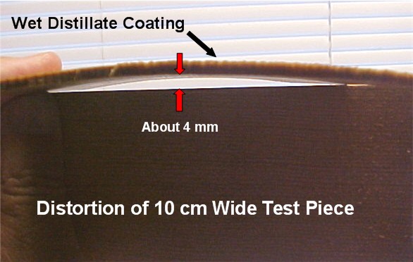

No dimensional change is obvious in the dried test samples although there has been a distinct darkening in colour of the samples (as well as the
distillate). This indicates that there has been some kind of reaction between the alkaline distillate and the wood cells.
Microscopic examination of the end grain of the wood samples was inconclusive in that did not reveal any obvious visible change in cell structure or
dimensions.
Test samples of silver spruce and sitka spruce immersed in an even more alkaline 5% Ammonia solution for 10 days and allowed to dry showed no obvious
dimensional change but both samples and ammonia solutions also had darkened in colour.
This completes the immersion testing.
Next to report on tests with larger samples of Sitka Spruce sound board material coated with egg white foam distillate.
A larger sample of Sitka Spruce, cut 'on the quarter' and scraped smooth, measures about 10 cm wide by 15 cm long by 2 mm thick.
This has been coated with batch #2 foam distillate brushed on like a varnish and allowed to dry for 24 hours followed by clean water brushed on and
Note that the batch #2 distillate for the test has been kept in a sealed container at room temperature for 12 days with no sign of deterioration.
The immediate effect of coating the sample with distillate is that the sample distorts (bows) due to the expansion of the wood cells as they quickly
absorb the distillate. The distortion is significant - about 4 mm over 10 cm. On a sound board, say, 30 cm wide this distortion would amount to 12
mm.
After drying for 24 hours the sample lost its distorted curve and became flat again.
Therefore, for anyone contemplating using egg white foam distillate as a sound board sealer this is something to be taken into account. An oud sound
board is prevented from expanding across its width by the braces glued in place. So any expansion of the wood cells caused by absorption of the
distillated must be temporarily accommodated by compression of the moist wood cell walls until all water has evaporated. If this is done slowly over
24 hours or so (i.e. in relatively high humidity conditions, say 70% RH +), then, perhaps, no permanent damage will result. However, if the drying is
rapid (low humidity conditions, say 40% RH or so) then it is possible that shrinkage cracking may be a destructive consequence in a braced sound
board.
Egg white foam distillate is not the same stuff as raw egg white but the cracking of sound boards coated with raw egg white - as previously reported
by freya - may be due to a similar mechanism?
After the larger test piece had been coated with #2 distillate and allowed to dry a second coating of plain water again caused the test piece to
temporarily distort into a curve before drying flat again after 24 hours.
The large water droplet test was then repeated. After 15 minutes a droplet (about 12 mm across) was blotted with a paper towel. Once any surface
moisture had evaporated there was no visible evidence of the droplet remaining.
A droplet remaining on the surface for 3 hours was again blotted and allowed to dry. The area covered by the droplet became slightly white after
drying.
After 8 hours, a water droplet was reduced in size (due to evaporation) but showed no signs of absorption into the wood surface.
After 24 hours the water droplet had completely evaporated leaving - the now familiar - ring of distillate residue defining the perimeter of the water
droplet.
So, coating the Sitka Spruce sound board sample with egg white foam distillate caused a temporary distortion (bowing) of the sample. After drying for
24 hours the sample became flat again.
Then, after applying a brush coat of plain water, the sample became temporarily distorted but, after drying for 24 hours, the sample again became flat
again.
Interesting in that the distillate coated sample does not allow penetration of water, even after 24 hours exposure, yet the distillate residue coating
the surface of the wood sample - after all water content has evaporated - is itself readily 'soluble' in water.
To follow - I shall try to draw some kind of conclusion from these tests!
It is interesting to note that the bubbles or foam generated by shaking the #2 distillate (left after the immersion tests - previously reported) is
still remains after 4 days - although somewhat reduced in quantity. This confirms that the egg white foam distillate retains the ability to form a
relatively stable foam - the denatured, long chain protein molecules linking together in a network around air bubbles.
How might this interesting property of the distillate account for the apparent water resistance of a sound board material coated with distillate when
the distillate residue - when dried - is 'soluble' in water?

For comparison, the Sitka spruce wood samples were tested in order to determine if the egg white foam distillate is as effective a sealer for varnish
as it is for water.
For the first test a drop of relatively 'thick' (viscous) oil varnish was applied to an untreated wood sample and to one coated with distillate. After
24 hours there was little evidence of any absorption of the varnish in either case - i.e. the varnish remained as a surface coating. The drops when
dried measured about 3 cm. across in each case
A second test was to apply a drop of 'thin' (low viscosity) varnish (Minwax Antique Oil) to the wood samples. The oil finish quickly spread (in a
matter of minutes) across the surface of both samples to cover an area measuring about
7 cm across in each case after the oil had dried. On examination, the oil had been fully absorbed into the wood on the untreated sample (leaving a
dull 'matt' finish) but remained on the surface of the treated sample (glossy, 'varnished finish).
