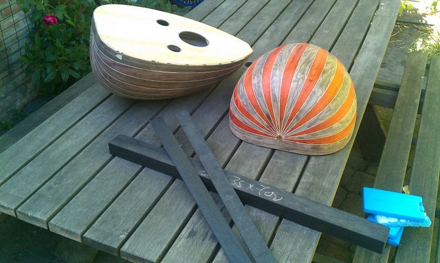

[*] posted on 6-9-2011 at 09:52 AM

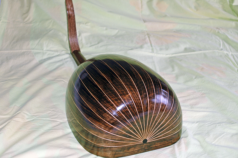

So Far
Sawing ebony ribs from the external purfling around the bow.
the internal strips are black/white/black/white + one wider black ebony
IMAG0062.jpg - 61kB
Best regards, Samir

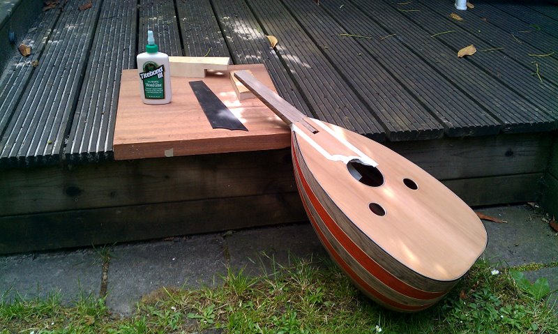

[*] posted on 6-9-2011 at 09:54 AM
Progress
Preparing the ebony fingerbaord to be glued.
for this operation, I now use Titebond III instead of the Original Titebond because it gives mote setting up time to cure.
IMAG0074.jpg - 114kB

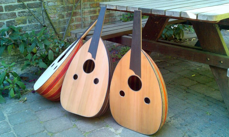

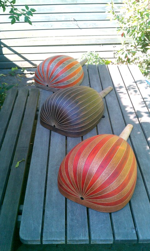

[*] posted on 6-9-2011 at 09:57 AM
almost there
4 ouds are need only the pegbox and bridges to be mounted. A work to be done sometimes next week.
oud number 5 , the (wenge) will be finished later.
IMAG0079-1.jpg - 103kB IMAG0082-1.jpg - 101kB
Best regards, Samir

[*] posted on 6-9-2011 at 10:37 AM
Brilliant work!!!!!!!!!! :bounce:
Why not use hide glue, or even titebond liquid hide glue for the fingerboards? What will you do if you need to remove it? Of course titebond also will release with heat, but it is much more difficult to melt off than hide glue.

[*] posted on 6-9-2011 at 11:37 PM
Hi Edward, Thank you
It is like guitar making, most guitar maker don't use hide glue. it is more for Violin I presume. Also, I'm sure they didn't have Titebond back in the middle ages :).
There no need to remove the fingerboard, everything is checked many times before glueing . neck and body are water flat.
And as you said, with some heat even titebond can be removed in case there is an issue.
I have posted many artciles before with sound boards and bracing details in this forum. sorry didn't make them this time
thanks
Best regards, Samir

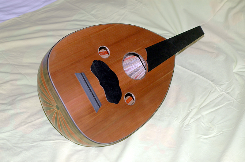

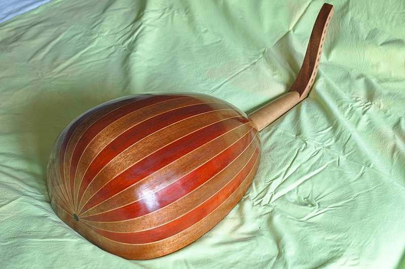

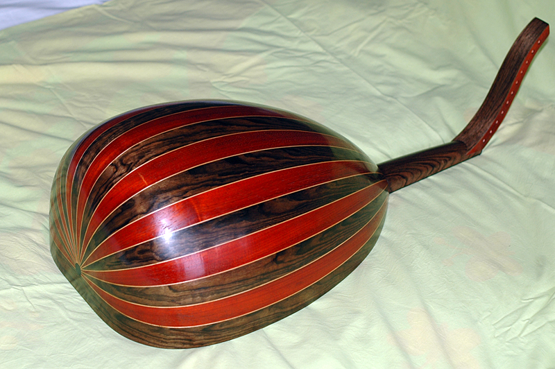

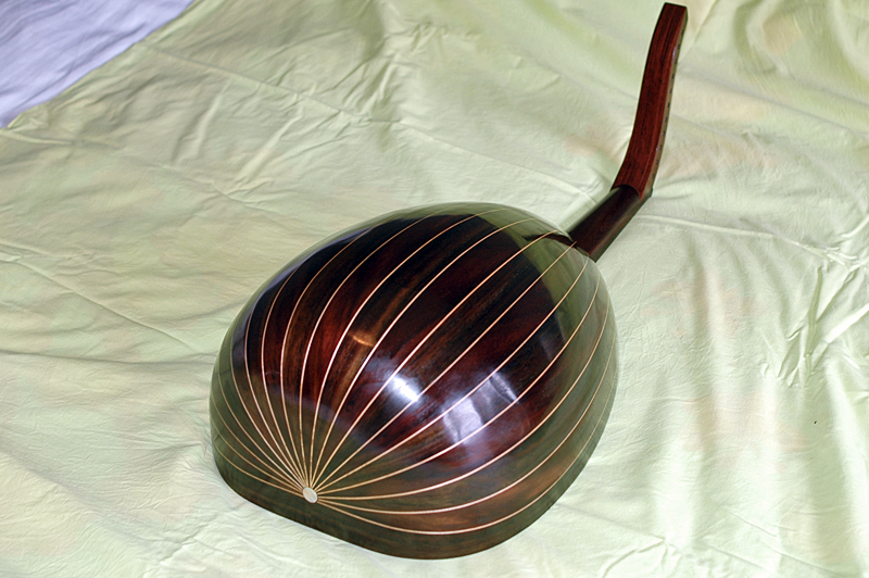

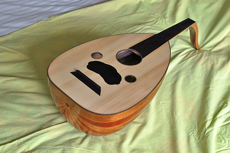

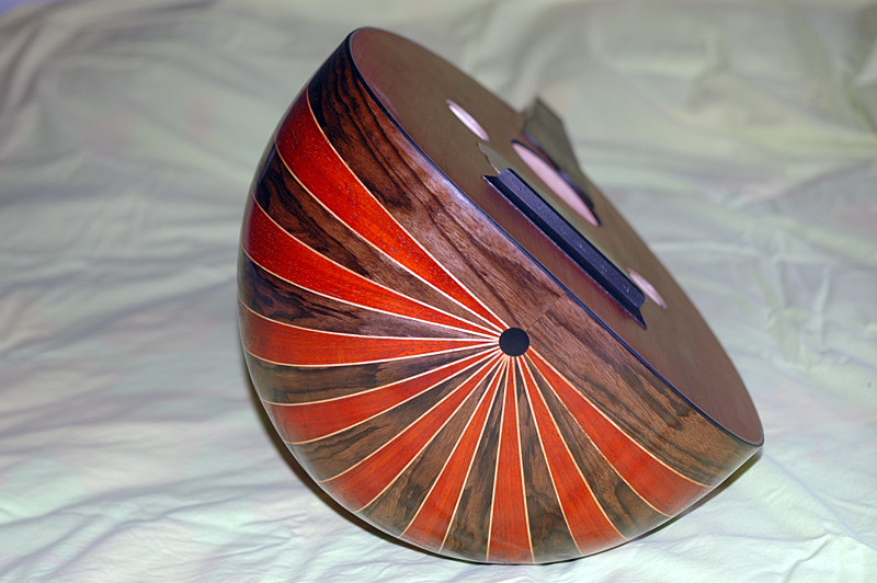

[*] posted on 6-19-2011 at 09:30 AM
Almost there, pegs and strings
Hi Guys,
After a hard working weekend the bridge, nut and the pickguard are placed. the finger boards are flaterned and sanded.
I still need to shape the ebony pegs and place the strings.
th dark ouds are difficult to make pictures of. the Indian rosewood hs mother of pearl dot at the back. the three others are from ebony.
new: the bridge it not at 90 degree as usual, but 5 degree more to the back. the knot of the strings is about 2 mm, this way I want to keep the strings lenght net: 58,5cm exculding the knot.
the bridges are all from walnut, stained black
DSC_9478.jpg - 443kB DSC_9481.jpg - 456kB DSC_9492.jpg - 382kB DSC_9491.jpg - 404kB DSC_9493.jpg - 407kB DSC_9497.jpg - 359kB
Best regards, Samir

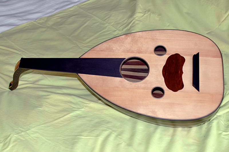

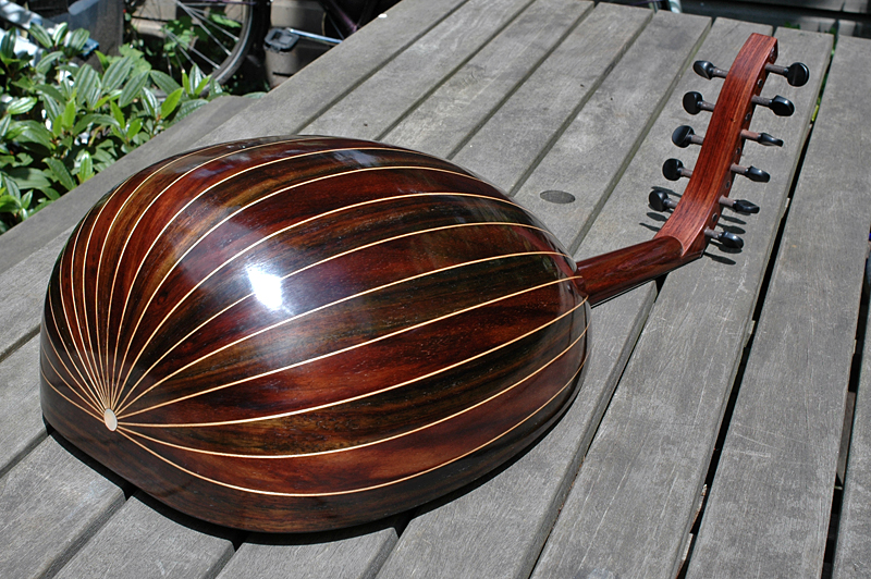

[*] posted on 6-19-2011 at 09:32 AM
more pictures.
enjoy it
DSC_9496.jpg - 406kB DSC_9502.jpg - 350kB DSC_9506.jpg - 384kB DSC_9507.jpg - 428kB DSC_9512.jpg - 415kB

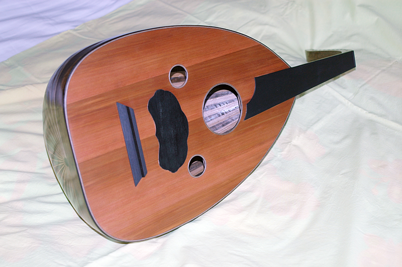

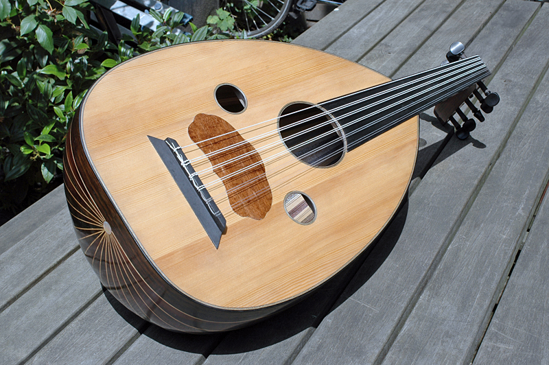

[*] posted on 6-20-2011 at 05:16 AM
Indian Rosewood / aged spruce top
Thank you Dan
First oud is finished.
Strings ust mounted 3 hours ago. Labella strings (Do)
DSC_9523.jpg - 519kB DSC_9519.jpg - 501kB
