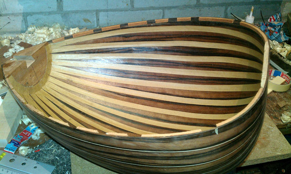

3 bowls
The bowls are finished but before i removed the tape, I use strong paper strips and hot glue to join the ribs inside.

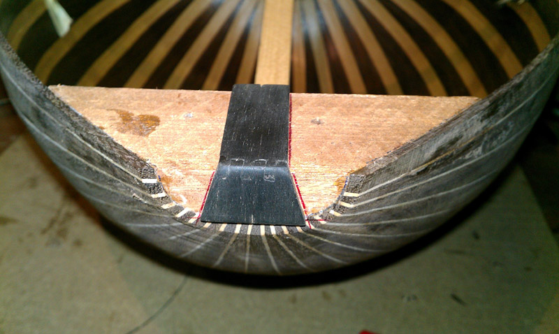

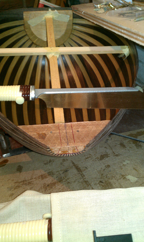

japanese saws
These saw are a must to have. as for any luthier or woodworking lover, they make such clean and easy cuts.
so I use them for the braces, neck opening etc..
I also have made a little jig for the neck opening. as I have mentioned in other posts. the neck front side opening is 1 mm lower than the back side. in this case the neck when mounted will lean forward for the strings actions adjustement. we will get more in detail later on this.
so the neck front side opening is 16mm low , the back side is 15

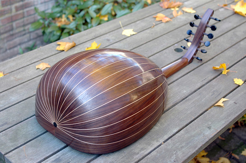

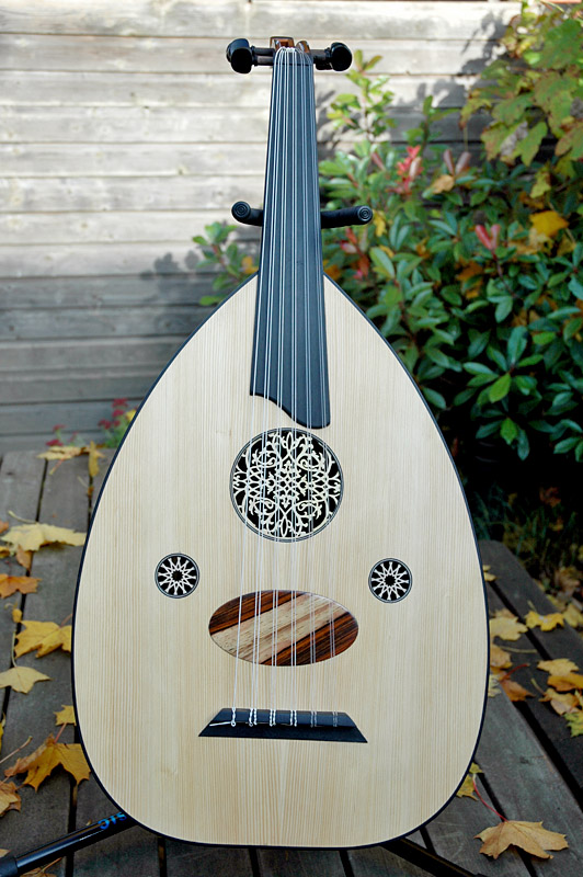

[*] posted on 10-31-2011 at 03:19 AM
indian rosewood
I had to finish the Indian rosewood oud before I go on vaccation for a friend. I will get back to the build process as soon as I come back.
Hand made rosette is from Lemon wood.
here is a picture of the finished oud. destination is Spain.
I will update this project in 3 weeks from now Inchalah
DSC_0936.jpg - 165kB DSC_9751.jpg - 163kB DSC_9767.jpg - 167kB
Best regards, Samir

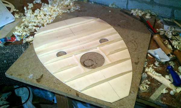

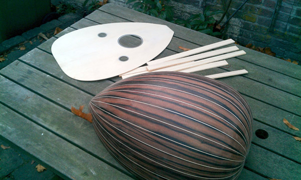

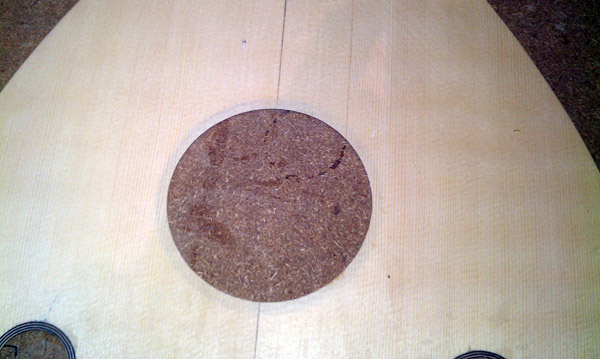

[*] posted on 11-18-2011 at 08:31 AM

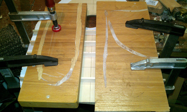

Continuing

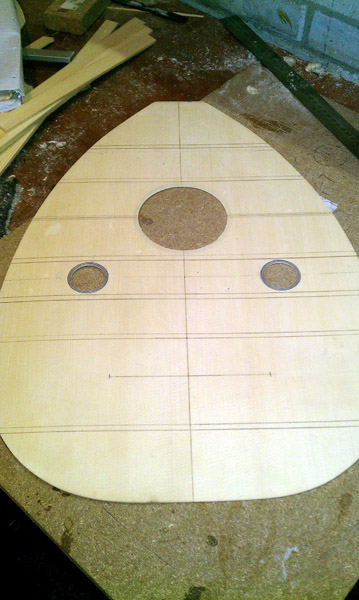

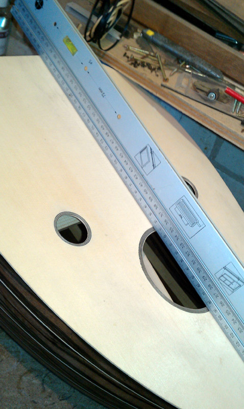

the braces are also from sruce and 4.7mm thick. for now the hight is 18mm for all of them.
the purfling around the big hole is inserted in the facetop (see picture) just like they do for guitar, this way the combination is strong for holding the shamsa later or even when touching the purfling. for the small ones the purfling is arount the holes.
glueing the braces : I prefere to glue the first 4 at the back to make any adjustement and to have a good view. when its dry I go for the next 3.
When all is cured, I down the braces like this, from back to front
a13mm, b16mm, b13mm, d16mm, e15mm f14mm g13mm
the distance between a an b does not exceed 8.9 cmmm
the distance between f g is about 5cm
all this number can be tweaked depending on the stiffness of the top and braces and the size etc..
IMAG0337.jpg - 101kB IMAG0340.jpg - 81kB IMAG0341.jpg - 91kB IMAG0343.jpg - 93kB
Best regards, Samir

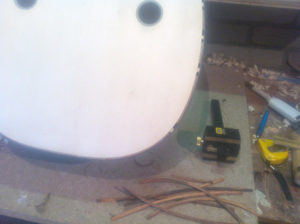

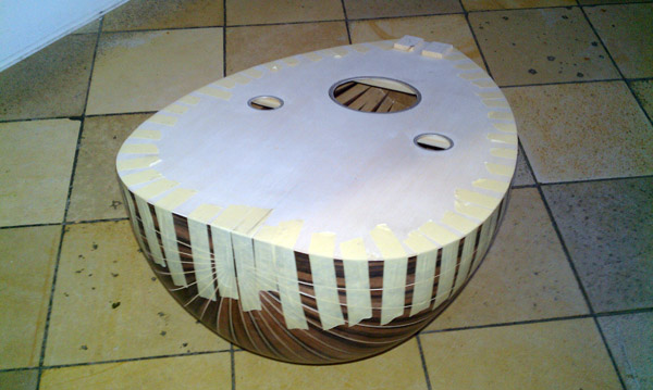

[*] posted on 11-18-2011 at 08:33 AM

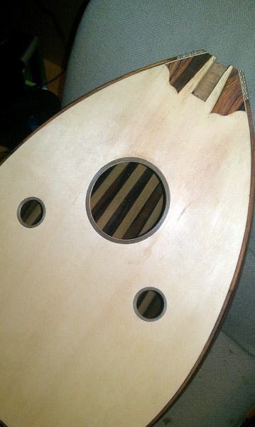

Continuing
Mounting the top on to the body require a purfling around the inside of the bowl.
braces alone glued the the body is not enouph. just like they do with custom guitars. and is turn out to be very good for the sound later.
Cocobolo purfling for around the soundboard and some cocobolo inlay at the front.
IMAG0347.jpg - 131kB IMAG0357.jpg - 114kB IMAG0358.jpg - 81kB IMAG0362.jpg - 74kB neck3.jpg - 110kB
Afbeelding 004.jpg - 62kB
Best regards, Samir

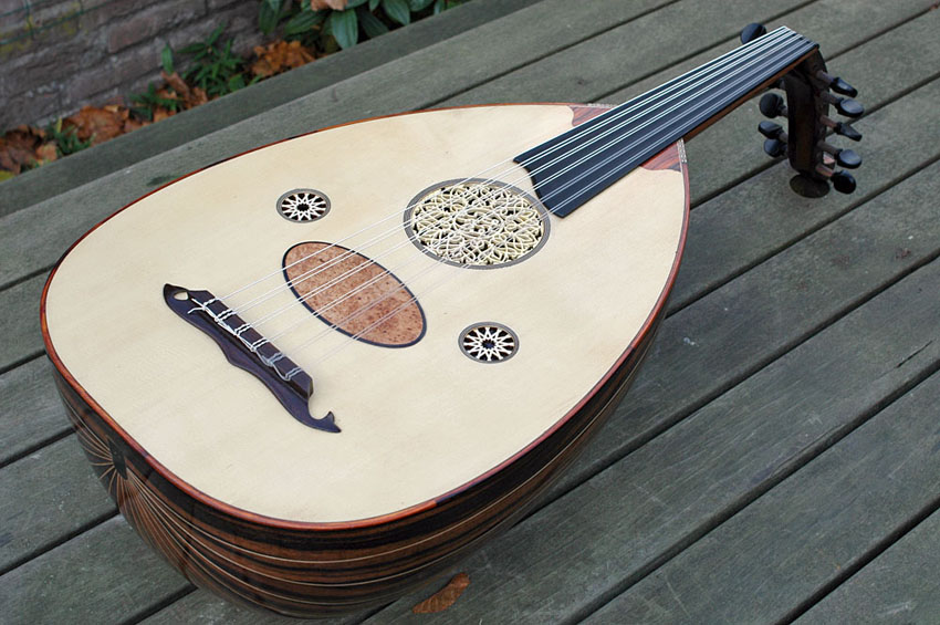

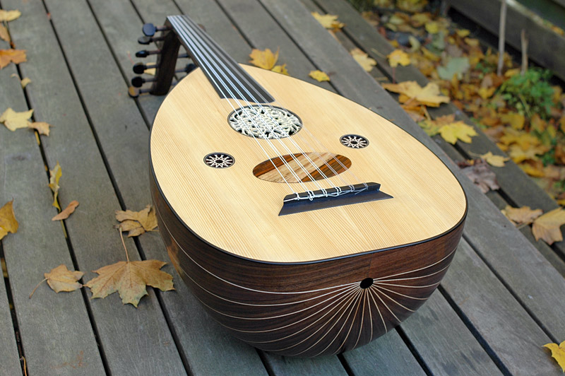

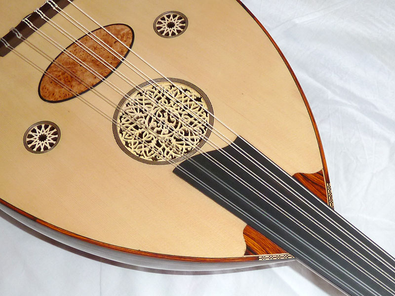

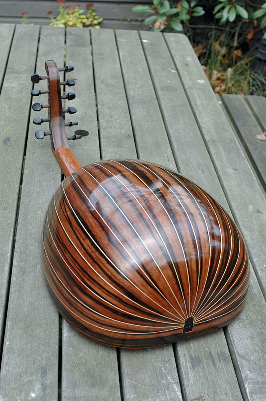

[*] posted on 11-25-2011 at 03:47 AM

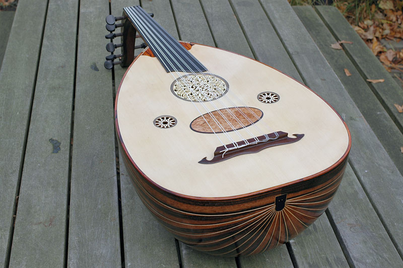

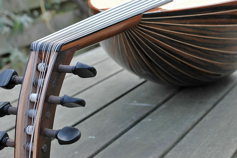

Here are some pictures of the oud
specs:
- Pyramid lute strings CGDAFC
- Hand made rosette with lemon wood. thank you Alfaraby for the design
-Brasilian rosewood bridge
- highly figured root wood with black purfling around
The action is very low and smooth, 100% buzz free at firt use.
I will post a sound file later this week.
macassar 11.jpg - 122kB macassar 10.jpg - 150kB macassar 12.jpg - 139kB macassar 13.jpg - 107kB
macassar 3.jpg - 143kB
Best regards, Samir

[*] posted on 11-25-2011 at 06:45 AM
Thanks Achille, Leon
the motif at the back is a taken from old Moroccan doors. I wanted to give this oud an Andalous style.
Best regards, Samir
