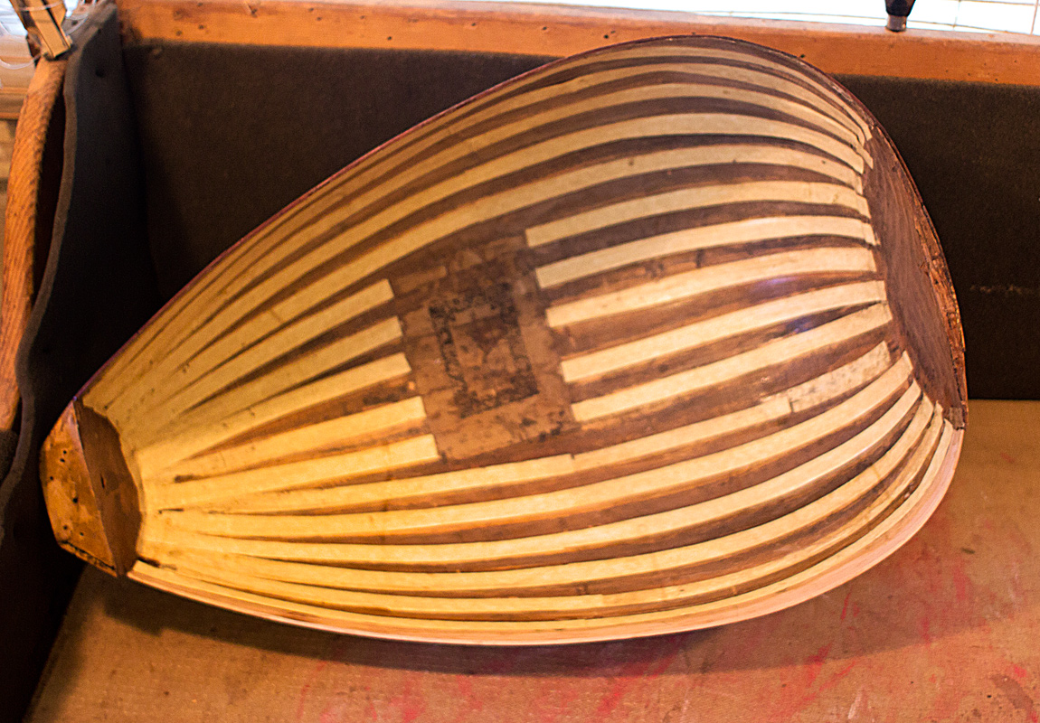

[*] posted on 5-5-2014 at 04:54 PM
I added one rib, patched some holes and have concluded that the body has been stretched out too much. The top surfaces of the neck and tail block are misaligned front to back, and the ribs are turning in at their top edge. The width unclamped is about 14in/35.5cm, not too narrow, but those top edges and the the top surfaces won't do. With the clamp applied to align the top surfaces, it's 15in/38cm not too wide, and the top edges of the ribs are in a better position.
back-unclamped.jpg - 483kB [file]31316[/file]

[*] posted on 5-27-2014 at 03:34 PM
Here's the back together. Some ribs alignment and stain to match yet to be done, but it's together at last. I added 3 ribs, but the top rib ended up rather short just to make it level. The tail block remnant indicates that the original top ribs were pretty slim anyway. I had to trim the neck block down to align with the tail, so this is the result. Not really that unusual for arabic ouds. Oh well.
[file]31585[/file] [file]31587[/file]
