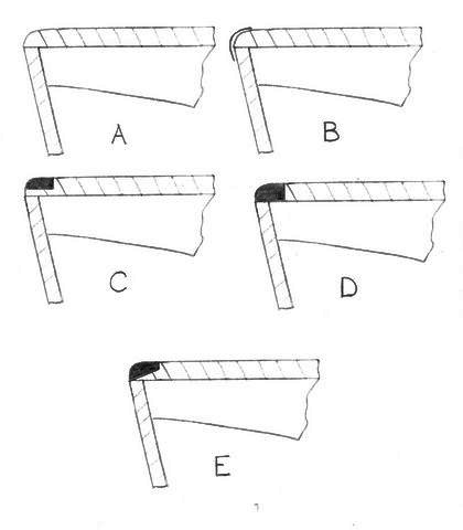

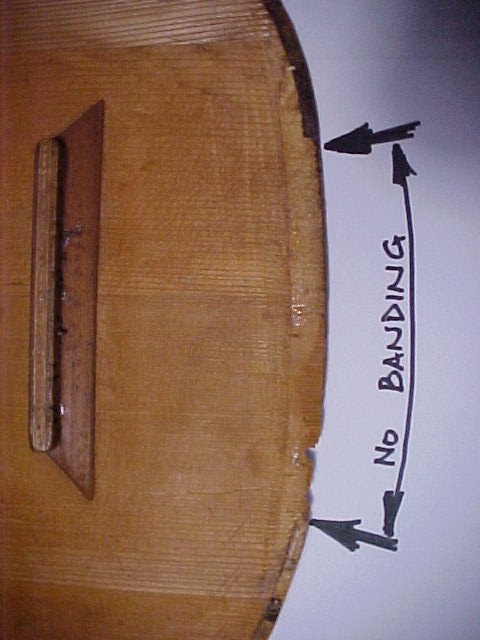

To change direction a bit - there has been some discussion about edge banding styles on the forum over the past year or so. Here are some rough sketches to summarise the situation. The sketches represent sections at the edge of a soundboard and show five banding possibilities. There may be others that I am not aware of.
Banding is not only decorative but reinforces the edge of the soundboard against damage and may also improve the response of a soundboard due to the weakening at the edge due to the banding - just as the edge purfling on the violin family of instruments seems to, for example.
Banding [640x480] dark.jpg - 23kB
[*] posted on 3-1-2008 at 10:33 AM
Sketch A and B, of course, represent soundboards without banding.
A - is to be found on surviving lutes of the 16th C. so, no doubt at one time it was to be found on ouds as well. I have not found the lack of banding to be a disadvantage on a lute as far as edge protection is concerned.
B - here the edge of the soundboard is protected by a thin strip of material glued in place which reinforces the glued joint and helps protect the soundboard edge. This is found on lutes of the late 17th C/ early 18th C - known as a "lace" - and is mentioned by Thomas Mace as being made from thin parchment or silk.

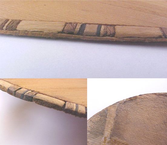

There is some evidence that a type of lace was also used on ouds - at least covering part of the sound board edge.
The attached image shows an old oud soundboard of unknown vintage where the banding does not - for some unknown reason - extend to the lowest part of the soundboard, this area being covered by a narrow strip of 'leather cloth' glued in place (here the cloth strip has been removed). Ronny Andersson has also recently mentioned coming across examples of this type of edge reinforcement.
Oud no Banding.JPG - 60kB

C - here banding is glued into a shallow rebate cut around the edge of the soundboard. This type of banding arrangement can be found on surviving lutes of the late 16th C and 17th C. - usually the rebate is cut to half the thickness of the soundboards or about 0.8 mm.
Dincer Dalkilic recently commented that he uses this method of banding and that it was traditionally used by some of the old oud makers. The depth of the banding can be half the thickness of the soundboard - like a lute - or cut to almost the full thickness of the soundboard so that the banding appears to be full depth.
The attached image of an old oud soundboard is an example.
D - here the edge of the soundboard is completely cut away to receive the banding which is the same thickness as the soundboard. A method used by Richard, Jameel and, no doubt, many other makers today. Was this method used by oud makers before, say, the 20th C?
F- this is mentioned by Jameel as being used by one maker (if I have interpreted Jameel's description correctly) - so may be a unique modern application?
Note that for examples C, D and E it may be impossible to determine - from an external examination alone, without removing a section of banding - which method is being used.
Old Oud Edge Banding [640x480].jpg - 34kB

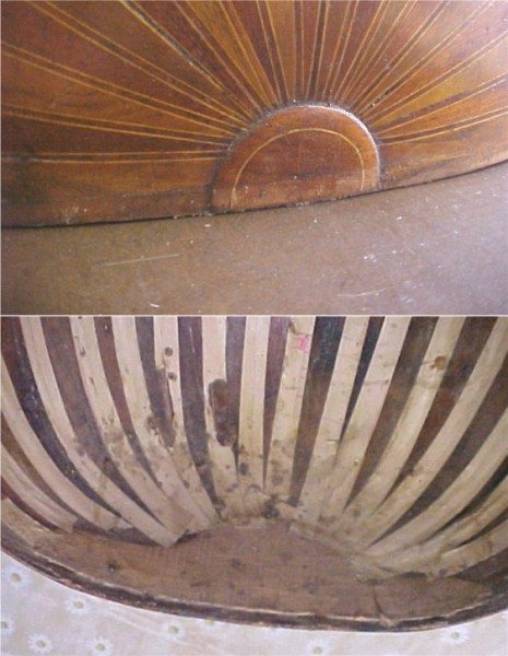

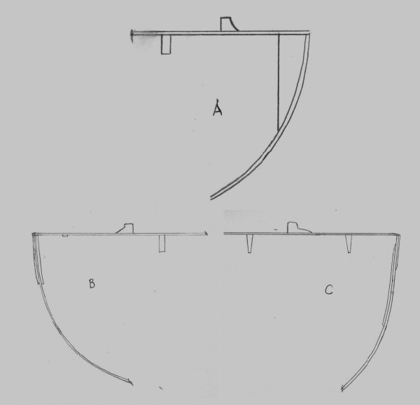

Turning now to the oud 'tail block' - this is the block or plate to which the ribs are attached at the bottom or tail of the bowl usually made from pine or other resinous soft wood. There would appear to be two possibilities which, because they occur in early lutes, are an indication that they were likely also used in early oud construction.
The attached images are some rough sketches - more or less to scale - showing vertical sections through the tail end of oud and lute bowls and including the bridge and first bar above the bridge.
Sketch A - is the familiar Arnault de Zwolle lute of the 15th C which has a fairly massive tail block. The tail block forms part of the construction mold to which it is temporarily attached. This form of construction is found in late 19th C ouds and is used today - although the thickness of the block is usually, proportionally, about half that of the de Zwolle lute.
Sketch B - is a section through an early 17th C lute. There is no tail block. Instead, the bottom of the bowl is reinforced, on the inside, with a fairly shallow, thin strip of wood glued in place - the end plate. The end plate extends over most of the circumference of the bottom of the bowl. Further reinforcement is also provided with an 'end cap', glued to the outside of the bowl - covering approximately the same area as the end plate. The end plate does not form part of the mold but is fitted and glued in place after the bowl has been removed from the mold. The thickness of end plate and cap is typically about 1.5 to 2 mm.
Sketch C - for comparison, shows the construction of an old oud that I own - of unknown vintage - which has a lute like end plate that appears to have been glued in place after the bowl had been removed from the mold. There is a semicircular end cap glued to the outside of the bowl. This cap is primarily decorative.
Tail Block comp 2 (600 x 579).jpg - 18kB
[*] posted on 3-19-2008 at 01:42 PM
The attached images show the oud end plate and cap represented by sketch C. The end plate is about 2 mm maximum thickness (tapered at the ends), 72 mm maximum depth and about 240 mm in length. Note that - unlike on a lute - the end plate does not extend to the top edge of the bowl so is not glued to the soundboard.
The semicircular cap is 30 mm in diameter.
Oud end cap comp (465 x 600).jpg - 69kB
[*] posted on 3-19-2008 at 01:46 PM
Just for comparison, the end cap on this replica of an early 16th C lute is 45 mm maximum depth.
Lute end cap.jpg - 60kB

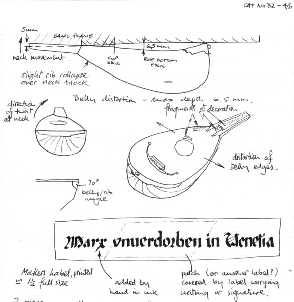

During 1980, while living in Scotland, I had the opportunity to examine in detail a number of early instruments in the Charles van Raalte collection at Dean Castle, Kilmarnock. Instrument cat#32 in the collection is a 16th C ivory lute by renowned luthier Marx Unverdorben. Although converted to a lute-guitar during the 19th C, the bowl and neck of the lute would appear to be original. The instrument is unusual in having a relatively narrow neck - of oud like proportions - and ribs decorated with an 'arabesque' design in gold leaf.
Unverdorben Lute (464 x 600).jpg - 60kB
[*] posted on 3-29-2008 at 06:04 PM
Some distortion of the bowl and soundboard were recorded in my notes and sketches taken at the time the instrument was examined. In particular, there was a noticeable 'dip' in the soundboard - amounting to about 6.5 mm at the bottom edge of the rose - measured from a straight edge laid across the belly. At the time, this 'dip' was assumed to be due to distortion over time.
However, in "Historical Lute Construction", Robert Lundberg notes that this 'dip' is to be found in many surviving original lutes and was intentional - the edges of the bowl being 'scooped' to cause the soundboard to deflect downwards when glued in place - the maximum deflection occurring at the lower edge of the rose. Richard Hankey (DR. Oud) in "The Oud Construction and Repair" also mentions this as a feature of oud construction.
scan0017 (585 x 600).jpg - 71kB

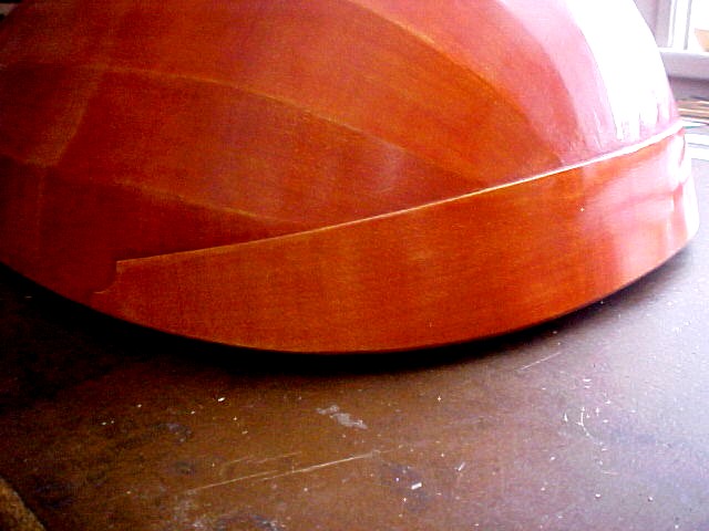

Recently, I was taking hard time figuring out, what is going on with "paper strips method", and trying to reproduce it working to some of my work. Every time when gluing lute ribs I found it difficult to have the edges of two ribs being joined perfectly levelled to each other along the lenght of the joint (gluing line). These were very small unevenness, but hard to overcome even with stretching sellotape across the joint, or with putting gently barrel pins at an angle along the joint line.
What I understood from this topic, is that those paper strips are literally "pinched" to the one rib, then the iron is rolled immidiately to the second rib, putting the jointline as level, as it can be, and it "'pinchs" the strip to the second rib, holdig them together. Am I right? Please, corrct me, if I got it wrong.
But what I got, it was paper strips glued every time to the sole of my iron, not to ribs even...
Please, help :)
[*] posted on 2-28-2017 at 06:56 PM
You will find details of an oud bowl being built step by step using this technique here, posts starting at 6-2-2009
http://www.mikeouds.com/messageboard/viewthread.php?tid=8488&pa...
Use heavy gauge paper and do not soak the paper, just apply glue to one side of the paper and allow to dry partially to identify grain direction - otherwise soaking wet paper will tear and stick to the iron!
antekboodzik
Posts: 109
Registered: 5-24-2010
Location: north poland
[*] posted on 3-1-2017 at 02:57 AM
Shall I wait some time for every strip to be set or proceed one by one, gluing and "patching" whole lenght of the joint at once?
[*] posted on 3-1-2017 at 06:05 AM
As mentioned in the link - apply hot hide glue along the rib joint and glue the end of the rib to the neck block first. When working with hide glue the glue will quickly gel so must be reactivated bit by bit as you work using a hot iron (it is the same situation when gluing a sound board in place). Once the end of the rib is fixed to the neck block - as indicated in the thread - move along the rib joint bit by bit. Re-melt a short length of glue in the joint, press the joint firmly together and hold in place with paper strip 'scorched' in place. Once the paper is scorched in place it is already set and does not need to dry further so move on right away until the whole rib joint is completed (it takes just a minute or two) - covered in paper strips along the whole length of the joint. The paper strips remain in position - covering the bowl outer surface as temporary reinforcement when handling - until the finished bowl is removed from the mold and the usual internal paper strip reinforcement is glued in place.
Of course all ribs must be well fitted together and on the mold so that no forcing is required.
