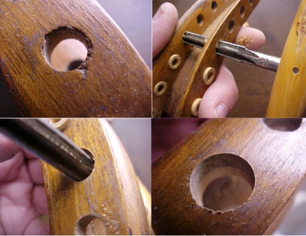

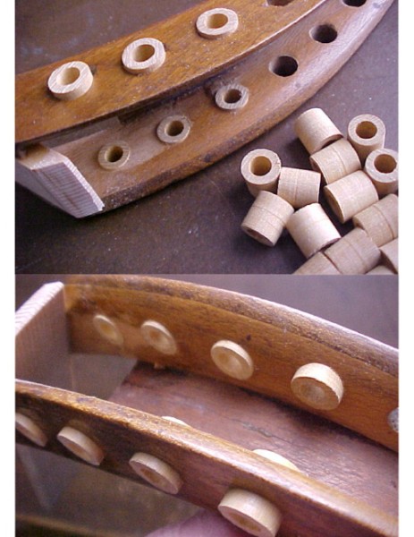

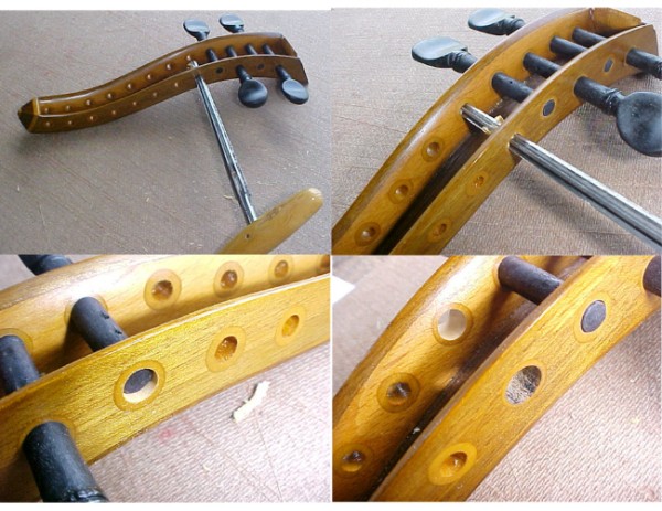

Today I prepared a batch of boxwood bushings using a 3/8 inch Lee Valley taper plug cutter. The bushings were pre drilled to minimum diameter of my
peg reamer.
The pegholes in the pegbox were reamed out to almost the maximum diameter of the peg reamer - first from one side then the other - keeping the reamer
aligned concentrically with the opposite peg hole throughout. Each bushing was precisely fitted to protrude a little on each side of the pegbox sides
- for trimming to size later.
Use of bushings helps to remove much of the damaged, splintered wood around the original pegholes.
The attached images show initial progress in fitting the bushings. The bushings protrude a little on each side ready for later trimming flush with the
sides of the pegbox but at this stage have not been glued in place.
To stabilise the pegbox assembly during the reaming operation the original damaged pegbox backplate (due to be replaced) remains in position (with
open cracks temporarily re-glued where necessary) and the new pegbox endblock - as yet untrimmed to final size - has been glued in place.

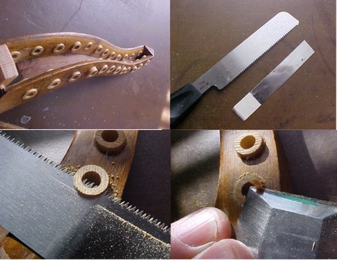

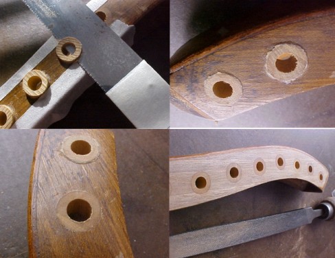

All of the boxwood bushings are now glued in place ready for trimming. As the bushings are cut on end grain, I first trimmed away excess material from
the bushings using a saw.
I first tried using a Japanese style flush cutting saw (used on the pull stroke) which has the teeth set on one side only to prevent cutting the
pegbox sides (Lee Valley Tools cat# 05K34.01). This worked fairly well but tended to 'ride up' in the cut leaving more material to trim away with a
chisel than I wanted.
The remaining material was then cut away with a paring chisel (lapped perfectly flat on one side) until flush with the sides of the pegbox.
I then tried using an XActo razor saw with the metal backing strip removed. The saw blade is only 8 thousands of an inch thick with very fine teeth so
was used on the pull stroke. Masking tape was wrapped around one end as a temporary protective grip. Strips of masking tape were positioned on either
side of the bushing to be cut to protect the sides of the pegbox from being scratched by the saw teeth. This worked quite well leaving minimal
material to be pared away with the chisel.

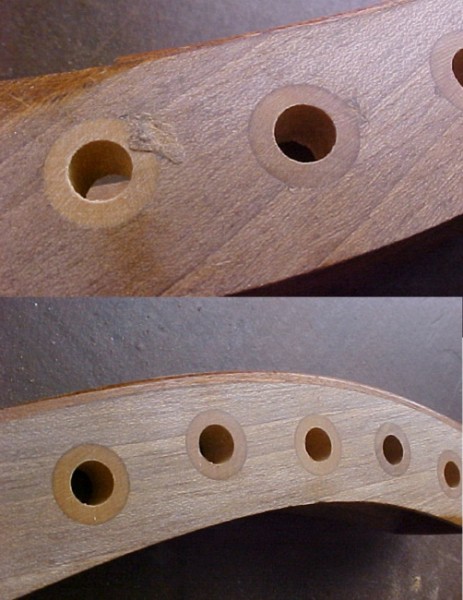

Then the sides of the pegbox were filed (using a flat, medium cut machinists file) to remove most of the old scars, undulations and other
irregularities as a preliminary to final finishing later.
The bushings were not large enough in diameter to cover the original splintering around two of the pegholes so the remaining damage was filled with a
touch of glue mixed with the sawdust from filing the pegbox sides. The filler will dressed flush with the pegbox sides once the glue has fully
hardened.
This is the outside of the pegbox after filing.

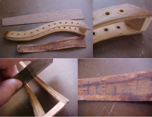

The next stage will be to trim the bushings in side the pegbox. As the damaged pegbox backplate is to be replaced, the bushings will be trimmed once
the the old backplate has been removed allowing easier access.
Reaming of the bushings and fitting the pegs will be undertaken once the new backplate has been installed.
Moving on to prepare the new pegbox backplate.

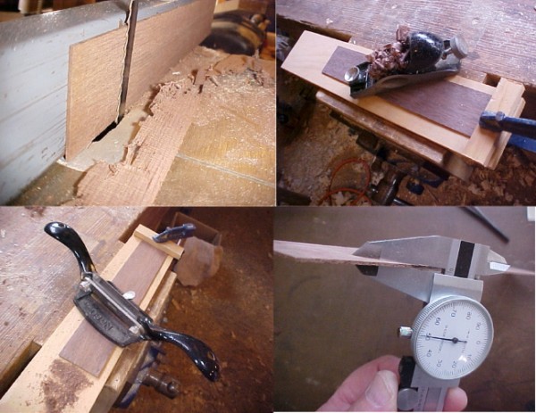

The blank for the backplate has been cut from a piece of 19th C American walnut on my bandsaw - a 14 inch Rockwell Delta fitted with a 'Viking' 1/2
inch blade, 3 teeth per inch (Lee Valley Tools cat #02j04.93 - no I am not a shareholder, they just sell good quality product!). This is the only
power saw that I have in my workshop and is used for all of my woodworking projects. It is set up so that I can accurately cut veneer to less than 1mm
in thickness - up to 6 inches wide, if I want. One of the most important factors in setting up a bandsaw is correct blade tension. If blade tension is
too low the blade tends to bend backwards under pressure of the cut and will distort causing the blade to 'run out'. The blade tensioner on my bandsaw
is theoretically calibrated to handle up to a 3/4 inch wide blade but - at that setting - the tension is far too low (the wider the blade the higher
the tension required). I have found that with the blade tensioner set to maximum a quality 1/2 inch blade is just about the widest that the machine
can handle.
The blank shown in this image is hand planed on one face before sawing, and is just over 1/16 inch (1.5 mm) thick.
The saw marks are then removed by hand planing. I use a small block plane with an adjustable throat finely set. The blank is clamped first at one end
to a flat pine board, planed, and then reversed and planed in the other direction to complete the process. The blank is then finished with a cabinet
scraper to remove any planing marks and reduce the blank to the required thickness.
A cabinet scraper does not actually 'scrape' but planes a very fine shaving. In this type of scraper the blade is first ground and honed to a bevel -
like the blade of a hand plane. The edge of the sharpened blade is then burnished or polished with a hard steel rod. This turns the razor sharp edge
of the blade into a hook shape which is the shape required for the cabinet scraper to function efficiently.
Measuring the thickness of the completed blank I find that it measures only 50 thousands of an inch whereas the original measures 73 thousands of an
inch. So - I must repeat this operation and prepare another blank of the correct thickness. Not a problem - I do not make instruments for a living!
The old damaged pegbox backplate was removed by brushing hot water along the glue joint inside the pegbox and using a hot iron to soften the glue. The
surface of the backplate inside the pegbox had no varnish finish so the water quickly soaked into the joint. Transverse burn marks were in evidence on
the backplate.
With the backplate removed the interior of the pegbox was cleaned up, bushings smoothed over with a file and the new end block trimmed to size all in
preparation for final finishing.
All old glue was removed from the backplate glue joint with a stiff cabinet scraper blade. This also levelled any irregularities in the joint.
Removal of all of the old glue is an important part of preparing the joint.

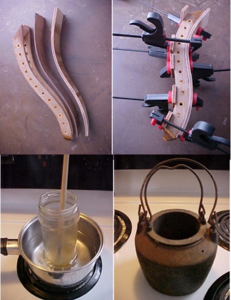

The walnut backplate and matching glue caul in 1/4 inch thick plywood have been bent to shape on the bending iron. Here they are being tested for
correct fit - a dry run before gluing - using some small fast action clamps picked up at the local dollar store (thank you China!). I shall need to
make a few minor adjustments for a perfect fit.
The backplate will be glued in place with hide glue. Hide glue is the most versatile of glues and should be used for instrument construction and
repair wherever possible. It is relatively cheap, non toxic, has an infinite shelf life in its dry granular form if stored properly, it can be strong
with short 'grab time' but can be diluted to vary strength and set time as required, it can be remelted with heat and humidity and it does not stain
wood. It is commonly available in two strengths a very strong brown coloured 'granular hide glue' with fast grab time and a purer, clearer 'pearl
hide' glue that is weaker with slower set time. I prefer to use the latter where appropriate.
The glue granules after being just covered in water and allowed to soak overnight are then heated and stirred to melt the glue using a water bath to
keep the temperature of the glue below 140 F. Above that temperature the glue will spoil.
When I attended general woodworking classes at school in the early 1950's we used only hide glue heated in cast iron, water jacketted, glue pots -
the pots being kept bubbling away all day so that glue was always ready when needed. I still have a couple of these that I keep as souvenirs of times
past. Today, I simply put the glue in a small clean glass jar - only as much as I need for the work in hand - and put the jar in a saucepan of boiling
water on the stove to melt the glue. I do not bother to check the glue temperature - I suppose that I should but life can get too unnecessarily
complicated. Once made up, the glue will not keep for more than a week so I just make up a fresh batch when needed and throw out the old stuff.

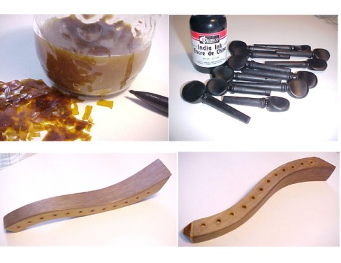

I prepared the shellack by covering orange shellack flakes with about three times their volume of methyl alcohol in a 'mason' jar with a sealed lid
(to prevent evaporation of the fluid). This mixture was allowed to stand for two or three days until all of the flakes had dissolved. The white
sediment (impurities) at the bottom of the jar was discarded by decanting the clear shellac through a cloth filter.
The orange coloured shellack is good for coating dark woods and providing an 'antique' finish that hopefully will match the original finish of the
oud. The shellack is used very dilute so can be applied with a brush but many coats will be required - I am in no hurry! Normally, brush application
of coloured varnishes is difficult and requires a lot of experience to achieve a consistent finish. Using the orange shellack at high dilution -
although fast drying - avoids this difficulty. I will apply one coat each day - to ensure each coat is fully dried - with very light sanding between
each coat - sufficient only to remove any dust particles or other imperfections.

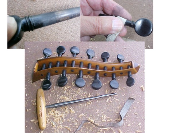

Once the shellacking is complete I shall fit the pegs. The original pegs have been refinished with a penetrating black stain. In common with other
luthiers like Jameel and Richard I prefer to use India ink - readily available from office supply stores. This ink is made from lamp black which
provides a dense opaque finish unlike stains made from analine dyes that tend to be translucent and show the wood grain. The peg heads will be further
sealed with a shellack coating.
Both the shellacking and peg fitting operations will be carried out with the pegbox detached from the oud for convenience and ease of handling.

The final stage in this part of the restoration is the fitting of the pegs. This was done with the pegbox still detached from the neck for
convenience.
Using a violin peg reamer the bushings were carefully reamed out to size - ensuring that the reamer was kept in true alignment with both bushing
holes.
In this case the reamed hole at the tail end of the peg was found to be slightly oversize (possibly due to the way the blade of the peg cutter was
set) - but this is what I want anyway. The objective here is to make the fit of the peg at the peg head end slightly tighter than at the tail end of
the peg in order to minimise any twisting force along the peg shank that could cause destructive damage to the peg. The best fit is judged from the
markings in the bores of the bushings (left by the staining of the peg) which should be heavier at the peghead side than at the tail of the peg. The
refurbished original pegs - of rather poor quality - are of softer material than the pegbox, so will bed in faster. To achieve this fit the peg holes
were reamed until the peg had entered the bushing at the narrow end about half way and then the burnished section (the shiny bit) at the peg head end
was - little by little - carefully reduced by rubbing with a strip of fine emery cloth until the best fit was achieved.
Once all pegs have been fully 'bedded in', the pegs will be finally trimmed evenly at the tail end and the cut surfaces restained.
One of the pegs at the tail end of the pegbox was found to have been previously damaged by twisting of the wood fibres. This was repaired with a
couple of drops of "super glue" that were allowed to soak into the damaged area consolidating the fibres and bringing the peg back to full strength.
I should mention that the reaming of the pegholes should take place after the sides of the pegbox have been varnished as the varnish that soaks into
the bores of the bushings is then removed during the reaming operation.
