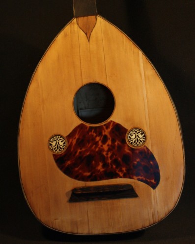

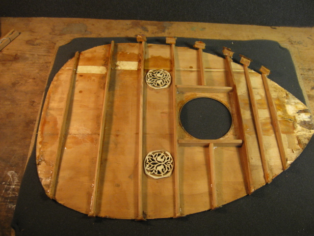

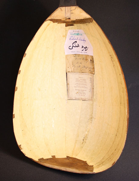

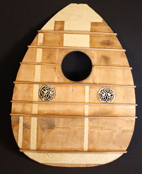

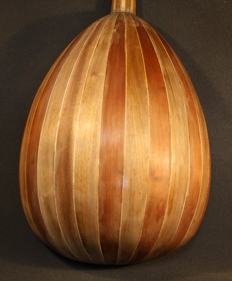

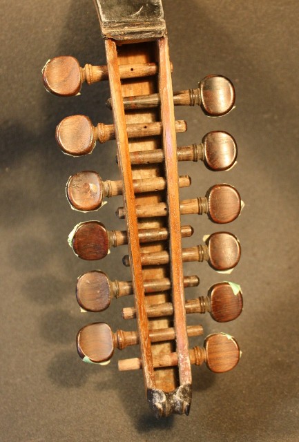

Update -the Mission Improbable Mazloumi is back on the bench. Closer inspection showed that the braces were wrong - too thick, too many, and one directly under the bridge. I removed them and installed braces of the Manol design. Because it was post card thin, the back was lined entirely with parchment paper (pure cellulose fiber infused with hide glue). The neck was removed (tenon sawed through) and re-set (with a dowel). The flat grained pine patch in the face was replaced with a vertical grain piece of old spruce. A tortoise shell replica plastic pickguard was installed. Some corner kerfs were added at the bottom bout corners to support damaged areas, as face there is about 1/2 mm thick. The back is complete and the old finish removed. As I was about to string it up, I realized that the pegs were installed for a left hand player. The peg holes had been filled with bushings, so it may have been originally right handed anyway. The brace design is compensated for standard stringing, and the owner is a right hand player, so the pegs will be restored to a standard configuration.
The pictures show the bare back, previous braces, the new brace design, the inside liner, the front, and the pegbox.
previous braces.JPG - 179kB New Braces.jpg - 81kB Inner Liner.jpg - 61kB
bare back.jpg - 75kB pegs1.jpg - 83kB
face complete.jpg - 44kB

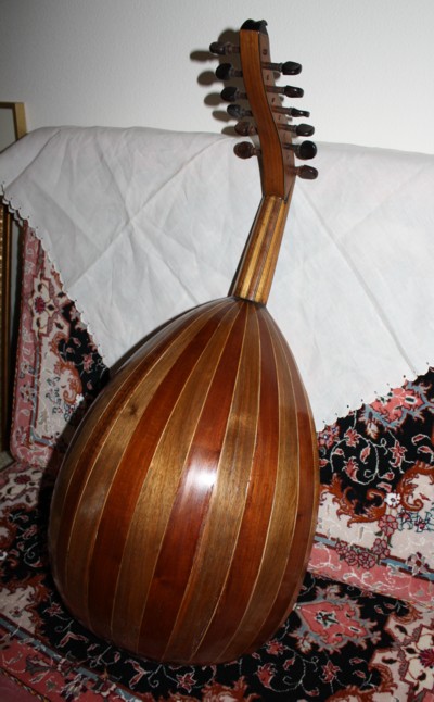

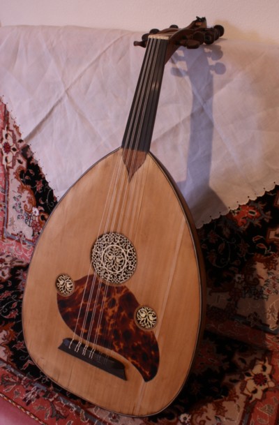

finally, but it was worth it. This oud has a lot of character and class. Who has an oud from Paris, France? Yea, there's an audio/video file..
Restored front.jpg - 73kB Restored back.jpg - 84kB
