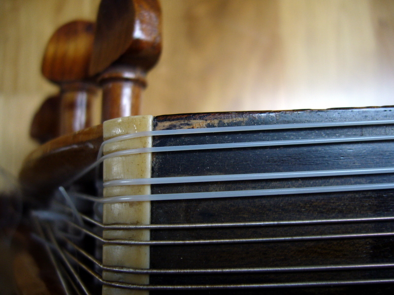

[*] posted on 11-22-2009 at 04:24 PM
You know your fingerboard needs sanding/leveling when the tracks are deep enough so a train pulls up at Rast and people line up with tickets for Neva. A lot of older ouds have trenches like during World War I. No, seriously, it's when the ruts interfere with playing. David's was sanded twice in 8 years? My approach is to never let the ruts develop in the first place, let a coating absorb the damage. For the ebony, play for a while and watch it. If, after a couple months, you see even the kind of "snakeskin trace" appear as in my photograph, I would coat it. The coating adds sustain and brightness, but obviously not if your fingerboard is already very hard. Brazilian Walnut is not really walnut. The ordinary walnuts are all about the same: medium.
Coating the first time with Tung Oil does take the oud out of service for 2-4 days, as you have to put on several coats and the initial coats take like 24+ hours to set hard. You want 4-5+ coats, the first one soaks in like an oil, then you keep painting it on like wall paint and it sets like a urethane. Fortunately the final coats seem to be catalyzed by the first, so they set faster. Then lightly sand to "perfect" aircraft-carrier flatness with a little board. Touch-ups can be just wiped on, when you change strings, or if necessary, sooner. Do not play it while "sticky", it's the strangest substance, nothing seems to dissolve it, and I think if you inject it, it will turn a mammal into an Egyptian mummy that walks in the moonlight.

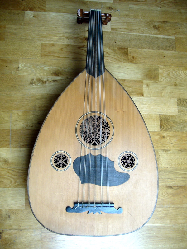

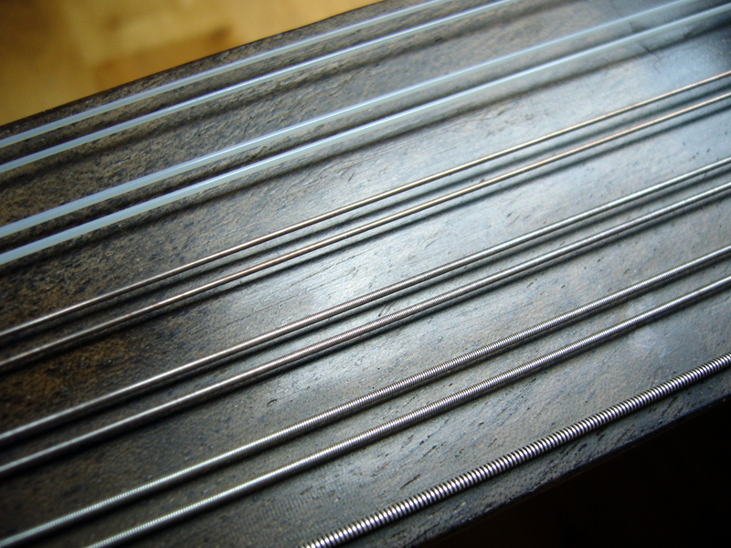

I got a turkish oud as a birthday gift from my parents almost 20 years ago. It took a long time to figure out how to tune and play it. (There was no source like the internet in those days)
It's a very cheap instrument I guess, made for tourists probably, but it had a sound, that caught my heart immediately every time I played it.

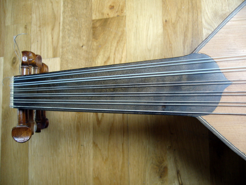

In lack of money to buy a better one I decided to coat the fretboard a few years ago, because I had a little amount of polyurethane resin left from making my own pickups for the fretless bass.
The board looked like a road laced with chuckholes and some notes really didn't sound well.
So I sanded down the board of the oud as far as possible - not much, because I soon recognized, that the wood isn't originally dark but was dyed or just a very thin piece of veneer.
Then I isolated the borders with some tape and applied 3 or 4 relatively thick coatings of the resin, each one after the preceding was dry.
Stripped of the tape and sanded and polished again. I have to say once more, that there were really deep holes on the board, so the resin did not only coat, but levelled out the whole thing.
Then I bought a set of good Aquila Nylguts...
Man, this was a surprise!
My oud really sounds good know.
A few days ago I visited an oud player from Iraq, who lives nearby, and he said, that my oud is a very good sounding student model, even the construction and the woods aren't of high quality. (Let's say: Simply bad... ;) )
I can't play very good, but I will upload some soundfiles in the future.
Of course I still wish I could buy a better oud, but even this "not so good" instrument makes my heart wide open, when I play it and lets my soul fly, where no other instrument can get me. It's like a deep meditation, an instant generator of feeling grateful, delighted, peaceful and free.
Thank you all for making this forum possible and for all the helpful information.
P1060083-1.JPG - 275kB P1060084-1.JPG - 279kB P1060085-1.JPG - 300kB P1060086-1.JPG - 243kB

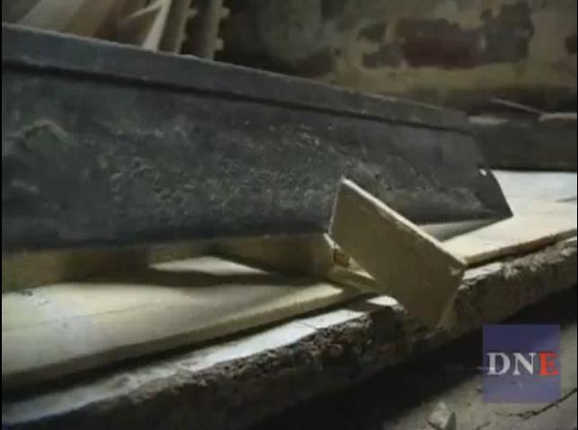

[*] posted on 3-15-2010 at 04:33 AM

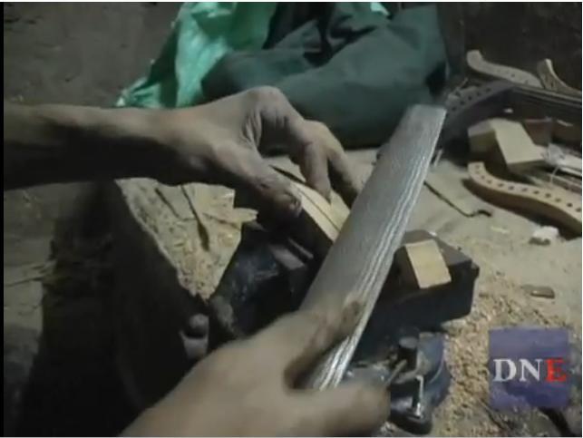

So happy for you that you figured out how to make the best of it. I believe that all the emotion you put into it is also important, not clear exactly how it works, but it seems the more you play an oud and the more heart you put into it, the better it sounds.
It doesn't look like a bad oud anyway. Most Middle Eastern ouds are more "earthy" than glitzy Japanese production line guitars. Let's face it, the tools in common use are simple, as you can see in these shots from Egypt.
People I think often attach too much importance to a fine finish. A beautifully finished oud IS surely a beautiful thing, but it's not necessarily going to sound and play better for all that detailing. You could spend a lot more money, and how it sounds and feels might still be a toss of the die. Try to play some other ouds and you might decide you like yours all the more!

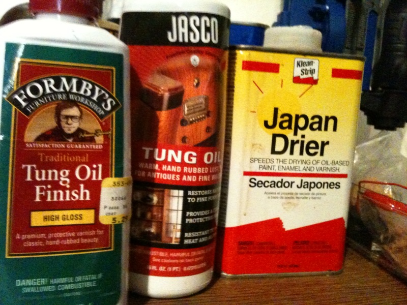

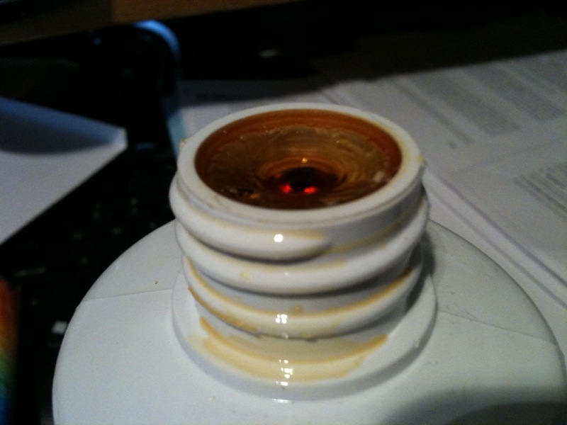

I had originally wasted a lot of time describing some of the very complex internals. It's very confusing, largely because manufacturers promote nonsense like "nourishing the wood". The wood of course is DEAD and needs no "nourishing". And as to "Natural" finishes, nothing is more "Natural" than Hemlock and Death.
Bottom line: Tung Oil is probably best used in a mix like Formby's that includes catalysts and resins, because it sets hard and quickly (overnight). Several layers can be wiped on in a couple of days. The closer you get to pure Tung Oil the longer it takes to set and the more difficult it is to produce a thick protective layer. Jasco has more Tung oil and takes longer (days) to set, you have to add some Japan Drier as a catalyst. I don't know what people do with "pure Tung Oil", be it partly polymerized or not.
http://www.amazon.com/Minwax-30064-Formbys-Tung-Finish/dp/B000BZZ4Z...

On the Formby's I used the high gloss. That's what I purchased and it was a fast setting product that was reasonably hard and worked OK. But I hope you understand that we're in very murky waters, right? That what is called "Tung Oil" is a mix and that to really know what brand contains how much resins and how much polyurethane and how much boiled Tung Oil and how much boiled Linseed oil, and how much Japan Drier and so on --- is beyond our capabilities. Maybe the Formby's "low gloss" would have more Tung oil and would set slower but be harder? I don't know. I was to call them but was briefly in hospital. Will try to quiz them tomorrow.

Ok, I just spoke to the labs where they formulate this Formby's "finish". They were reasonably cooperative, but this is a complex area in which I don't know how best to formulate the questions. Every nook you peek into requires learning more! They will be faxing me some materials safety sheets that might reveal some other details. Here is what I learned so far.
The solution is primarily (~ 78%) hydrocarbons (that will evaporate and help the solution penetrate the wood). The rest is an "oil alkyd varnish" consisting mainly of Tung and Soybean oils. Zero polyurethane. That's as far as they were willing to go, as it's a proprietary formula. I asked if the finish sets primarily by polymerization or by evaporation, and he said definitely polymerization. None of this is at odds with what I knew or expected. After the hydrocarbons evaporate, the deposited oil blend continues to polymerize (harden).
As Wikipedia says: Typically, modern commercially produced varnishes employ some form of alkyd for producing a protective film. Alkyds are chemically modified vegetable oils ....
If you look up Alkyd and then Polyester you find that these can be made with Tung oil, it is not that they are foreign and evil synthetics, it's a complex chemistry where all these things meet.
My results with Formby's on fingerboards, whatever it consists of, were decent, and probably should work for you too. If you try another "polymerized tung oil" it too must be thinned with hydrocarbons and optimized with additives. Those that contain the most Tung oil seem to take the longest time to set, and a thick film will tend to stay gummy/soft. So if you add all of this up, and try to make, on your own, a better "finish" that WILL easily give you a hard protective film, you probably end up making something much like Formby's. I believe that the parading, by some manufacturers, of verbiage like "pure and natural Tung Oil" is just a marketing ploy, because you can't finish wood with pure Tung Oil even if you tried. Alles klaar, herr kommissar?
