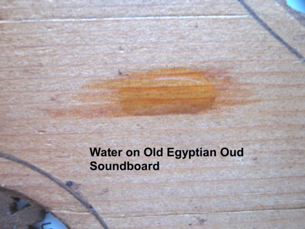

Before moving on to summarise the properties of egg white foam distillate a short test was carried out on the sound board of my old Egyptian oud (currently undergoing restoration) to try to establish if any sort of invisible finish was present. The sound board shows no signs of localised staining but has a darkish uniform patina. Initial thoughts were that a thin wax finish had been applied (as it had been to the bowl) - but could it have been egg white distillate - or just no finish at all?

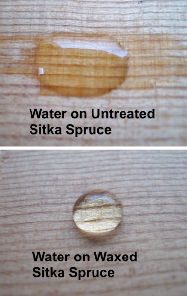

The attached images show the difference between a water drop applied to untreated Sitka Spruce compared to one applied to a waxed sample of Sitka Spruce (Minwax Paste Finishing Wax). As might be expected the water on the untreated sample remained on the surface for about 30 minutes being immediately but slowly and completely absorbed into the wood whereas that on the waxed surface showed no sign of being absorbed even after an hour or so.
In comparison, the water droplet on the old Egyptian oud sound board showed the same characteristics as the untreated Sitka Spruce sample.
Had the sound board been treated with egg white foam distillate then the water would have remained on the surface until fully evaporated as is evident in the previously posted images of the test samples.
Wiping the sound board surface with a damp cloth removed some oxidation and surface grime.
It is, therefore, concluded that the sound board originally had no finish of any kind - which is consistent with traditional oud making practice.
