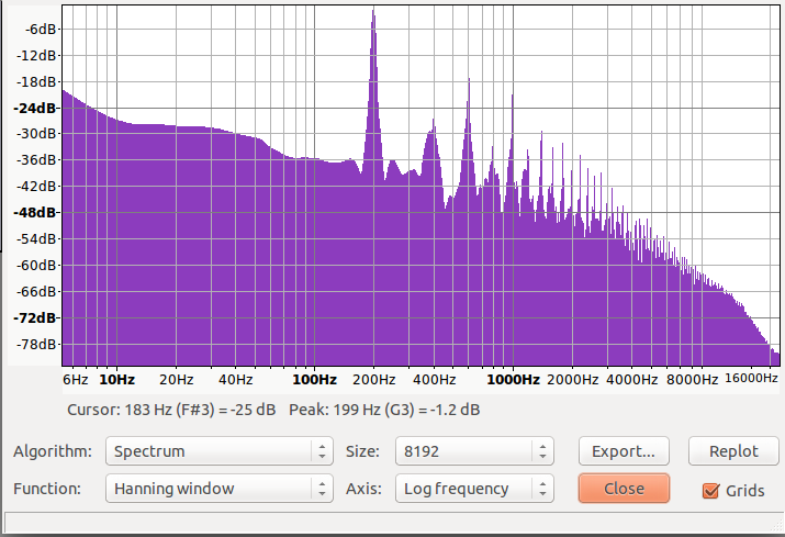

Before fitting the frets the sound board has been further cleaned up using a cabinet scraper blade to remove a few fine shavings. A 'before and after' resonance test showed a drop in measured air resonance frequency of 2 Hz i.e. from 201 Hz to 199 Hz at an ambient temperature of 15°C. At this frequency range the human ear might just detect a drop of 2 Hz. Not much but I think that this will explain the difference in the measured air resonance frequency when the instrument was first completed (212 Hz) and now (201 Hz) as the sound board was finished to be thinner around the edges than in the centre - a difference of about 0.5 mm - except in the area between the bridge and the bottom of the bowl where the sound board has been left full thickness of about 2.5 - 3 mm. This thinning made the sound board more flexible and so lowered the air resonance frequency as should be expected - all else being equal. ( the trapped air inside the bowl acts like a cushion or spring so any increased flexibility of the walls of the resonance chamber - i.e. the bowl/sound board structure - will soften the spring effect of the trapped air and so lower the air resonant frequency).
In this case the sound board - small in area and relatively thick compared to an oud or lute - has no bracing below the very stiff upper section where the sound hole is located. So one might expect removal of even a small amount of material from the vibrating area to have some reasonably significant effect. This effect will be further tested later when the sound board edge is to be rebated and finished for a half depth binding so further reducing the sound board stiffness around the edges.
In the case of an oud or lute the same effect would be achieved by reducing the stiffness of the multiple sound board braces - a more complex procedure to control and predict no doubt.
For information the attached Audacity spectrum analysis is attached to compare with the graph previously posted.
