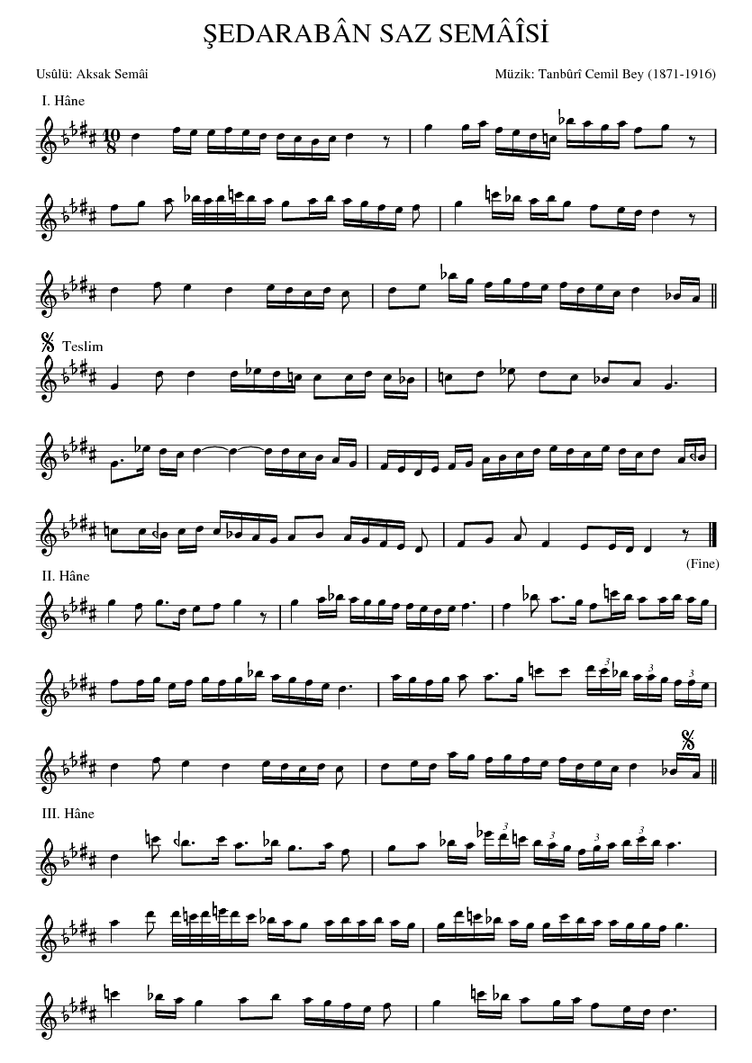

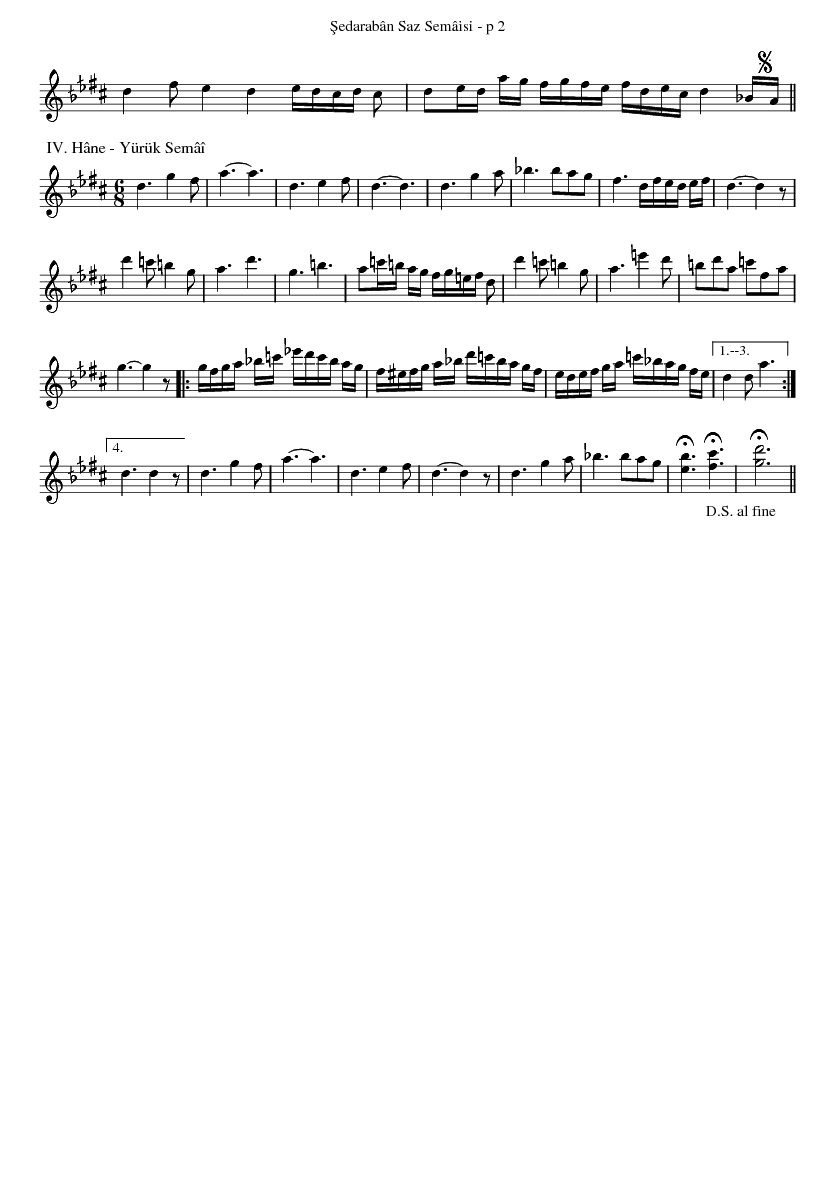

[*] posted on 11-2-2010 at 11:45 PM
RE: Lilypond...
Here's a notation I made for Tanburi Cemil Bey's Sedaraban Saz Semaisi using Lilypond. I use the supported makam init file plus I have a config file that has quite a bit of custom tweaks. I LOVE it!
Adam
Sedaraban_saz_semaisi-cemil_beyCB-page1.png - 92kB Sedaraban_saz_semaisi-cemil_beyCB-page2.png - 43kB
