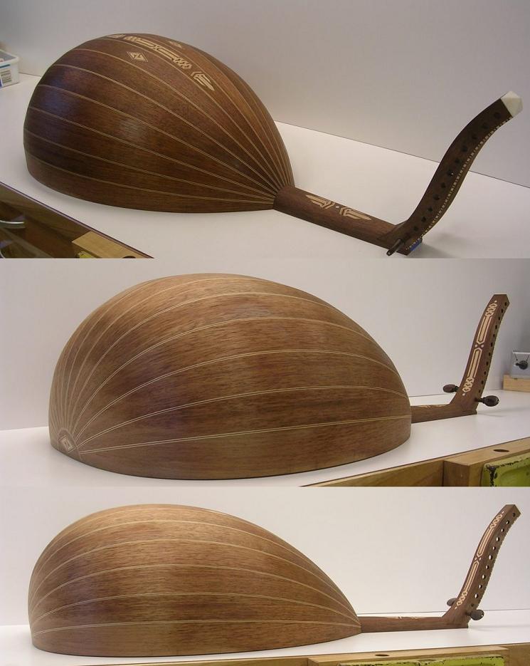

Getting close...
Latest update: neck shaped, neck attached to bowl, pegbox attached to neck.
Looking like an oud!

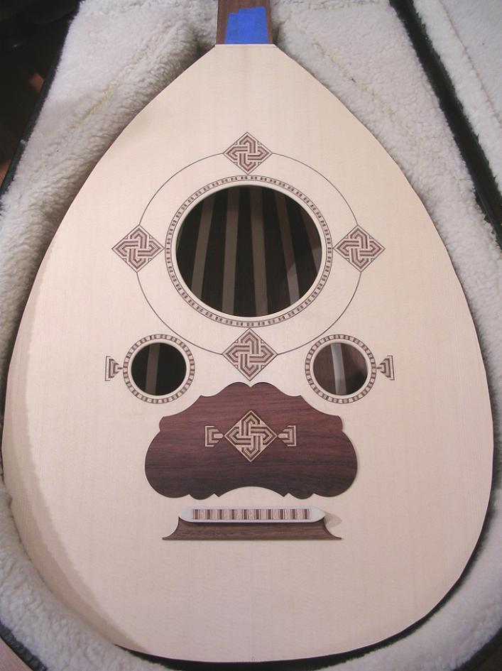

More progress....
Braces are set, pickguard and bridge are done...
Next came a decision on the pickguard design. After a number of emails back and forth...thanks for the patience Jameelo...we were in between these
two.
Finally, we decided to go with a design that is on Hamza el-Dinn's oud.
Here's a shot of the pickguard (this is the backside of it) and completed bridge, followed by a frontal shot of the soundboard.

Jameel
Posts: 1672
Registered: 12-5-2002
Thanks fellas.
Got the pickguard and bridge glued on today.
It's coming together....

Is it me - or is the central soundhole enormous? It looks fantastic and it really dominates the entire sound board.
Mike is going to be one lucky guy owning this oud!
