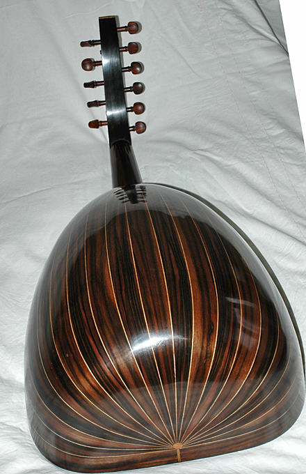

When I saw this Picture one day:
I thought, I would love to build an oud from this wood.

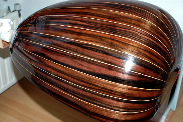

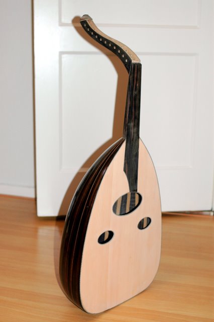

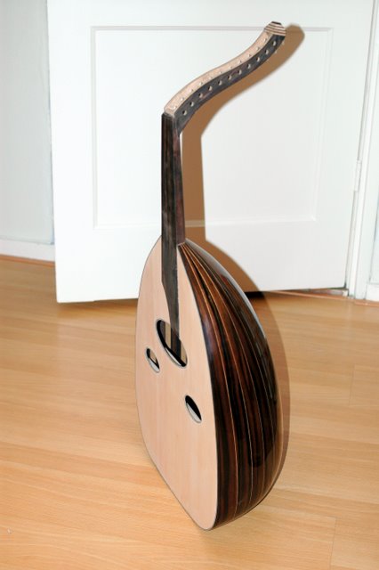

So I started building this oud. The Macassar Ebony is an amazing beautiful wood. very smooth and a joy to work with. I have sanded the ribs to 2.2 mm
to have a light weight oud.
The top is a 20 years old Spruce. The neck is also from Macassar, so is the fingerboard.
This is the result for the time being.

Hi Samir!
Yes, for shure, it looks wonderful ... and I really like it on my fingerboard, but I'm a bit sceptic, if it's a good choice for the bowl ... Ebony is
said to have "low" resonance characteristics, but maybe the Macassar is different?
That sounds very promising
So, I'm very curious to hear a sound file of the finished beauty.
I'll stay tuned

Hi Chris: Macassar Ebony tonewood has good sonic quality, can produce very powerful sound in combination with a good soundboard and the placement of
te braces.

Well, then I'm even more curious to hear it, because 20 year old spruce will give a very good soundboard and regarding braces placement I trust your
craftsmanship ... my oud has a wonderful sustain

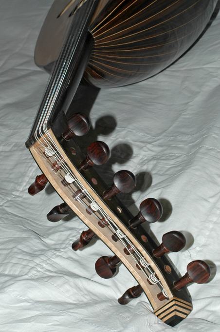

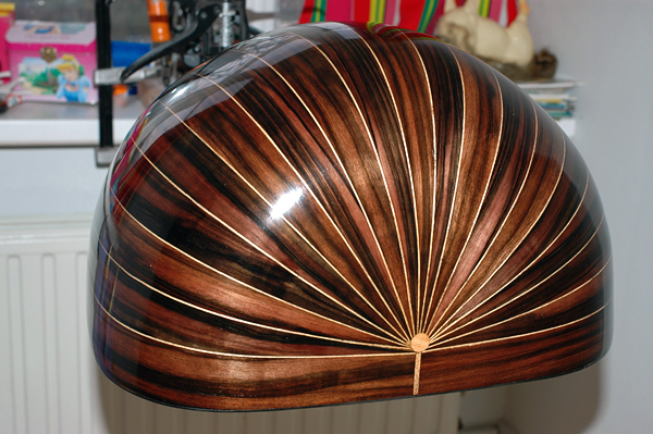

update
some pictures.
pegbox wall, macassar ebony and flamed maple.
pegbox back: ebony
pegbox head, layers of ebony and flamed maple
I wich I could place a macassar ebony bridge, but that would not be in the favor of the sound. it will be a rio rosewood or indian rosewood.
until next pictures

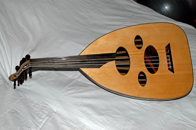

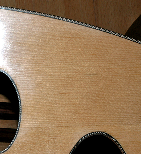

finished
At last, the strings are in place.
the whole oud is build as follow
bowl : high grade macassar ebony
soundboard, high grade épicéa spruce
neck, macassar ebony
pegbox: inner wall, flamed maple; outer wall macassar ebony; back: ebony
fingerboard and pickguard and nut: macassar ebony
pegs and bridge, indian rosewood.
purfling: maple/pear
at first strike, I liked the sound already, mature and powerful
the macassar has given extra power the the oud.
the strings are exactly 3mm at neck join, easy to play.
finish: french polish (shellac)
I will post a video in couple of days as the oud settle a bit.
thank you for following this project
