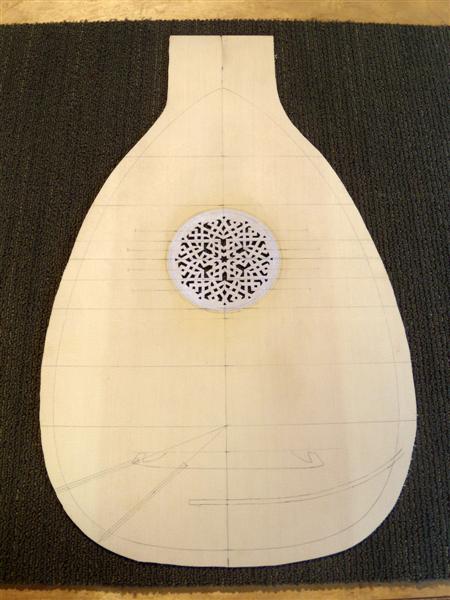

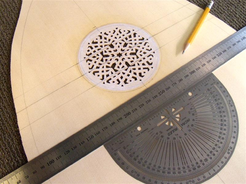

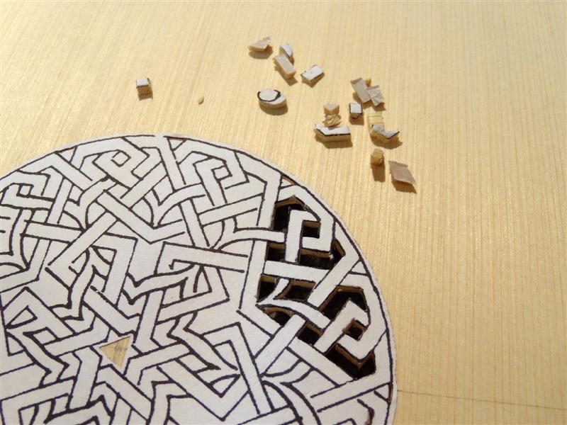

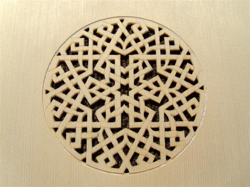

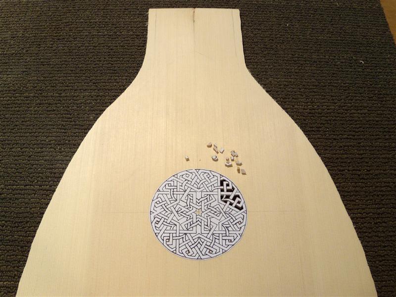

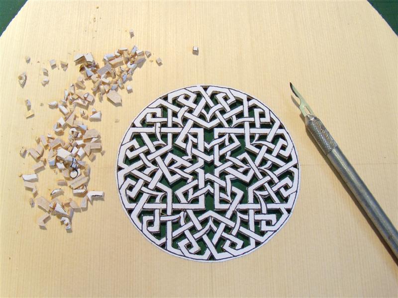

I am building a Lute now, thought you might be interested to see a making of a "built-in" rosette.
DSCN2765 (Medium).jpg - 86kB DSCN2767 (Medium).jpg - 91kB DSCN2773 (Medium).jpg - 89kB DSCN2788 (Medium).jpg - 81kB
Aymara
Posts: 1162
Registered: 10-14-2009
[*] posted on 2-22-2010 at 09:39 AM
Wow, nice work ... thanks for sharing.
PS: Nice woodworks in your blog.
Greetings from Germany
Chris
[*] posted on 2-22-2010 at 12:32 PM
Nicely done Yaron.
All original lute rosettes were finished by embossing the face of the rosette with incised V cut lines which makes the design of the rosette tracery 'stand out' and appear more delicate. Are you planning to finish the rosette this way?

Nicely done Yaron.
Thank you!
I know about the V groove embossing... not sure yet about doing it. :rolleyes:
It is so nice that way (for my eyes), I am thinking of keeping it like this.
Yaron.

[*] posted on 2-23-2010 at 05:51 AM
It's very beautiful, Yaron.
Did you cut-out all the bits just using a knife?
I like the expewrimental instruments on your blog, some sound files would be appeciated.
Thanks! Yes, 2 kinds of a knife (2 days work!!!)

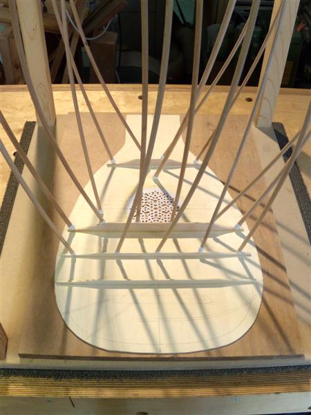

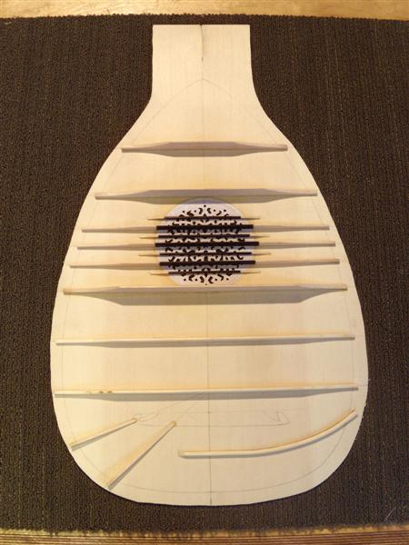

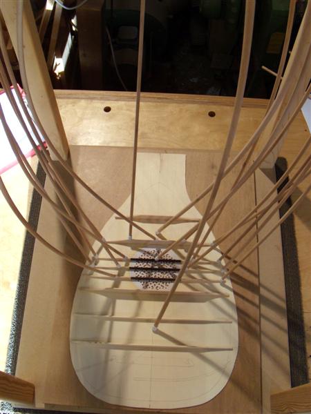

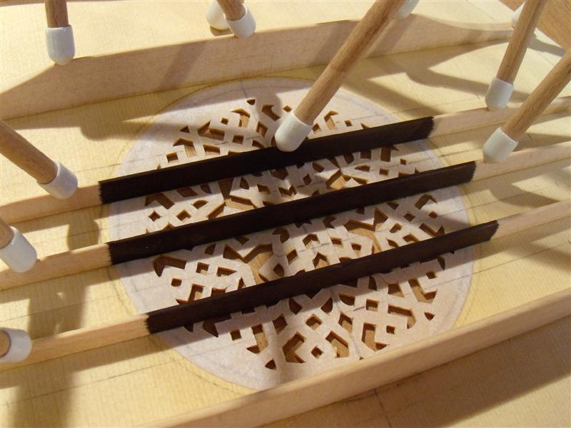

Renaissance Lute Building - Sound Board's Braces
DSCN2842 (Medium).jpg - 90kB DSCN2845 (Medium).jpg - 48kB DSCN2849 (Medium).jpg - 55kB

Soundboard and Braces
DSCN2853 (Medium).jpg - 49kB DSCN2852 (Medium).jpg - 74kB DSCN2858 (Medium).jpg - 52kB
Aymara
Posts: 1162
[*] posted on 3-25-2010 at 05:24 AM
Wow, interesting bracing below the bridge area ... can you tell us a bit about that?
Chris

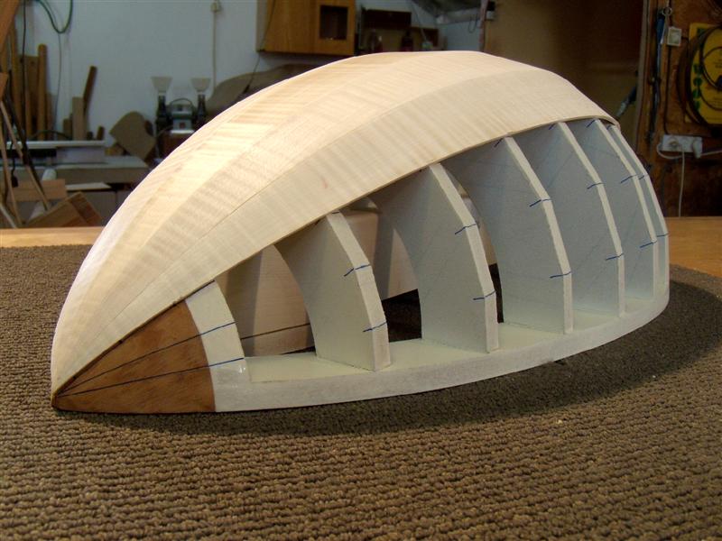

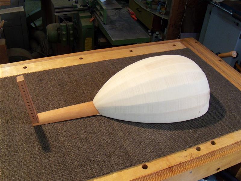

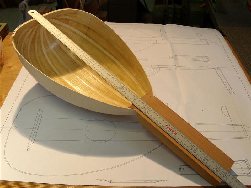

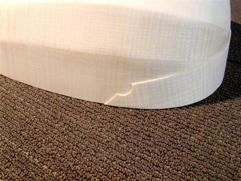

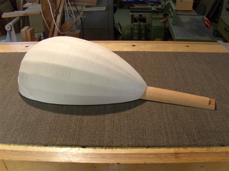

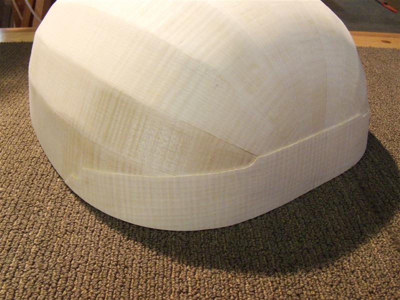

[*] posted on 4-19-2010 at 06:31 AM

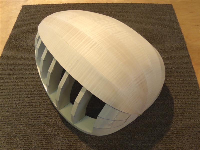

Lute Body
DSCN2939 (Medium).jpg - 80kB DSCN2938 (Medium).jpg - 81kB DSCN3056 (Medium).jpg - 79kB DSCN3058 (Medium).jpg - 102kB
[*] posted on 4-19-2010 at 12:09 PM
Nice progress Yaron.
Are you using a surviving historical lute as the model for your project?

[*] posted on 4-20-2010 at 08:06 AM
Thank you!
I am building this Lute according to a detailed plan delivered by David Eduard's (live in GB) from a live lute from 1530+-
I don't invent or alter it in any way...
Yaron.
[*] posted on 4-20-2010 at 12:39 PM
Thanks Yaron. I am always interested in who is building what when it comes to lutes!
So, from your response, I can conclude that your lute is modelled after the well known original 6 course, mid 16th C lute by Georg Gerle - the design modified to accommodate 7 courses and using alternative materials from the original (by U.K. luthier David van Edwards). This is a good choice of lute design for performing the late 16th C lute repertoire so should give satisfactory results .
Checking with David van Edward's web site, I note that he offers a complete lute building package including step by step instructions on CD-ROM, Full Size drawing etc. It will, therefore, be useful to others interested in making a lute (or an oud!) - and who might want to purchase the package - to see how you progress with the project.
As an experienced luthier you will, of course, find no problem in completing the project successfully.
Yaron Naor
Posts: 275
Registered: 1-24-2009
Location: Bat Hefer, Israel
[*] posted on 4-21-2010 at 04:38 AM
Thank you! I couldn't summarize it better... Yes it is modelled after the well known original 6 course, mid 16th C lute by Georg Gerle - the design modified to accommodate 7 courses and I am using an alternative woods as similar as I can to the original.
I have entered this post especially to share the process with all of you (even though it is a Lute and not an Oud)
It is a bit complicated than an oud because the body is asimetric, there for every strip is in a differnt shape!
Thanks for encurigment
Regards,
Yaron.

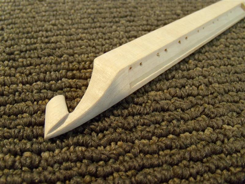

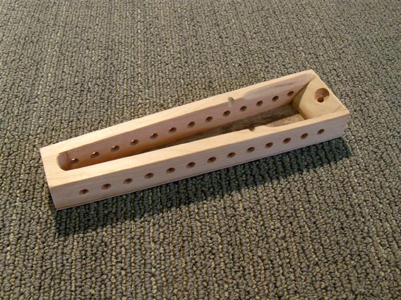

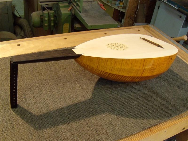

[*] posted on 5-16-2010 at 05:31 AM

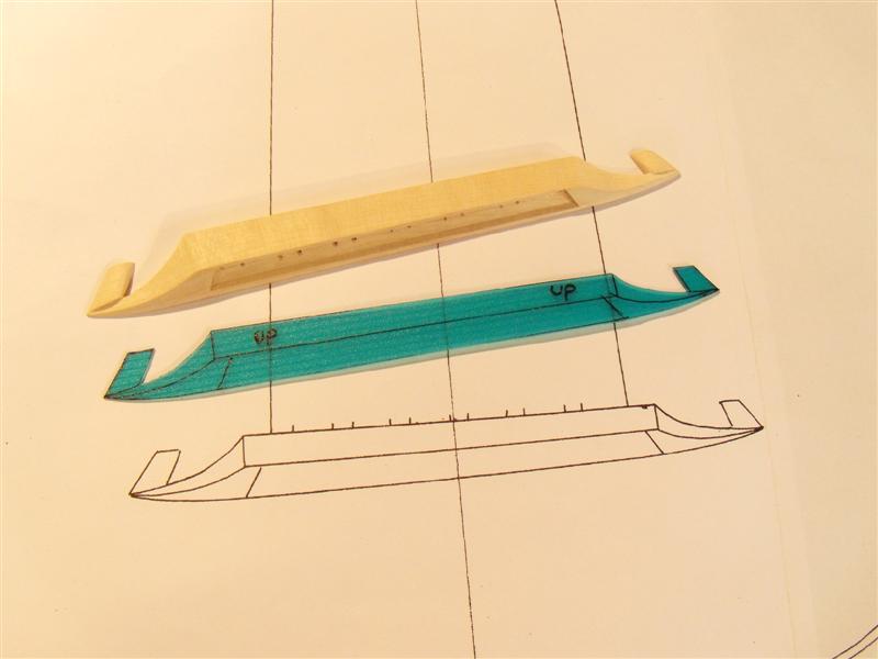

Lute bridge and neck
Very, very complicated bridge :(
DSCN3066 (Medium).jpg - 62kB DSCN3075 (Medium).jpg - 37kB DSCN3072 (Medium).jpg - 102kB DSCN3076 (Medium).jpg - 57kB DSCN3078 (Medium).jpg - 81kB

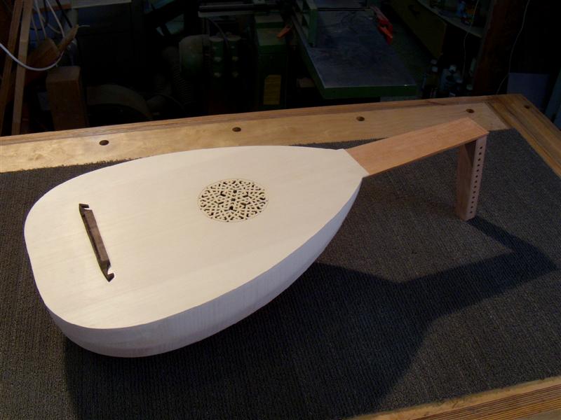

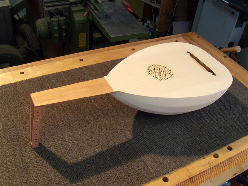

[*] posted on 5-20-2010 at 04:35 AM
Neck, Top, bridge and peg box...
DSCN3085 (Medium).jpg - 134kB DSCN3088 (Medium).jpg - 85kB DSCN3089 (Medium).jpg - 84kB DSCN3092 (Medium).jpg - 61kB

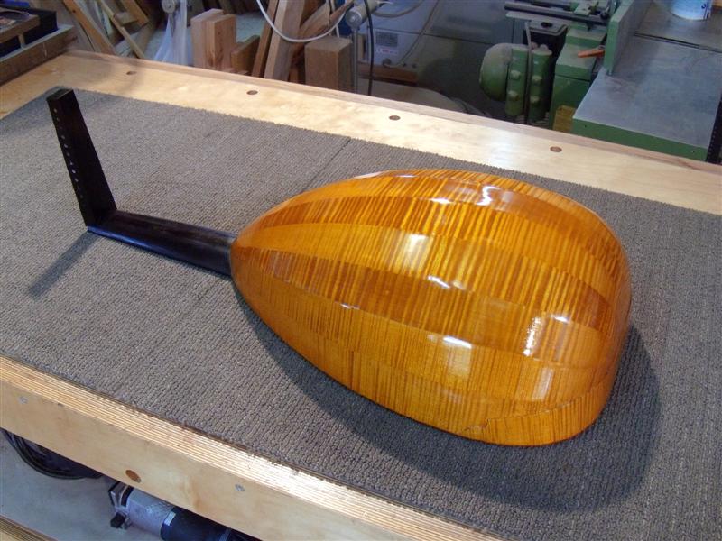

[*] posted on 5-26-2010 at 03:49 AM
Coloring, and Shellac all over
DSCN3112 (Medium).jpg - 96kB DSCN3104 (Medium).jpg - 95kB DSCN3110 (Medium).jpg - 92kB
Aymara

[*] posted on 5-26-2010 at 03:58 AM
Mmmh, that going to become a real beauty :applause:

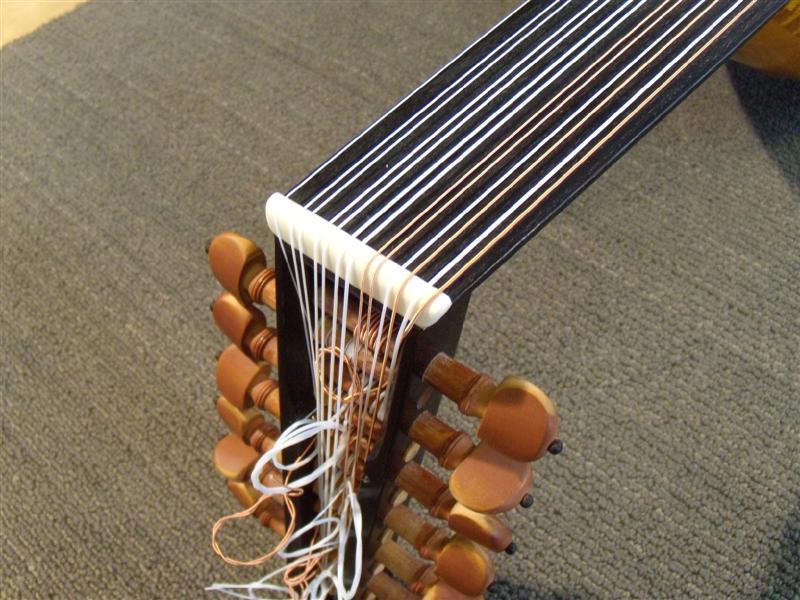

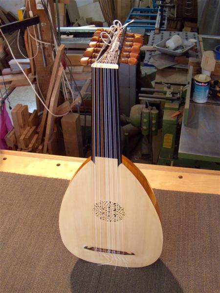

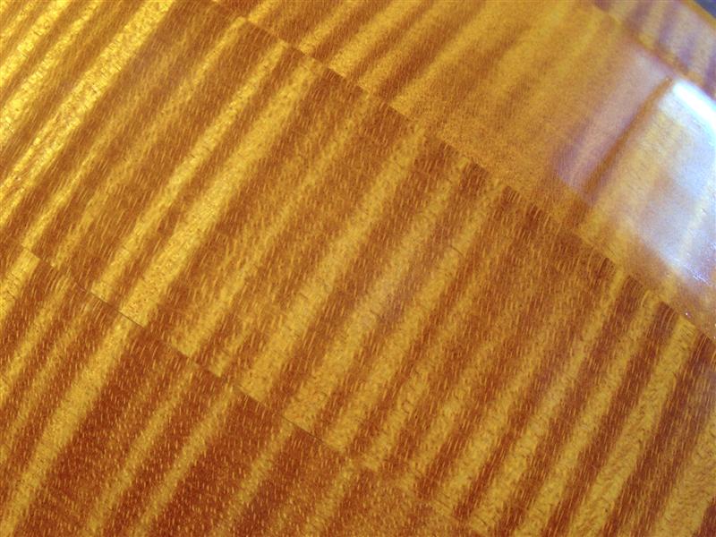

[*] posted on 6-3-2010 at 04:40 AM
First images of the finished Lute
More images in a few days - the logo and the polish.
DSCN3124 (Medium).jpg - 56kB DSCN3126 (Medium).jpg - 103kB

[*] posted on 6-3-2010 at 05:55 AM
Congrats Yaron,
it looks great. A soundfile would be interesting.
