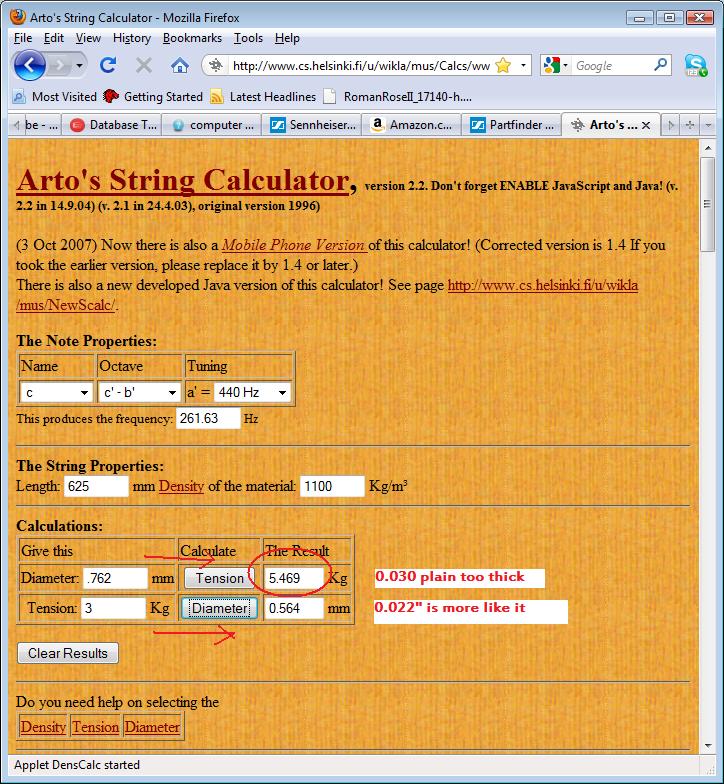

Why is that safe? Many ouds come with 5 course, like yours. People will often try to tune them with the "common Arabian 5 course" tuning. The problem
I've seen is that many ouds with 5 courses have strings that are NOT appropriate for tuning up to cc as they are too thick. Don't ask me why but they
ship often with the 5 BOTTOM strings of a 6 course tuning. If the bass string is e.g. 0.041" it's not meant to pull up to F = 86 Hz. If the top course
is 0.030" it's not meant to pull up to c = 261 Hz.
I had this happen. When I tried pulling the tuning up to FF AA DD gg cc the wound strings started to pop and unwind, and the whole instrument nearly
imploded. When I mic'ed the strings I realized they were indeed too thick to be pulled up to FF AA DD gg cc.
String instrument players should have a micrometer and know their strings. You can get a very good one that will read down to 0.0001" on Amazon.com
for $10 and shipping:
http://www.amazon.com/0-1-VME-Outside-Micrometer-0001/dp/B0007CXJKE...
if a plain nylon string is a 0.030" or so on a 24.5" scale it will not pull up to c' = 260 Hz without a LOT of tension. Why? Look at Arto's tension
calculator, for instance. Enter that data and it shows almost 6 Kg of tension. That's OK for a guitar but not for an oud. If you ask it how thick a
nylon string will give you 3 Kg, it says 0.022".
So Tarbool is wise. Chances are nothing will go wrong at that tuning. You will in fact be playing like the bottom of an oud tuning. If you get some
0.020" fish line at the corner store you can try adding a (6th) cc course on top!
