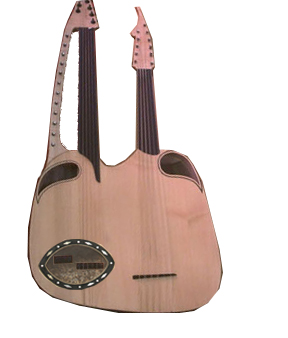

In building my "ragmakamtar" (which is something like an oud and a sarod in one instrument)... I went thru several versions, and my latest version (#6) is really the closest I have managed to get to the "true" sound of an oud.
http://www.edwardpowell.com/rmtar.html
http://www.youtube.com/watch?v=mXprk1b2uRw
On version #6 I made the soundboard quite huge because I realised that the deep tone of an original oud comes from having a very large soundboard surface area (as well as being very thin and lightly braced). But what I experience is that the bridge for the upper neck puts a huge amount of tension on the soundboard, and this tension effectively tightens to soundboard so much that that area of soundboard (around the upper bridge) will not respond to the delicate vibrations of the oud's nylon strings - - - therefore, although the soundboard seems HUGE, actually the area available for resonance for the "oud" bridge is smaller than what is available on a normal sized oud.
Hence my interest in small ouds, because this ragmakamtar #6 has a soundboard about as big as it possibly can get without starting to look absurd. So my thinking now is to try to get some inspiration for what can sound great as a small oud - and perhaps adjust version #6 to a particular type of small oud?

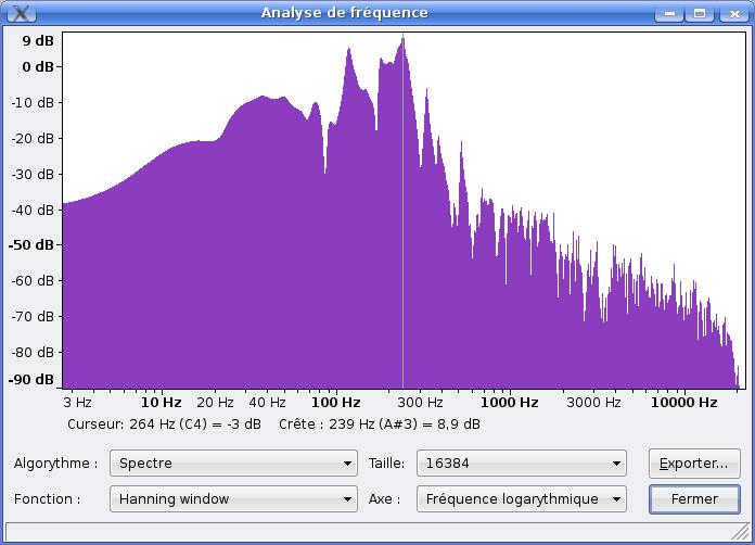

to illustrate your message, here is a taptone analysis of the small Hanna Nahat (recorded with a zoom H2 at about 10cm in front of the bridge).
Indeed the strongest resonance is around the A#3 at around 239Hz.
There is also a quite strong resonance one octave below, for the A#2 (117 Hz), which may be responsible for the bassy sound?
It would be interesting to compare to other ouds...

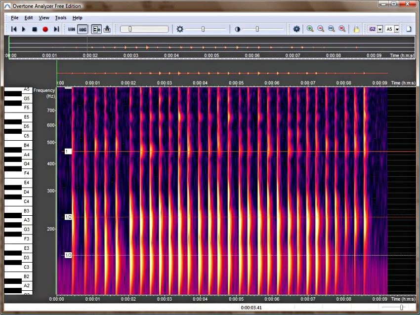

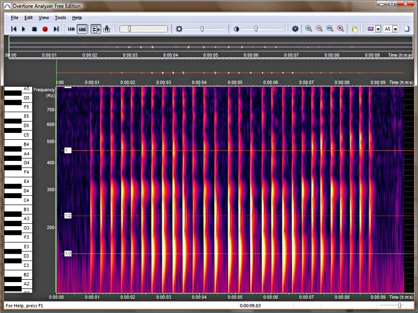

[*] posted on 6-22-2010 at 01:15 AM
Now we're getting somewhere, Danielo! What setup and software was used to generate this graph? Is it just a standard FFT spectrum analysis or is a special program used? If it's a special program, does it exist for the PC as well?
Nice to know we both get the same results ;-) but now it would be great to have the same graph for different ouds! Can you describe how the soundboard was excited and how it was mic'ed, at what time the spectrum was captured, that we can duplicate it exactly for other ouds? Is there a write-up on the technique? A standard?
I wonder if we could use something like this free edition program below and standardize on an inexpensive setup (like a commonly available cheap microphone) and procedure? Or is there a way to zero out the characteristics of the mic? Or has someone already done all this? I would think all this would be VERY useful for Edward in his experiments.
http://www.sygyt.com/en/overtone-analyzer-editions
It would be SO interesting if we could build a meaningful library of oud timbres!!! It would be such a useful supplement to the customary and ever-requested "sound file" that in reality is overly dependent on the microphone, the exact position of the mic, the acoustic environment, the way the oud is played, the strings. The "sound file" is a useful thing, but without very precise standards, it's far too easy to skew the impression, deliberately or not.
I had observed these same resonant nodes as on the graph very simply by playing the instruments and noticing where the resonance is greatest, where the instrument is most live. In playing different ouds it seemed that the "mother node" shifts around from oud to oud, maybe as much as down to and Neva G and up to B (what is that note called?), but since I wasn't using instrumentation, maybe that's just my imprecise recollection.
Of course exactly one octave below the "mother node" we have that "bassy peak", that maybe is the "oud's normal bassy sound" that Edward was talking about. Does this Hanna Nahat have that very "typical Arabic" timbre?
It would be lovely to capture a snapshot at a specific standardized time later, to quantify the tendency to sustain (or not). Or maybe a short time sequence. The spectrum is not everything. My impression is that one aspect of the "typical deep Arabic timbre" is that the primary is followed by something like a reflection, an echo of sorts, followed by a relatively fast decay -- all in all a rather percussive "bark", no? Whereas, say, a Turkish, in addition to a richer spectrum, has a longer sustain without a well-defined reflection? Anybody agree, or am I "hearing things"?

[*] posted on 6-22-2010 at 01:50 AM
Well, I'm sure there are standard techniques to do this but I did not document myself so I just tried :)
The procedure was as follows:
I use the Zoom H2, which has a decent mic built in, of course in uncompressed mode (.wav), taking care of not saturating. It is placed in front of the bridge area, about 10cm from the face. While I was muting strings with the left hand, I gently taped the sounboard with the flesh of a finger, to the right of the pickguard. To be sure I get repeatable results, I did it several times, moving slightly the tap position.
For the analysis, yes it is a standard FFT. I tried to make the spectrum of any of the taps, or several together, it gives consistent results.. I'm using a very good freeware, Audacity (for Linux and Windows or Mac):
http://audacity.sourceforge.net/
Indeed it's a very good idea to build a library of oud soundboard responses ! I think it is very hard to remove the microphone response so it would be better to use the same equipment (which is very common so not a problem..)
And yes the Hanna Nahat has a typical deep Arabic timbre (but with slightly less 'sharpness' than those of his brother Abdo !), lot of bass and quite short sustain. One should not forget that the player somehow adapt to the instrument, so on a shorter sustain oud one has probably the tendency to hit harder, hence enhancing the percussive sound... (on the Shehata that I owned I noticed that I played naturally softer than on Hanna's oud).

[*] posted on 6-23-2010 at 05:16 AM
I have been experimenting with the free Overtone Analyzer, and it's quite a useful program.
The program shows a time line and the spectrum at each time point is plotted as follows: vertically we have frequency, and the color represents the intensity, with white being the loudest. It takes a little time to get used to it.
Here we see the soundboard of two ouds being tapped in different spots with the strings muted. If you study the graph what emerges is that the Sukar (first) shows more nodes being excited at different frequencies, different frequencies have the most white, as the soundboard is tapped in different spots, while the Egyptian tends to ring in the same frequencies regardless of where you tap, they cluster around the magic 240 Hz and 150 Hz. It's as if the bracing on the Sukar created a number of different resonant sub-areas. But it's not a simple yes/no affair.
Sukar1_3fm.jpg - 179kB Egyptian4fm.jpg - 179kB
I think it's very risky to attribute specific aspects of an instrument's timbre to specific spectra or physical structures, like bracing, until after a lot of trail and error testing.
It's quite complex. To build a library of instruments and be able to correlate a timbre with specific features in the spectrograph will take a lot of work, but at least a basic program like this is available to everyone to experiment with and think.
