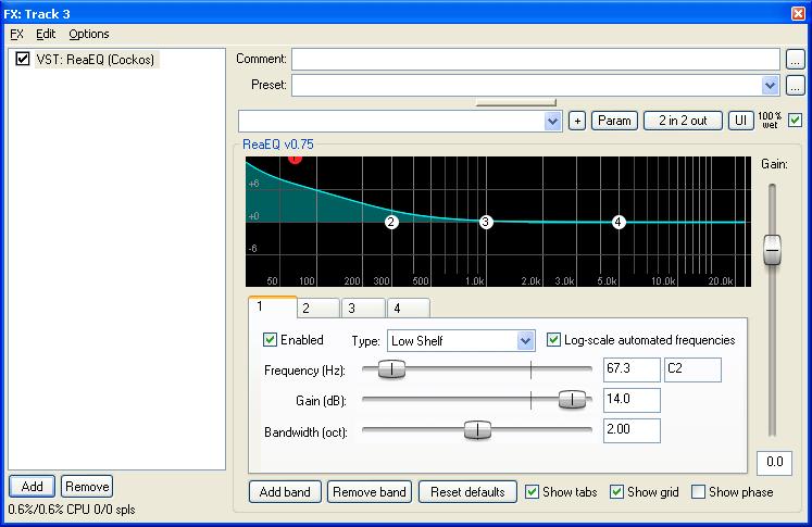

But this is no problem, because you use Reaper. Just click the FX button on your recorded track and choose the ReaEQ equalizer and set the bass band as shown in the screen shot below (don't forget to set the frequency to note C2) ... leave the bands 2-4 with the default settings.
You'll be astonished ... the oud becomes more bassy and the recording sounds much warmer ;)

Not the oud, but the built in microphones, which are not very sensitive to bass frequencies below 300Hz as it seems.
And using EQ to compensate this has nothing to do with a fake bass ... this is no fake, but a compensation of a technical flaw ... you just make the frequency range of the bass strings louder.

The problem might be, that the H4n has a low cut filter below 237 Hz which reduces the recording of bass drastically. And using EQ in Reaper compensates this effect.
Is it possible to switch this filter off?
With my AKG C3000 microphone it's similar. It also has such a low cut filter, which I can switch on and off. When on, the oud lacks bass and when switched off, the sound is much warmer with a lot of bass.

zoom h4n has a large selection of low-cuts that you can set on his microphones if you want (80-98-115-133-150-168-185-203-220-237 hz)
anyway, since it's philosophy of recording is x-y (90° or 120°) it uses 2 cardiod microphones so you have an enhancement on the low spectrum if you go closer to the soundhole depending on the axis between hole and microphones,
anyway extreme proximity is usually avoided because not so natural, it become easily innaturaly boomy,
I think in general you don't need a low-cut in advance in the microphone recording an oud, you can adjust after a low-cut if there's anything strange in the bottom.

I too want to say that "unnatural" is a useless concept, because NOTHING you might do with an oud and a pile of electronics is natural. The bass-boost from the proximity effect of a cardioid mic is no more natural than adjusting the frequency response with filters. It's just a question of what works better. Putting the mic very close to the sound hole with no high-pass "low cut" filter carries the risk of overloading the mic or the internal pre-amp, all it takes is a hard pluck and leaning forward a couple of inches, and THAT is unnatural and cannot be corrected, and if there's a limiter it can create a mess too. It's a lot better to give yourself a little margin of safety, and shape the response after the fact.
