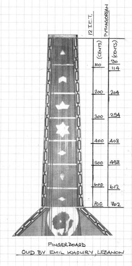

The fingerboard of my old 'Egyptian' oud has inlays that seem to represent 'frets' or - more correctly - finger positions as far as a modern oud (19th C onwards) is concerned. On the other hand these inlays may be purely decorative although , perhaps, a dim and distant memory of times when the oud was fretted?
In the topic "Nahat in Brazil" ('Oud Forum') two images of ouds with 'fret' inlays have been posted. The first of an oud by Abdo George Nahat (1959) and the second by a currently unknown luthier Emil Khoury of Beirut, Lebanon. The latter instrument apparently was owned by the late (and lamented) oud virtuoso Farid Al-Atrash.
The image of the fingerboard of the Emil Khoury Oud - although only a low resolution 'thumbnail' - was sufficient to allow an analysis. Assuming the distance from the front edge of the nut to the neck joint is 1/3 string length (as it should be) the attached image compares relative 'fret' or finger position calculated according to 'Western' 12 Tone Equal Temperament and 'Pythagorean'. It can be seen - within reasonable tolerance errors - that the inlays are intended to represent fret or finger positions and so are not purely decorative.
I shall next analyse my old 'Egyptian' oud finger board to see if there is any supportive correlation.
If the fingerboard inlays do represent finger positions, is this an indication of a traditional regional design (Lebanese or neighbouring regions)?
I ask this question in the light of the fingerboard inlay by another (unknown) Lebanese luthier (image attached).
Curiouser and curiouser - more to follow!
Emil Khoury Fingerboard (421 x 847).jpg - 85kB 59GeorgeFt Abdo George Nahat.JPG - 77kB
Oud Fret Inlays Lebanon.jpg - 6kB

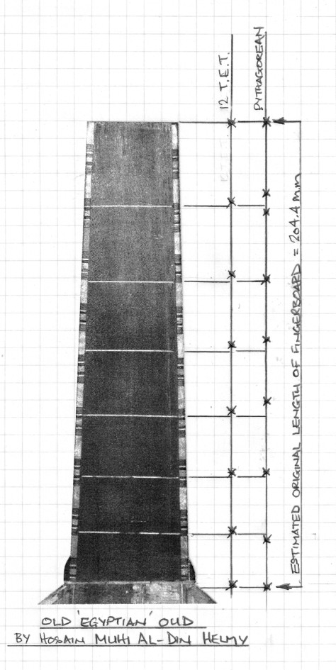

The fingerboard of my old 'Egyptian' oud is another example of 'fret position' inlays. This instrument - currently being restored (as time permits) is interesting. Now battered and worst for wear it was made - according to the roughly made label inside - by Hosan Muhi Al-Din Helmy a 3rd year apprentice attending a (so far unidentified) training school in an unknown location. The oud is assumed to be Egyptian because I bought it in Cairo in the early 1960's - but it could be from anywhere in the Middle East. It is of unknown age (1920's ?).
The current string length is 622 mm. The fingerboard length (front edge of nut to neck joint) measures 202 mm, from neck joint to centre of sound hole measures 212 mm and from sound hole centre to front of bridge measures 207 mm. Front edge of bridge to the bottom of the bowl measures 90 mm. The length of the bowl from neck joint is 511 mm. Due to repairs over time at the neck joint the neck would appear to be a little shorter than original.
As can be seen from the dimensions above, the oud does not meet the traditional proportions of fingerboard length being 3X string length - perhaps due to careless workmanship by the apprentice luthier or perhaps due to a modification of the instrument to increase the string length to 622 mm. At this string length, the fret inlays make no sense.
However, if it is assumed that the original length of the fingerboard was 204.4 mm (I have messed around with several alternatives to arrive at this - not unreasonable assumption) then the original string length with this dimension (according to tradition) should be 3X 204.4 mm = 613.2 mm (say 613 mm). This does not work either because the bridge is too low. However, if we position the bridge according to tradition (half fingerboard length) then things start to come together and the 'fret' inlays start to make some kind of sense.
The attached image compares the inlays to scale against a
12 TET fret positioning and Pythagorean.
It is clear from this that there is a pretty good match with 12 TET particularly if the angling of the inlays (higher on the bass side) is taken into consideration. Therefore, the fret inlays are not randomly placed (and so are unlikely to be purely decorative) and could be intended to represent a slightly modified 12 TET fret placement.\
Is this evidence of a much earlier tradition (now forgotten in the oud making tradition) from a time (15th C or earlier) when oud design had a direct influence lute design in the West? Does this, in turn, mean that my "Egyptian" oud was not made in Egypt but - perhaps in Lebanon? Hard to say without further data.
I shall now check the fret inlay placement of this oud against a lute that has a modified 12 TET fret placement.
More to follow!

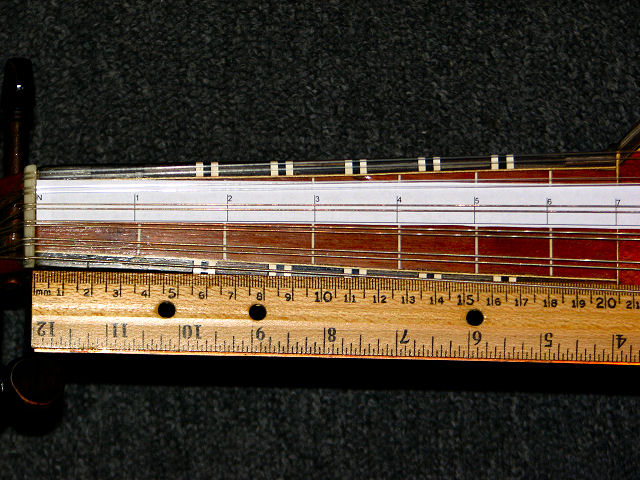

Ok, here is my preciouss MOP Egyptian. You can see the deviations from 12ET in the inlays. The printed template and the data below is from the WFret program. The 7th inlay at the neck-body junction is the closest to being "dead-on", at 205.5 mm instead of the theoretical 204.9 mm.
It's hard to completely eliminate optical distortion, this is good as I can make it right now.
Scale Length: 616.0 mm, 9 frets 12ET
Fret Number mm from Nut mm from Fret
1 34.6 34.6
2 67.2 32.6
3 98.0 30.8
4 127.1 29.1
5 154.5 27.4
6 180.4 25.9
7 204.9 24.4
8 227.9 23.1
9 249.7 21.8
Img_5222rmL.jpg - 53kB IMG_9021m.JPG - 104kB
[*] posted on 7-10-2010 at 05:01 AM
Perfect! Thanks for posting this helpful information Fernandraynaud.
It is interesting to note that the apparent deviation of the fret inlays from 12TET seems to pretty well match that of my lute frets after adjustment for fine tuning.
The image resolution is insufficient for me to read the ruler scale accurately.Would it be possible for you to measure the exact placement of the inlays (to the centre of each inlay) measured from the nut for comparison. The tabulation that you provide is only the calculated 12TET fret placement (that I agree with) but does not quantify the deviation of the inlays from 12TET.
For a vibrating string length of 616 mm the 7th fret on a Pythagorean scale would be 1/3 string length or 205.33 mm which is very close to the actual position of your fret inlay #7. Not that I am saying the inlays represent Pythagorean scaling because - judging from the apparent deviations from 12TET - I would say that they do not.
Could you also measure the neck joint to centre of sound hole distance and sound hole centre to bridge to see if these are also 1/3 string length?
Also can you confirm that the oud was made in Egypt (from the label perhaps) or is it an Egyptian style oud that was made elsewhere in the Middle East. Date?
Thanks again.

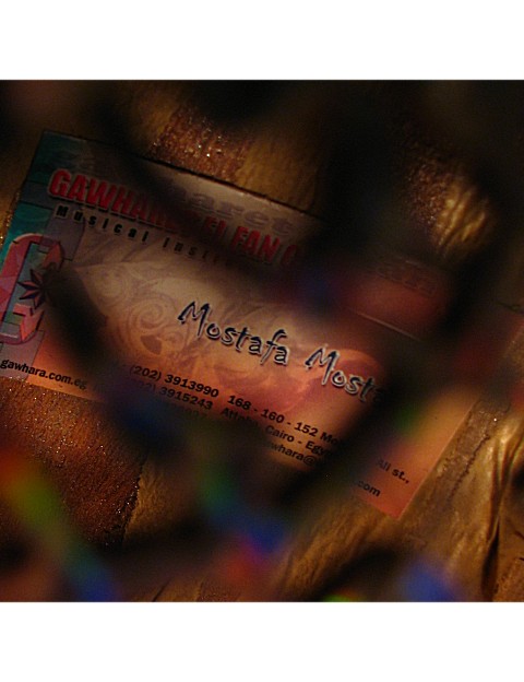

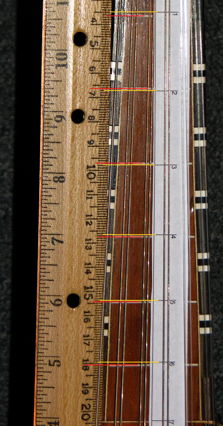

[*] posted on 7-10-2010 at 12:37 PM
The only thing I know for sure is that the oud has a Gawaret business card glued inside. That to me only says they sold it at some point. Gawaret I understand only recently started making any of their instruments. The info on the card might provide clues, but it's pretty recent, they didn't have web sites in the Mezozoic. Was the shamsa removed just to put a business card inside? Don't know, there's no recent regluing obvious, but it doesn't have to be obvious. It was purchased in Egypt I was told less than 2 years ago, and I can't confirm this, but it sure doesn't "feel" like a two year old oud, I'd guess at least 10 years old, not 40, but not 2, just the particulate in the crevices, the smell, the cracks, the look of the mummy strips in the bowl. Maybe they age fast, poor things, peddlin' their butts on Mohamed Ali street in that heat. Ach, and the dust and the auto exhaust! And it sounds deep and fat, not at all like new wood.
On the enclosed you can estimate the deltas pretty accurately, in reference to the 12ET table, zoom in, but I'll take more exact measurements you ask for later this weekend.
GawharetBCard1.jpg - 52kB GawaretBcardE.jpg - 93kB IMG_5228xm.jpg - 102kB EgyptInlays3.jpg - 335kB
[*] posted on 7-10-2010 at 04:07 PM
Thanks Fernandraynaud. The higher resolution image should be good enough as it is probably about as close as it is practical to measure. My readings recorded below.
Oddly enough, the closest match to historical lute fret placement that I can find - for a string length of 616 mm - is that given by the Spanish theorist Juan Bermudo in his 'Declaracion de instrumentos musicales', 1555 - for a vihuela (equivalent to a lute).
-------- Vihuela -------- Oud --------- 12TET------- 1/8 Comma MT
Fret 1 - 35.5 ----------- 36+ --------- 34.6 --------- 35.6
Fret 2 - 67.3 ----------- 66+ --------- 67.2 --------- 66.9
Fret 3 - 96.3 ----------- 97------------ 98.0 --------- 98.7
Fret 4 - 127.3 --------- 127.5 ------- 127.1 --------126.1
Fret 5 - 154 ------------154 --------- 154.5 ---------154.8
Fret 6 - 180.1----------181---------- 180.4 ---------179.2
Fret 7 - 204.5 --------- 205 --------- 204.9 -------- 204.6
So, if my lute had inlays set in the same relative positions as those on your oud, the lute would be pretty much in fine tune if the frets were tied directly over the inlays compared to setting them at 12TET spacing initially.
This would be equivalent to a meantone temperament varient - something like, say, 1/8 comma.
Interesting.

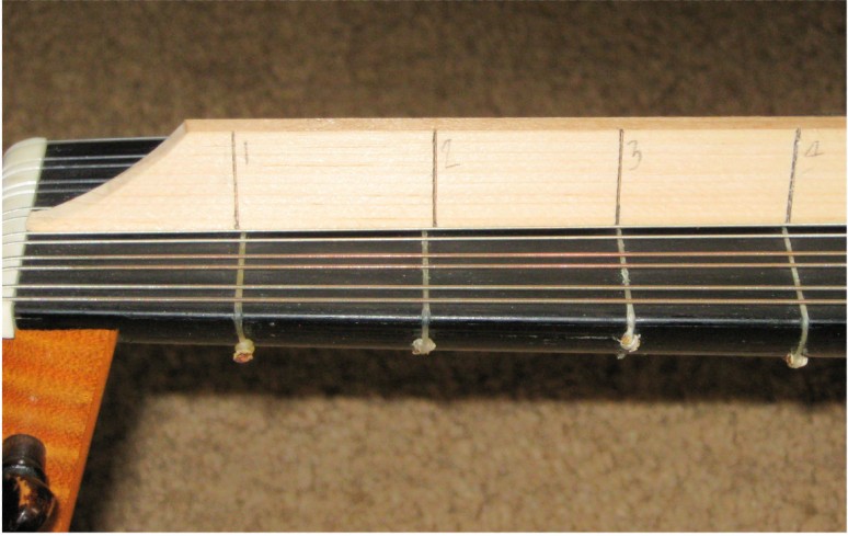

[*] posted on 7-14-2010 at 03:39 PM
Jdowning, I have some doubts here. This goes back to my previous issue about frets affecting all notes in a row. I can set my Korg OT120 tuner to various temperaments, from Pythagorean to Meantone to Valotti, a dozen different tunings appropriate for Renaissance and Baroque music, that I can use to tune my harpsichord and clavichord. If I tune my oud's AA course to 440 Hz, and my other courses say in perfect fifths, I can step through various temperaments on the Korg and see if any agree with the inlays on the Egyptian. In other words if I finger on those lines, is there a temperament setting on the tuner that gives me close to zero deviation for all notes on all strings. So far I don't see one. You might get a "hit" say for meantone on one string, if you finger at the inlay lines the notes will agree with the tuner, but then on other strings they will not. The one remaining question is how to tune the open strings relative to each other, but I feel confused as to how lutes are made to conform to say a meantone tuning on all strings.
An advantage of marking strings rather than the fingerboard is we can set intervals separately on each string, rather like the staggered frets I referenced above.
