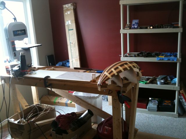

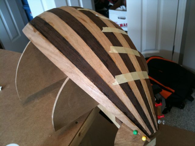

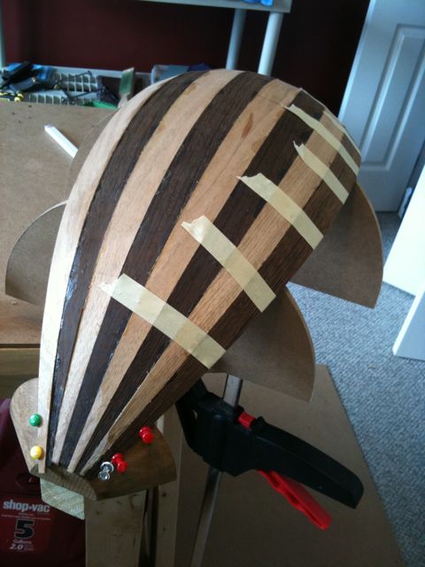

Hi everyone,
I apologize for being somewhat of a ghost these days. I am quite busy with work but I have been finding some time to start on a new project these days.
I am putting a new video tour of my redesigned condo workshop along with some shot of the progress on a new instrument bowl.
this one is white walnut & wenge
Thanks for the wood Jameel ;)
here is the work shop tour. Sorry for the shaky hand
http://www.youtube.com/watch?v=M92ocJmI1tQ
All the best Mike and the mikeouds family.
IMG_0183.jpg - 50kB IMG_0179.jpg - 50kB IMG_0180.jpg - 46kB

[*] posted on 7-24-2010 at 04:48 PM
Wow, what a workshop! And I like the unknown guy you hired to play background music, who is he? :D

[*] posted on 8-14-2010 at 02:21 PM

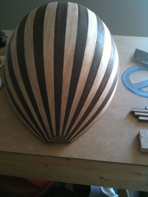

Completed bowl
Hi everyone,
Finally... here is the finished bowl.
Never... EVER! working with wenge again.
IMG_0226.jpg - 84kB

FastForward
Registered: 6-2-2008
[*] posted on 8-14-2010 at 11:37 PM
Nice work Samir.
Can you elaborate on your wenge experience. I was tempted to make the bowl out of wenge and walnut but opted otherwise after reading that it was very irritating to the lungs.
Now comes the part where you have to scrape and scrape and scrape.
[*] posted on 8-15-2010 at 04:57 AM
Hi Ibrahim, thank you for the nice words.
Of course I can elaborate,
Fortunately, I was not affected negatively health wise by working with the wood. I took great care to mostly use cutting tools (planes and chisels) so I dont create much dust. The only time I had to sand a bit is for the final jointing of the ribs where I just used a flat melamine particle board with some sand paper glued to it. This is just to remove the plane marks and make the joint smooth. Even after wearing a dust mask and going very slow I had a couple of sneezes. Similar to what I get from sanding rosewood sometimes.
Now onto working with wenge, first it is really hard to bend and it wants to spring back quite a bit as it cools. This is probably compounded by the fact that I was working with the white walnut in between and it a charm to work with. Wenge is also very hard and will dull your tools in no time. I dont know how much you like to sharpen but you will have to do it often. I am not sure how it compares to rosewood in that sense but I will find out in my next project. Finally, the biggest problem with working with wenge is the grain direction issues. It only takes well to planing in one direction (like most woods) but then it also splinters like hell. those splinters are quite dangerous and I got stuck many times. They stay in your skin on your hands and they are really to small to remove with tweezers, they are barely the size of a hair.
Anyways I hope this helps,
You are right now onto the scraping part. I started doing it yesterday... what a drag that is.

[*] posted on 8-15-2010 at 09:41 AM
Confession: I hate sharpening too. I sharpened my plane twice for working on the bowl and I think the second time was not necessary.
The splinters can be very annoying and I reckon that especially if they are really small. They hurt and they swell and you can't do any work for a few days because of them.

[*] posted on 8-29-2010 at 08:41 AM
some updates

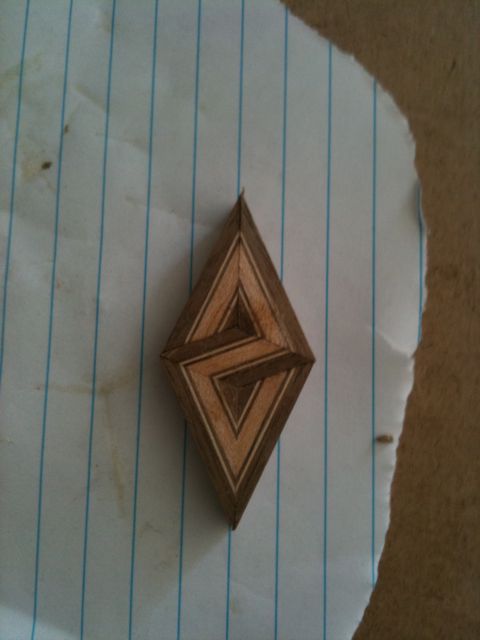

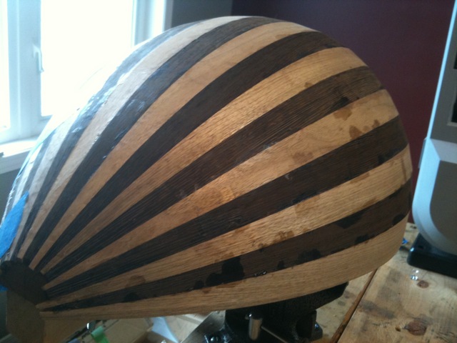

The bowl is now scraped smooth.

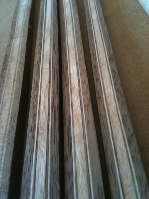

and here are some of the diamond inlays I will be using as the theme for this oud.
for more details and updates visit my blog at
http://samirnassifoudluthiery.blogspot.com/
thank you,
Samir.
IMG_0245.jpg - 38kB IMG_0244.jpg - 44kB IMG_0246.jpg - 30kB

Nice work Samir, can't wait to see and hear the finished oud. Is that Maple/walnut inlay?
[*] posted on 8-30-2010 at 11:20 AM
yah Maple Walnut.
I didnt decide yet but I might make some wenge and white walnut ones to keep the same wood theme.
But the raqma will be walnut so... not sure what will look best.
