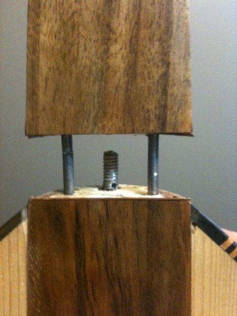

This topic is actually quite hot here on the forums. I had to repair a Sukar oud this week whose neck retention mechanism was pretty busted.
please take a look at this thread on my oud blog.

Well done Samir excellent work. Sadly I'm a little disappointed to see the naked mechanism and also hear your view that these are not actually meant to be adjustable necks. Looking at your pictures I feel you are right. My Sukar sounds well but from now on I wont hold the so called adjustable neck in such high esteem. Thank you for sharing this with us, I am sure all Sukar owners will appreciate your findings. Discoveries of this kind help us all, players and makers.

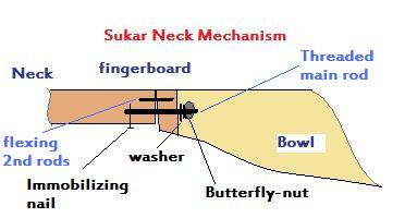

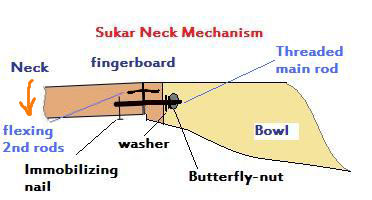

I have a Model 14 on the bench at the moment, and the way it behaves leaves no doubt in my mind as to the intent. See the drawing below, in which the angle of the neck-body junction is exaggerated to highlight the mechanism.
When you loosen the wing-nut, the neck becomes more free to let the strings pull it forward. The strange sensation, with the strings off, is that the neck is immobile but becomes a bit rubbery as you loosen. I had often wondered how the "hinging" was done. It's simply the flexing of the two smaller secondary steel rods you feel, once the central bolt is no longer pulling back. These act as both spring and hinge. As you push the neck forward, you reach the moment of contact and start pulling against the position of the wing-nut on the washer. If you loosen the nut completely, you can push a bit further. It's the closing of the fingerboard gap that limits forward travel. Look at the sketch, and imagine flexing the neck both ways on the secondary rods, up and down on the drawing. With the neck forward, the gap tightly closed, and the fingerboard level, the action (the height of the strings at the neck-body junction) will be about 4 mm.
As you tighten, you first feel the neck lose its rubberiness and stiffen. Then as you tighten more, the nut on the main threaded rod gradually pulls it to a position a few millimeters back from the soundboard plane, and the inner faces of the neck-body joint come together. It's something you sense very graphically if you try it with the strings off. That will normally correspond to an action a hair under 2 mm. This gives the narrow range of adjustment that is needed, without affecting the effective continuity of the fingerboard at the neck-body junction. Even with the neck all the way back, you can't slip a sliver of thin paper in the tiny fingerboard gap. I'm tellin' ya, it's brilliant.
Now that we understand the limits, if one wants an action outside this range, for some reason, we can see that one should loosen the neck, shave the faces of the lower gap, or insert shims as needed, a simple job, and not force things, or one of two tragedies could happen. Pulling/twisting the central bolt by over-tightening will not lower the action more, but will break the immobilizing cross-nail (as happened here). In the other direction, if you loosen the nut completely, the neck can only go so far. If you force it forward, the top (fingerboard) gap will be compressed and I'd worry the wood at the gap could be damaged; I'd hate to hear a "crack".
Only Mr Sukar could tell us what his "original intent" was. It gives the user a few millimeters of range in the action. If it were only a joint, he wouldn't have designed it with ONE exposed wing-nut that happens to control the neck angle. I find the whole design simple, inexpensive, and very smart.
Obviously it's not all that easy to repair if you break it. The owner's forcing the wing-nut with pliers was clearly a bad idea. He didn't understand the internals, none of us did. To repair, I think I would have drilled out the original cross-nail, Samir, but your solution works even better.

There is some light glue on the neck joint so you can soften it a bit with heat and moisture. Then yah... Stabilize the body and pull and shimmy a little until it slides out.
The veneer bracelet overhangs by about 2-3 mm.
You would sand it down inevitably but it shouldn't be a big deal. I would remove the neck entirely, pull those rods out and sand it on a flat surface with sand paper on it.

you can also do it dry. This what I did for this particular oud since the nut was broken there was a lot of movement I could do by hand so I just wiggled it a bit and it popped clean off. In this case there was very little glue.
The design uses the steel rods to align the neck at a set angle. There is a little bit of play room with the rods but not much.
Also, if you tighten the wing nut back to max it will pull the matting surfaces right up against each other which will lower the action.
in order to do what you want, you have to remove the steel rods and alter the angle of the neck's mating surfaces. Otherwise you wont be able to tighten the wing nut again. Also you may also need to plug the current steel rod holes and redrill them at a higher angle.
