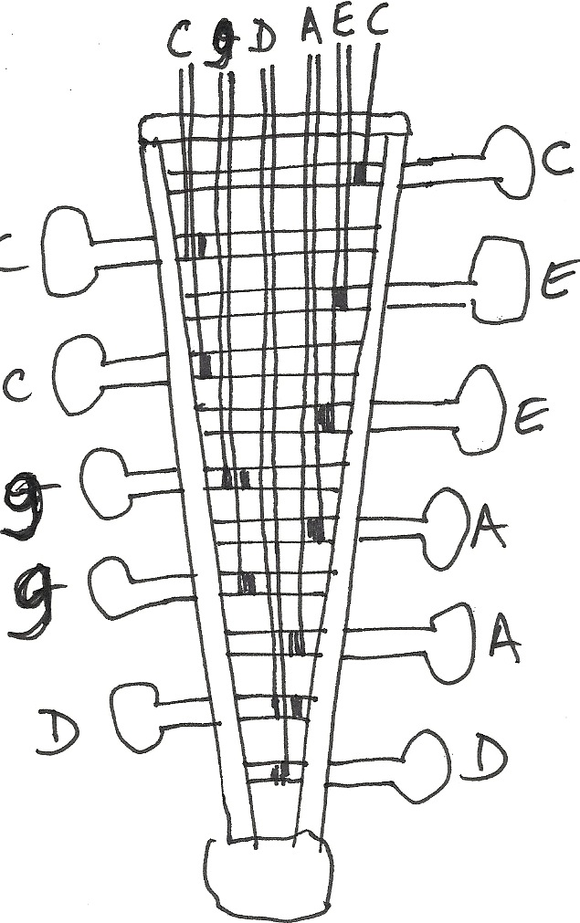

I think maybe if I strung the oud more like a guitar or cello, to avoid strings crossing in the tight space of the pegbox, this may help (for example,
top pegs starting near the fingerboard: C, EE, AA... bottom pegs starting from the end of the pegbox: DD, gg, cc... finishing back near the
fingerboard).

Since the tension on each string should be roughly similar, we can use 3.5 Kg as an average tension (times 11 is 38.5 Kg or 85 lbs total), I don't see
how another layout would change the "balance". Can you sketch what you have in mind?

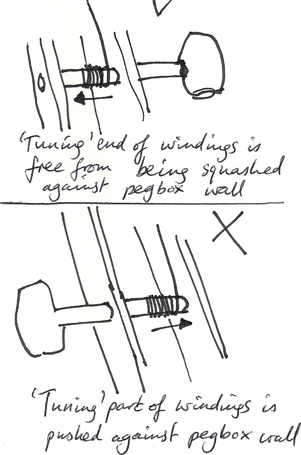

I have attached some rough sketches of the tuning method I was proposing. One of the advantages of this is that the string is never pushed against the
pegbox wall when tuning (when pushing in the peg as you say, fernand) because the 'live' end of the windings on the peg is always next to the peghead
end (see second picture attachment). I think this will help, but also allow a neater pegbox.

Hi Frank, just watch that you don't have too many windings that may push the peg out, the reason they are normally wound the other way is that it kind
of pulls the peg tighter into the pegbox, thus avoiding slipping pegs.
