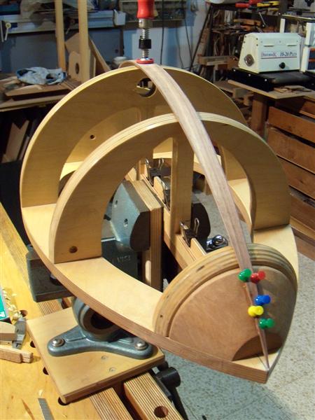

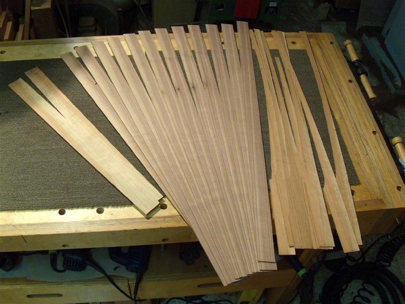

21 strips of Pear and Chery, all other are Honduras Mahogany, and Ebony.
Turkish size and tuning.
Enjoy the process
Yaron Naor
DSCN3578 (Medium).jpg - 82kB DSCN3582 (Medium).jpg - 61kB DSCN3586 (Medium).jpg - 50kB DSCN3591 (Medium).jpg - 47kB DSCN3592 (Medium).jpg - 42kB

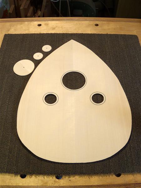

[*] posted on 10-17-2010 at 11:37 AM
Yaron, you want a "mihrab" for this oud, don't you?
I'm interesting by this piece because I'm found of exegesis...
BTW, thanks for sharing!

[*] posted on 10-17-2010 at 01:07 PM
Yes I am looking for the accurate technique for inlaying that "mihrab" into the soundboard
Yaron.
[*] posted on 10-17-2010 at 01:55 PM
http://www.emirudlari.com/main/product_gallery_info.html?products_i...
check this.
Make the piece first,
put it on the face where you want to inlay it and then take an xacto blade knife and trace the contour very precisely.
remove the material inside with a gouge or chisel
thanks,
Samir

Thanks Samir, the link helped me understand the process
and your website and Ouds are very nice!
Thanks a lot
Yaron.

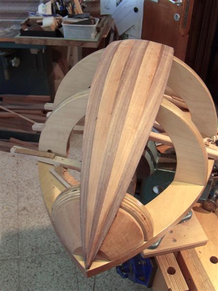

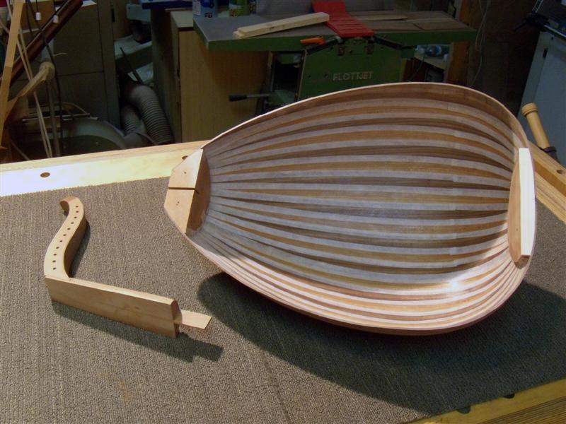

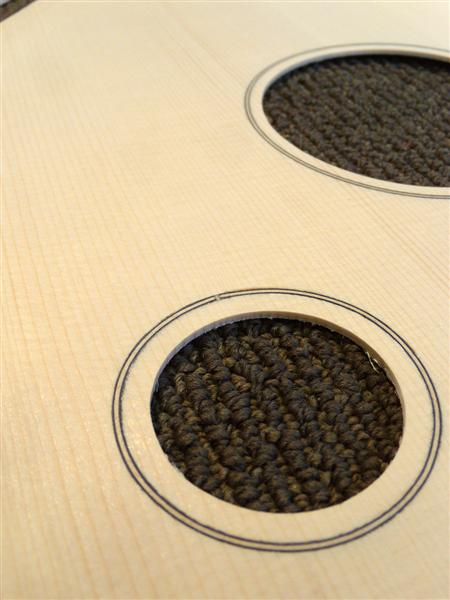

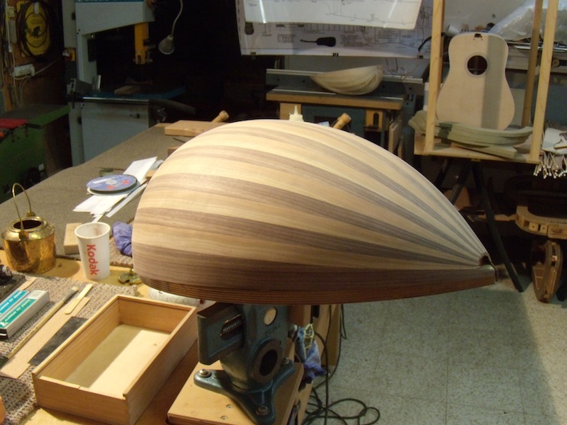

[*] posted on 11-1-2010 at 02:02 AM
The body is ready
DSCN3622.JPG - 129kB DSCN3621.JPG - 135kB DSCN3619.JPG - 213kB

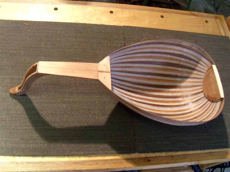

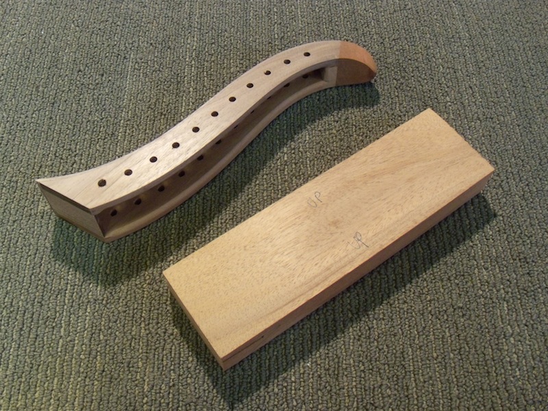

[*] posted on 11-12-2010 at 01:13 AM
Turkish Oud, Neck and Body...
DSCN3643 (Medium).jpg - 85kB DSCN3647 (Medium).jpg - 89kB

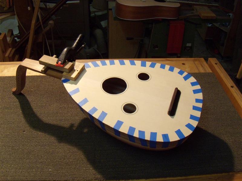

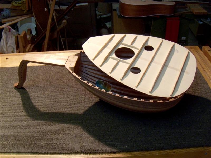

[*] posted on 11-20-2010 at 02:11 PM
Turkish Oud, the body is closed...
DSCN3665 (Medium).jpg - 78kB DSCN3669 (Medium).jpg - 69kB

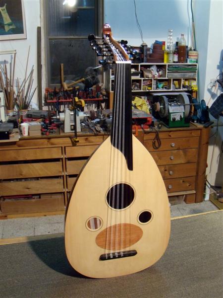

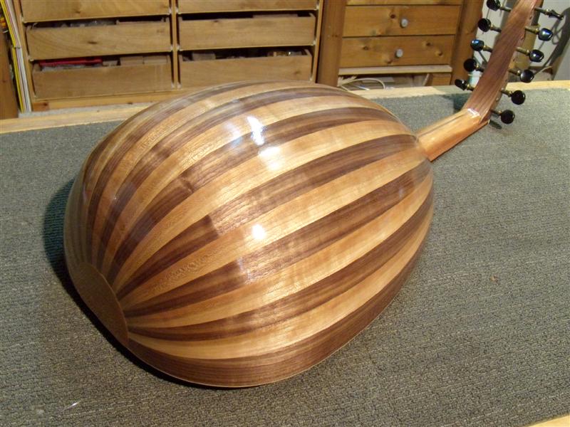

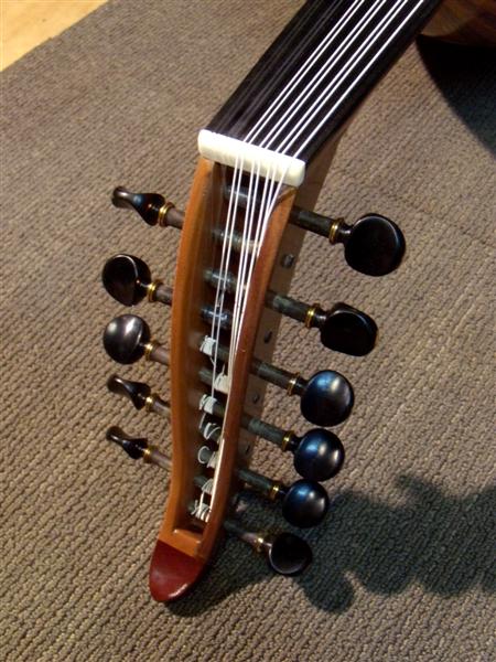

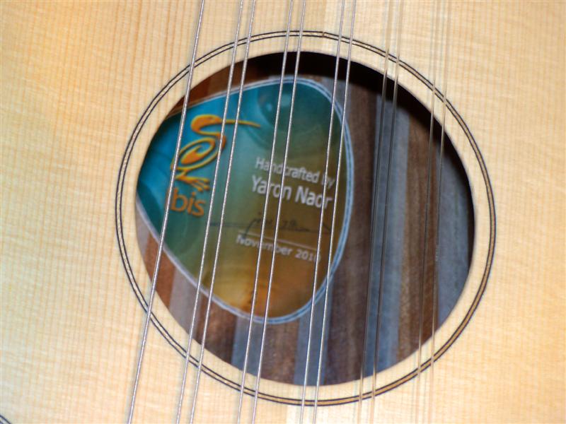

[*] posted on 12-12-2010 at 09:50 PM
The Oud is FINISHED and sounds great
DSCN3709 (Medium).jpg - 72kB DSCN3711 (Medium).jpg - 57kB DSCN3714 (Medium).jpg - 97kB DSCN3715 (Medium).jpg - 74kB

[*] posted on 12-13-2010 at 01:18 PM
rear skid rough
interesting to swallow
but the workmanship is beautiful
Ali Nişadır
Yaron Naor
Posts: 275
Registered: 1-24-2009
Location: Bat Hefer, Israel
[*] posted on 12-13-2010 at 09:39 PM
Quote: Originally posted by udmaker
rear skid rough
Ali Nişadır
Thanks for your comment!
The rear skid is rough only for gluing the ribs - after it becoms less than a half!!
Yaron.
