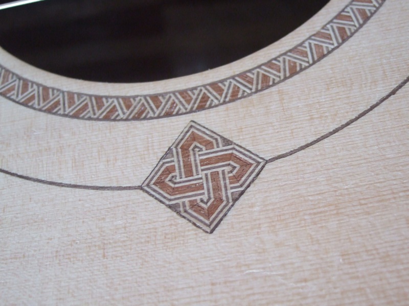

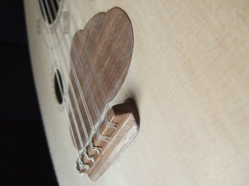

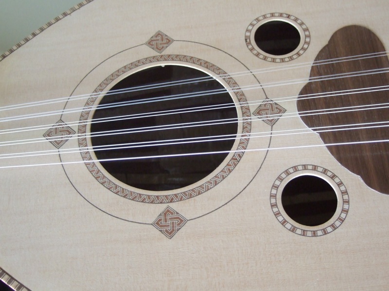

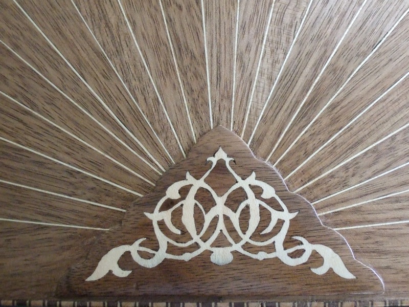

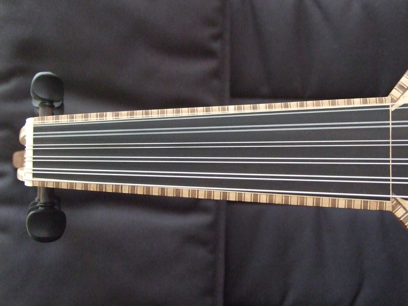

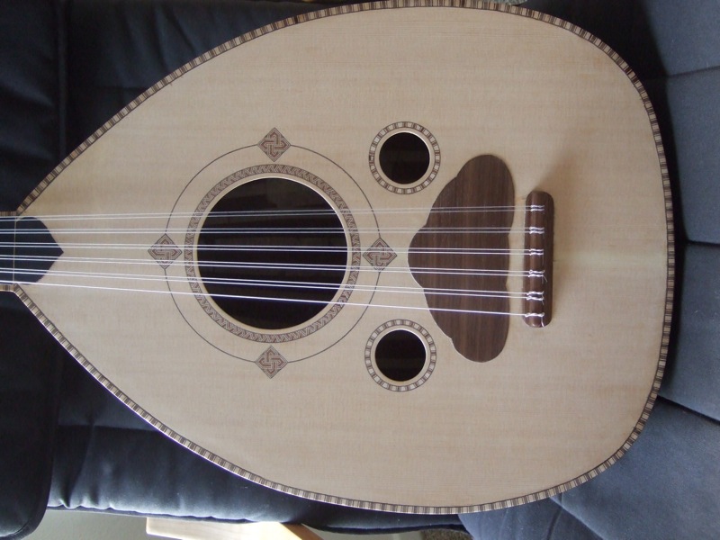

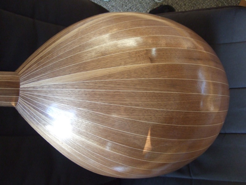

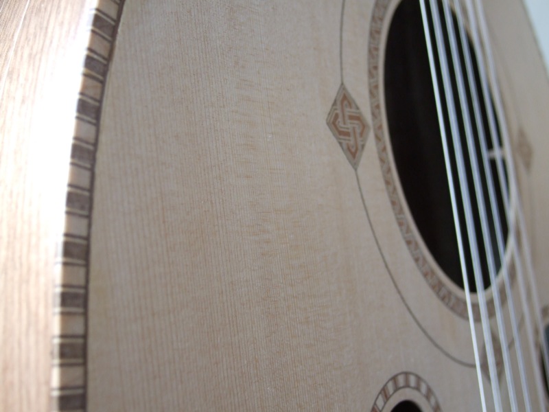

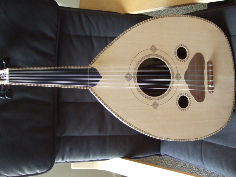

On 9/18/2010 I completed the oud and strung it.
Here are some photos, I will try and post a sound file soon. On that, what is the best way to record the oud, when I use my computer's microphone the
sound comes out different.
It is very resonant and sounds well. But I would love to hear the opinion of other experienced people. If you are in LA and want to try it and give me
your opinion please let me know.
Here are the pictures.
Disclaimer: I am not an oud maker and I don't want to be. I did this out of curiosity and will most likely be my first and only oud.

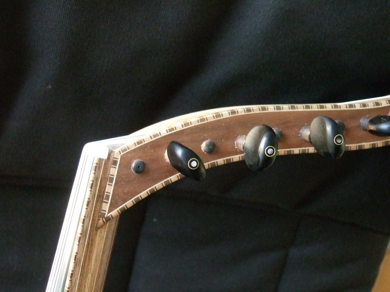

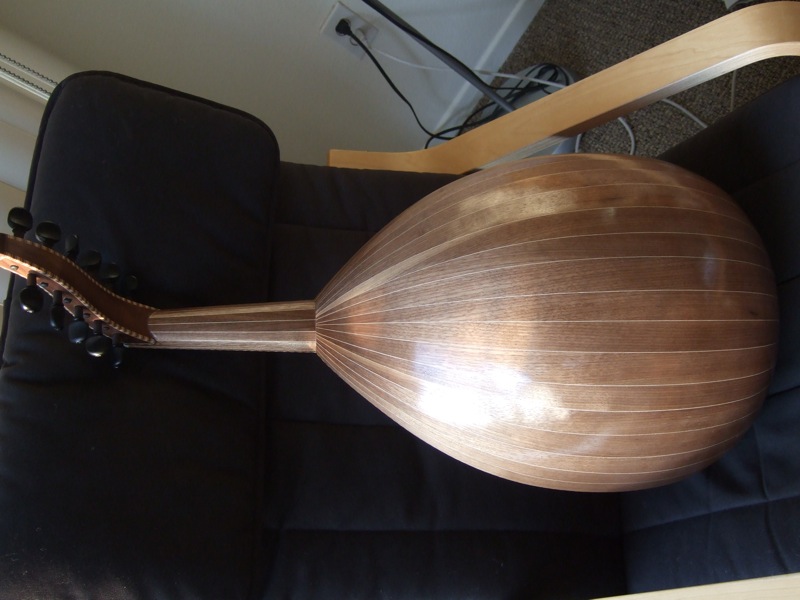

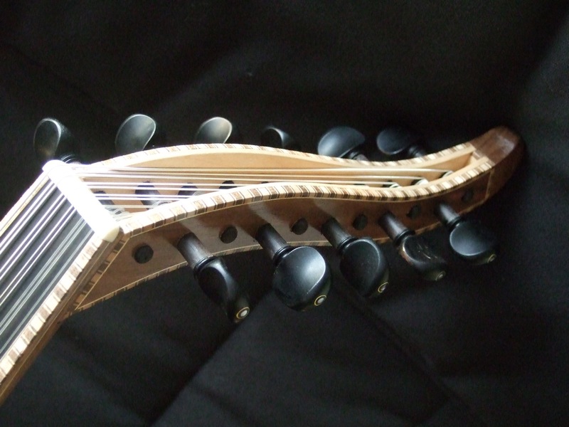

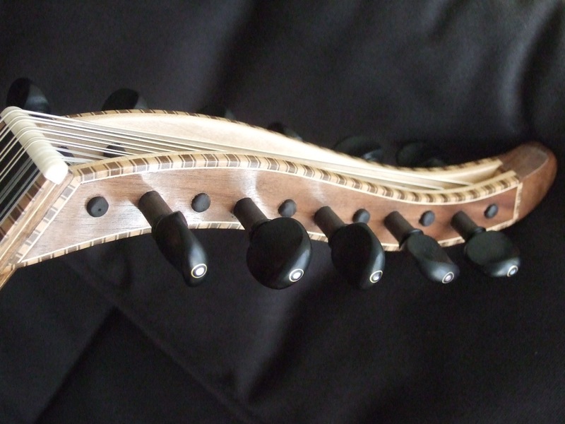

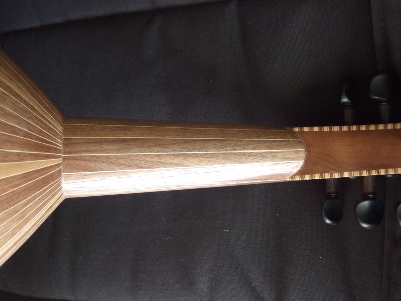

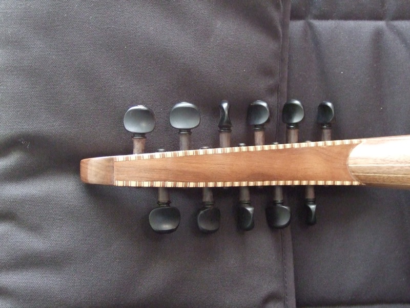

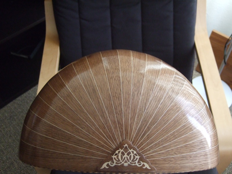

Here are some more pictures.
paulO
Posts: 531
Registered: 9-8-2004
Mood: Utz
Cool work FF; The body's really elegant looking, love the detail on the pegbox, can't wait to hear it.
Regards..Paul

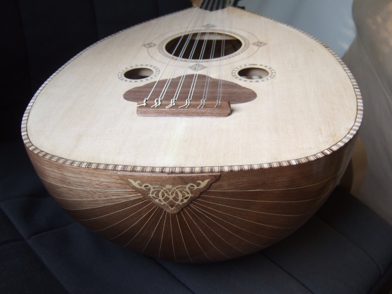

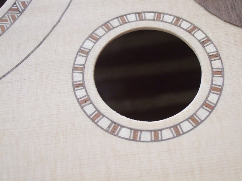

Wow. At first glance, the oud looks great. And then, on closer inspection, it looks even better. I really love the details--restrained and yet
powerful.
The purfling pattern for the inner circle of the central rosette--that heringbone-like pattern, is just sublime. I wish you posted pictures of the
process.
Just beautiful--I hope you make more.

Jonathan: I am glad you like the inlays. I will post the procedure soon. I just need to organize my thoughts and put some photos. Unfortunately, not
having a camera during the building process meant that I couldn't take too many photos with my phone and computer.
You and other guys on this forum who built ouds before me were a great source of encouragement and the information posted by you were of tremendous
help.

Some info about the oud:
Scale length 58.5cm
Bowl length 50cm
Width: 38.3cm ( the original goal was 37cm)
Bowl depth: 20.8cm ( the goal was 20cm)
Strings: Labella Turkish set tuned one step lower CFAdgc. I will try to install a different set to see how the oud sounds.
