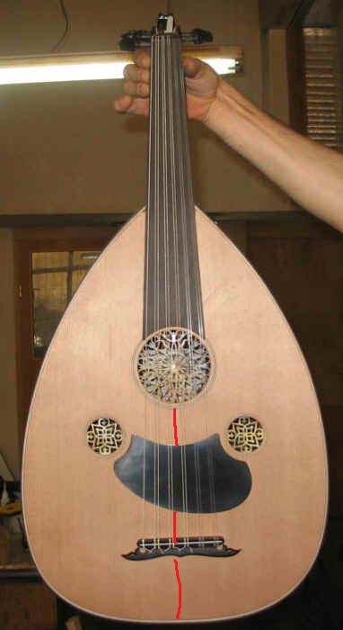

Hi there great oud builders!
I think that this topic was already on the forum, but I did not get it.
I have a problem with my new Mustafa oud (he build the soundboard). I am very pleased with the oud that I bought just a couple of weeks ago in
Istanbul - but after a week in Israel, probably due to the weather, the soundboard cracke, and gooosh, it has A HUGE CRACK along the conection between
"bookmatch".
Here is an ilustration, i took a photo from the forum and drowe the crack with red color.
How can I fix it?
Thank you so much!

Hi Marina
take it back to Mustafa. The rosette needs to be removed glue the crack from inside. Meanwhile keep the Oud in high humidity conditions ( get a
humidifier and keep the Oud at 45-50% humidity). The crack will disappear in high humidity conditions and reappear whenever the Oud is in dry weather
conditions.

I can not take it back to Mustafa - I will be in Turkey maybe next year for my vacations! ;-)
But I got your point - get the humifider.
I am afraid that the cracks are too big 2 disappear...
What do u think about some kind of "wooden mud", I don't know axactly how it is called, but it fills the cracks at wooden objects?
NO! dont put anything like that in there.
I would wait and take it back to him. Although its hard to tell how he will fix it.

I would take it to a known luthier in Israel in this case
he or she should remove the rosette, glue it from inside (yes, by filling the gap with glue and wood in such a way that the filling will be the same
as the colour of the faceboard).
Don't do it from outside or let anyone do it from outside.

there is a choice to do Marina regarding if the Oud will stay in dry conditions or not
if this is the case, the Oud will be kept in dry conditions, let the crack to be open fully and filled from inside. After that the Oud should stay
always in dry condition (30-40% humidity). Alternatively, the gad is closed naturally by high humidity condition and glued without adding any material
to fill the gap. In this case, the Oud should be kept in high humidity conditions (50-60%).
Depending where the Oud will stay you decide between these 2 methods

Usually, the weather here is very humid - goosh!!! like monsoon season - just last couple of days the weather changed...
GOOOOSH!
Humidity:14%
It is usually 50% - 85%
I newer needed humifider.

14 %? oups....my lungs will shrink at 14% not only a Oud faceboard
so let the luthier making it closing naturally (he put a wet sheet of paper on the top, this will close the gap naturally by humidity) then glue it
from inside. And keep the Oud in high humidity always

I put my oud in hard case, took wet (not soooo wet, almost dry) cloth and put it on soundboard, left the oud in the case overnight. The idea come from
wet sheet of paper (katakofka). The cracks amost dessapear! (well I keep the oud the case now.)
I mean huge cracks, like 1mm or even more! So for little cracks it would work very good.
I just newer had old dry oud in such weather conditions. Creapy....
When the Mr.Hide comes again, I'll be ready.
Thanks all!

The center seam of the 2-piece face has opened as the wood dries and shrinks. This is very common, and has many causes, but not to worry. The sound
will be affected as the sound wave is not produced by the whole face vibrating, but rather each half separately. The repair is simple and does not
require removing anything or filling from the inside. If the crack is less than 1/2 mm , it can be filled with hide glue alone. No wood filler, no
synthetic glue, please. If the opening is 1/2 mm or larger, a sliver of matching wood (probably spruce, or maybe cedar, so ask Mustafa what he used to
be sure) can be fitted from the outside. Do not dampen the face because you are only making the wood swell by adding moisture, which will only close
the opening temporarily anyway. Moisture is not good for the face, as it always should be kept dry. Using a humidifier is a good idea, but it may not
close the opening.

Quote: Originally posted by Dr. Oud  |
...If the opening is 1/2 mm or larger, a sliver of matching wood (probably spruce, or maybe cedar, so ask Mustafa what he used to be sure) can be
fitted from the outside. |
Doc, if the gap is filled with matching wood what will happen if the OUd stays in high humidity conditions as it's the case in the region where Marina
lives? the filling with high humidity will be rejected as the wood is expanding...no?
Dr. Oud
Posts: 1370
Registered: 12-18-2002
Location: Sacramento, CA, USA
Mood: better than before
Quote: Originally posted by katakofka  | Doc, if the gap is filled with matching wood what will happen if the OUd stays in high humidity conditions as it's the case in the region where Marina
lives? the filling with high humidity will be rejected as the wood is expanding...no? |
No. I've never seen wood expand enough to reject a filler due to humidity variations, particularly the soft wood used for soundboards. Soundboards
often shrink during the first few years anyway because the wood is such low density, especially if they were constructed during a wet season or in a
high humidity region or with unseasoned wood. Over time, it will shrink until it stabilizes in its home environment. If the wood was aged before
construction, it is less likely to open seams and cracks as it shrinks. As the wood ages, variations in humidity will have a lesser effect. I would
fill it during a dry season so that the cracks will stay closed all year.

Will Varnish wiil avoid the problem?
Marina- i hope your oud will get better....
And i was wondering if Varnish on Top will avoid the problem and the top will not crack ?
The sound board should not be varnished (presumably, as a Turkish style oud, the top has not been varnished or had any kind of finish applied by the
maker). In any case, sealing only the outside face of the sound board will not prevent the wood absorbing atmospheric moisture because the inside
surfaces would remain unsealed.
Richard has summarised the correct repair procedure for fine cracks (using hide glue a.k.a. collagen) or by using thin splints of matching wood for
wider cracks.
Some luthiers prepare wider cracks using a thin, wedge shaped, cutting tool (that can be made from a needle file of the correct section) in order to
straighten any irregularities in the crack making it easier to fit the filler strips and produce an almost invisible repair.
This work is relatively straightforward but should, nevertheless, be undertaken by an experienced luthier. Yaron has offered to assist.

The word "collagen" means "glue producer" derived from the Greek word for glue 'kolla'.
Hide glue (aka 'collagen' because it consists mainly of that group of animal protein) is made from animal hide and sinews comprising of up to 35% of
collagen protein and is the oldest glue in the world having been around for over 8,000 years.
It is still the best glue to use for instrument construction and repair as it is strong, hard (does not yield under stress like some modern synthetic
adhesives such as PVA) and is reversible.
If the crack in your sound board was 2 mm wide under normal ambient conditions (about 50% Relative Humidity) then the usual repair procedure would be
to fill the gap with a sliver of matching wood.

fernandraynaud's clavichord experience begs the question "does a sound board crack adversely affect an instrument's acoustic response?"
In the course of maintaining and repairing 19th C pianos I found many with sound board cracks that did not appear to affect the acoustic performance.
Indeed, the general consensus in the piano industry seems to be that these cracks are nothing to be concerned about and certainly not worth the
considerable expense involved in their repair.
So, has anyone carried out 'before and after' trials on an oud to find out if a sound board crack does affect acoustic performance (verified by
improved response after a crack has been repaired)?
Is a crack repair purely cosmetic?
