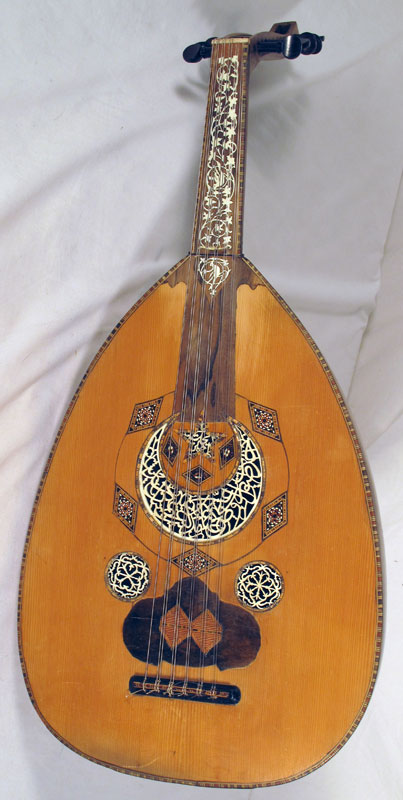

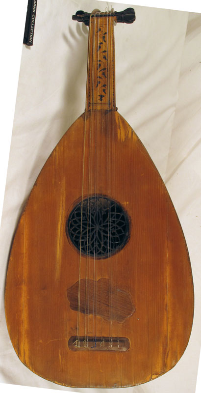

One of the ouds No. 1035 in the catalogue (which can be found on the web as a pdf) is from the original donation in 1899, so is older than that. It is

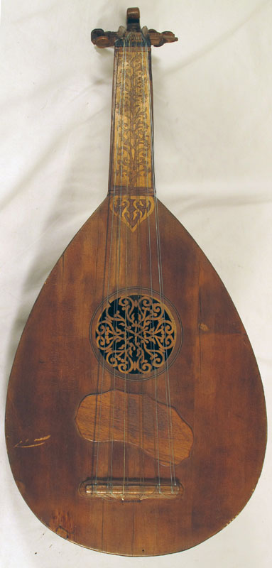

described as Egyptian with a string length of 60cm. There is no obvious label, and the inside is lined with paper printed in German. Nos 1562 and 1563
are a later donation, maybe from the late teens or 1920s, as the original catalogue was published in 1918 and lists 1464 items. 1562 is only described
as an oud, and has a 54.5cm scale. 1563 is called a Syrian oud and has a 61.4cm scale.

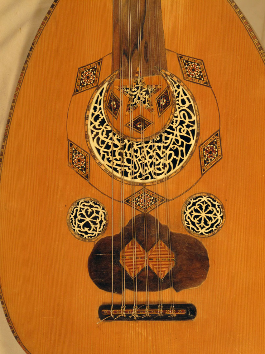

Nahat
The one you are calling Syrian is indeed Syrian, and I believe I can discern the name of Nahat in the star-shaped rosette. Furthermore, the shape,
proportions, the shape of the bridge etc, look very much like a Nahat.
It might be a Gorgy Nahat. He loved the star-shaped rosettes.
I would appreciate any information you can get on it, including more pictures, as I've been studying Nahats for a few years now and I have never seen
one with a "compound" rosette of moon and star before.
It's a very unique piece.

Good eyes Spyros, that reads "Ikhwan Nahat" --> Nahat Brothers. The oud carries a lot of Nahat touches but the rosettes are something I've never
seen before.

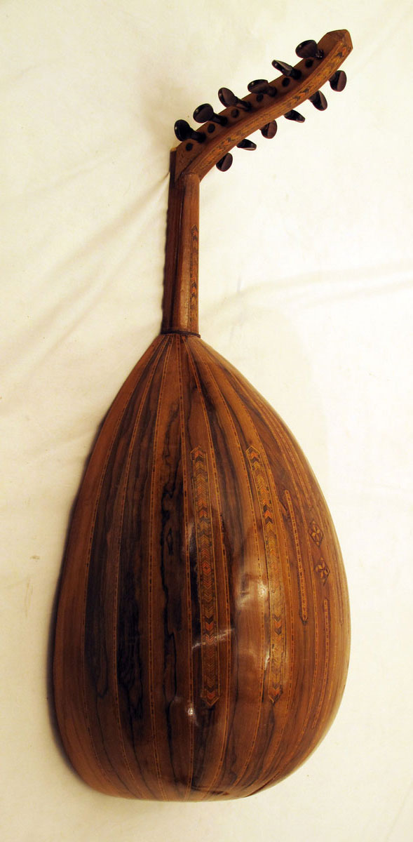

Here are the other pics I took of that instrument. Hope they help.

Well, it is definitely a "Ikhwan Nahat", which means Abdo and Rufan Nahat, and probably from the first decade of the 20th century.
I'll look at it in more detail and post some more findings.

I'm puzzled because this oud does really look like it was made by George Hanna, not by Abdo and Roufan (not only the star shams but also the pickgard,
the extended fingerboard, the inlay around the soundhole and on the back..) .
Could it be that Tawfik and George Hanna, that were brothers, also made some ouds under the Ikhwan Nahat name ?
