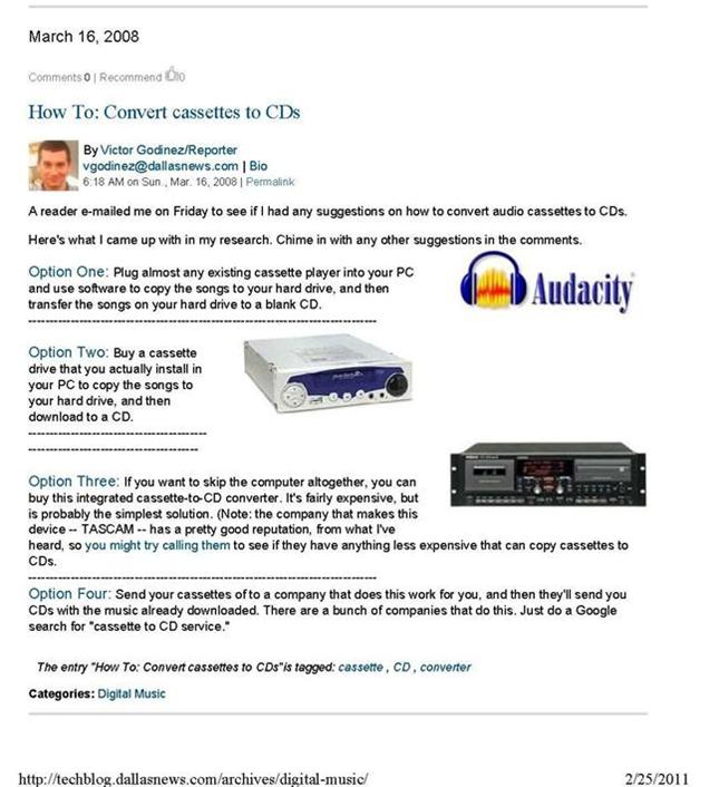

I can't believe we haven't had more discussions on this forum about converting cassettes to CD (or MP3s)!
I have a HUGE collection of Middle Eastern music on cassettes. I know that most of them will never be re-released on CD.
I am mostly interested in converting from cassette to audio CD, rather than MP3, at this time. I know that there are different ways to do this, and
I'm curious about your experiences regarding the ease of conversion and sound quality of the output.
I imagine that cassettes converted to CDs have only 2 tracks (one for each side). Is this the case? What other quirks might I encounter? Any other
tricks I should know?
I have Audacity on my home computer. Would I get a good quality recording by just running cables from my Walkman into my computer?
Given the number of cassettes I own, I am also seriously considering buying a "dedicated" conversion appliance. Does anyone have any experience with
them? Cost? Quality of output? Ease of use?
I am attaching a discussion of the issue from a blog.
Thanks much in advance for whatever advice you can offer!

We actually have the device in Option 2 of your attachment at work. It works pretty well, but not any better than any of the other options. I also
have a standalone CD recorder at home, which saves the step of recording to the computer first, but I prefer being able to edit the files on the
computer before burning. Both of these pieces of equipment can be set to autodetect the silence between songs but it usually gets it wrong,
especially if there is a lot of background hiss on the tape. If there's a brief pause in the middle of a song, it will also cut it into two songs.
Audacity will export to both .wav and .mp3 formats, although you have to download a free plugin to add the .mp3 capability.
