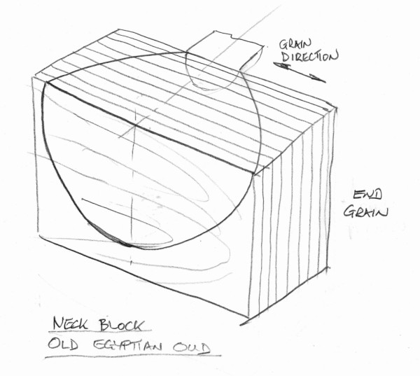

There is another possible neck block grain arrangement - one where the grain runs vertically with the ribs glued to the end grain as shown in the attached sketch.
This is the arrangement found on my old Egyptian oud and is often found on surviving European lutes (although I know of one 16th C lute where the grain runs horizontally in the neck block - as it also does in the braces).
I have used this arrangement in my recent 'Old Oud - New Project' posting on this forum.
Note that this arrangement may not prevent splitting of the block if a dovetail joint is used (as has happened on my old Egyptian oud). This is less of a problem for a lute where a large nail was often driven through the block to attach and clamp the neck when being glued in place.
With this arrangement the end grain of the block should be first be sealed with a glue 'size' (dilute hide glue) before gluing the ribs in place - to ensure maximum joint strength. This, of course, assumes that hot hide glue is being used in constructing the instrument.
The 'side grain' at the neck joint also ensures maximum joint strength.
