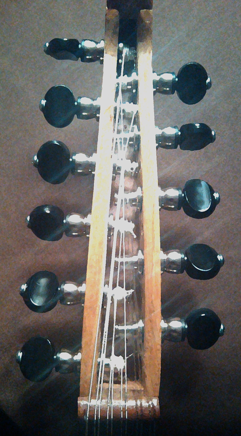

I recently bought a fairly low end oud at a flea market. The pegs were slipping a lot. I had the idea to install standard style tuners. This may be
taboo to most oud aficionados, but it worked.
I purchased tuners that are used on dulcimers from stewmac.com. I bought the Grover Champion Dulcimer/Uke Friction Pegs. I have included here a photo
of how it turned out.
myeyes2020
Posts: 172
Registered: 10-5-2007
Mood: na3im
Hi dlaw,
Thanks for sharing! I didnt know these existed. Where they easy to install and do they really not slip at all?
Adel
Very curious
Can you please tell us more, like the size you got, the cost, how you prepared the holes, and how well it's working. A clear photo would be really
nice.
Most oudies dislike machine pegs, planetary or otherwise, because they are heavy and unbalance the instrument. The best planetaries can be light but a
dozen + fitting labor often cost more than the oud + the oud player's right kidney.
Friction pegs could be a good solution. But many types of friction pegs have a history of being expensive and/or slipping.
There was a brand of beautiful Japanese violin friction pegs, Gotoh, that looked very much like ebony wood pegs, and at a decent price, but the last
time i looked they were still slipping and were being dropped by luthiers. An oud caries about half the tension per string of a Spanish guitar, but I
rather think it's more than a dulcimer's. , so im very Very curious how well yours are holding up.

Quote: Originally posted by dlaw | I recently bought a fairly low end oud at a flea market. The pegs were slipping a lot. I had the idea to install standard style tuners. This may be
of how it turned out. |
David, I suspect you may have started something big here. This looks to be an elegant, albeit not cheap, solution to a problem experienced by many
people.
http://www.stewmac.com/shop/Tuners/Dulcimer_tuners/Grover_Champion_...
Thanks for sharing it.
Regards,
So each string is mounted on and pulling on one side of the pegbox? Of course the sum of tensions is the same, but it feels a bit sqirrelly at first
glance. Can you please tell us more?
