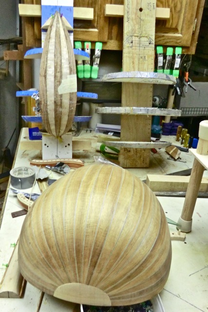

So, if anybody is interested, here is where I stand with the oud. Koa. Nowhere near done, obviously. I just can't seem to get more than one oud
done per year.

I am afraid it is too late for this oud--I have just made the neck and peg box, so I am going to follow through with the 6 courses. But, I have
another one not far behind--you can see it int he pic (maple and walnut), and by the time I am done with that bowl I think I will be up for tackling
the project of a 7 course oud.
