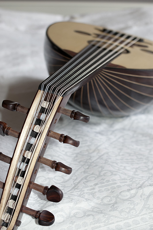

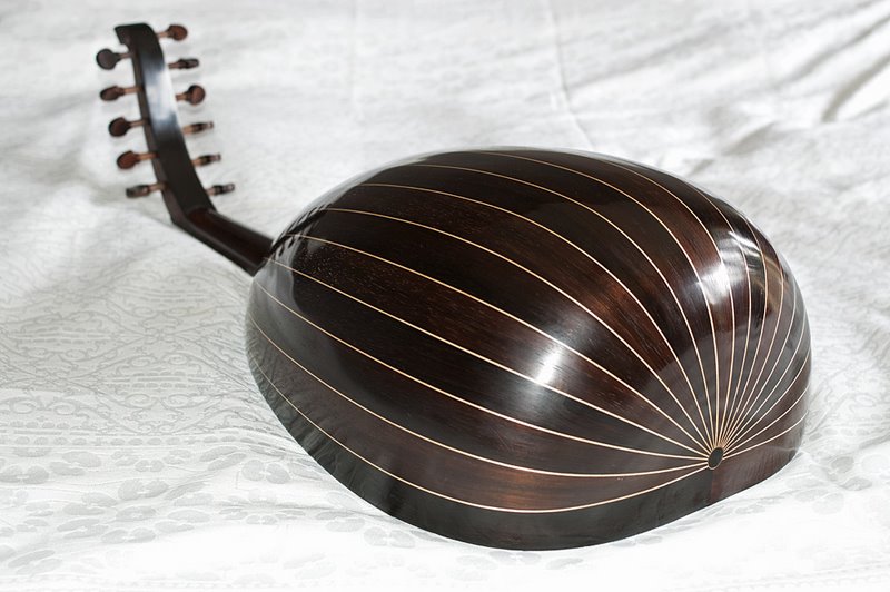

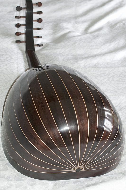

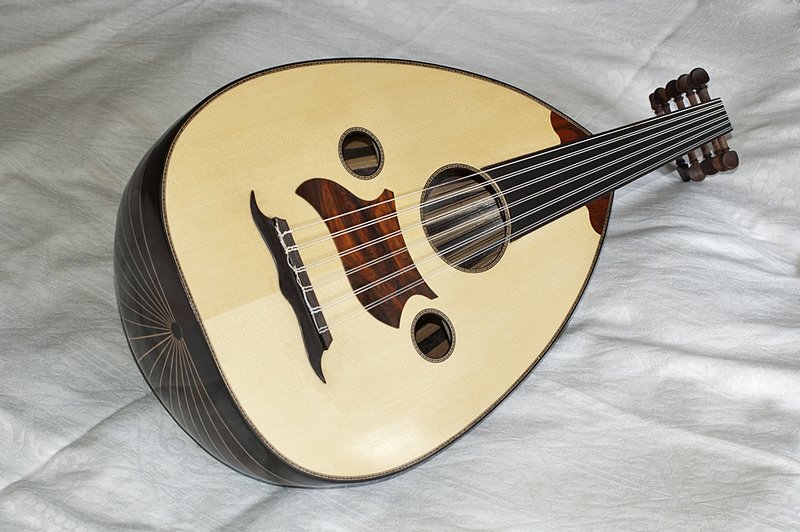

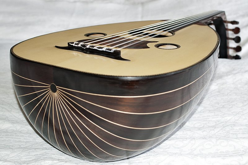

I would like to share this new oud I have finished building yesterday. Started 2 weeks ago with an Old stock (before 1995) Brazilian rosewood (BRW)
and the result is here.
I had some days off with eastern and could progress with the build.
Bowl. Dark Brazilian rosewood. / maplestripes in between.
soundboard: first grade german spruce.
neck/bridge/pickgard : BRW
pegbox: maple/brw/ebony(back)
fretboard/ebony with 2 stripes brw
nut: ebony
pegs: ind rosewood.
string: aquila.
purfling and rosette surrounding / hand made veneer and maple

Beautiftul work; this oud looks amazing- whats the scale length?
Cant wait to hear the sound.
Do you have a customer waiting or will it be for sale?

Hi Kelly,
Thank you, the string lenght is 58,5. the body, 50cm lenght, 36,5cm wide.
I don't have a customer waiting for this one. I will keep it first for a while and i'm not sure if I will sell it.

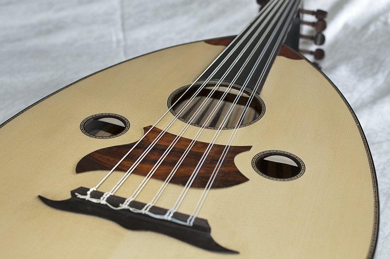

There are more details about this oud than I can describe. the action is very nice the strings goes along the fretboard perfectly. if the strings are
to close(low action) they won't breath enouph to make a good vibration if to high, difficult playing etc..
the distance between the strings on the fret is exactly like descibed in the following view : C......G......D.....A.....F....C. the higher strings
are closer to eachother as they are not used much when playing, the lower once are wider to make easy playing
for this reason the neck is made 3.8mm at the top and 5.8mm at the neck joint, that makes playing
very smooth.
the face is 1.8mm (finished and varnished), the bridge is about 35 grams.

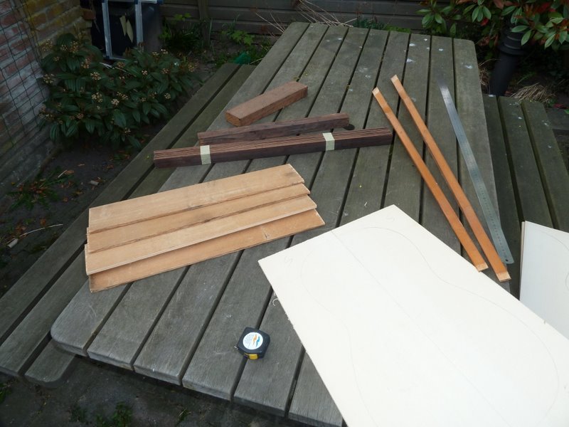

the braces are all 4.6mm thik from a 50 years old piano brace. picture top right:
regards,
samir

- I noticed that you introduced a fixed bridge design for the first time. Do you have a certain preference (floating/fixed bridge)?
- How do you tune your ouds?
Thanks for making all of us DROOL
Hatem
sabbassi
Posts: 570
Registered: 4-28-2008
Location: Morocoo
Mood: happy
Thank you Brian and Mavrothi .
Hatem, thank you my friend, I have made man Fixed bridge in the past. I must say that a fixed bridge is my preference way of making an oud.
I use standard strings arabic tuning CGDAFC
