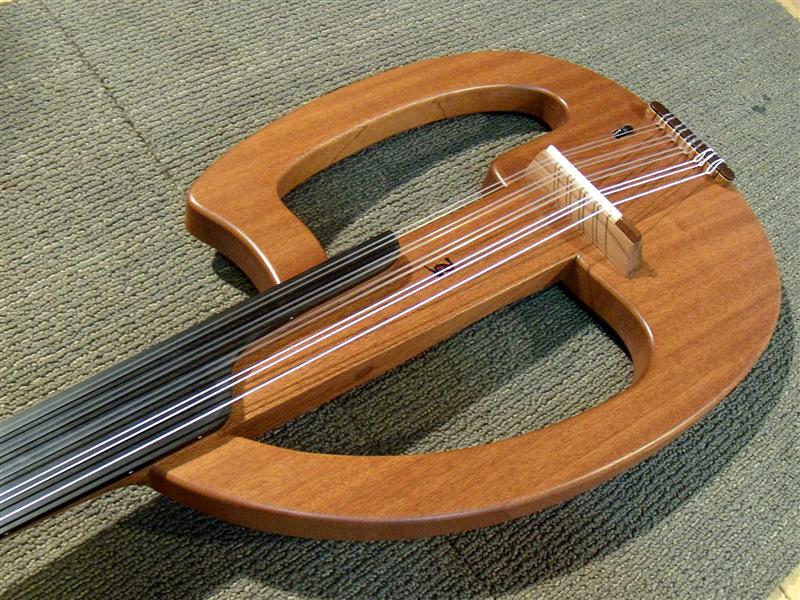

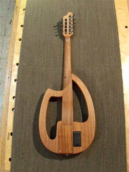

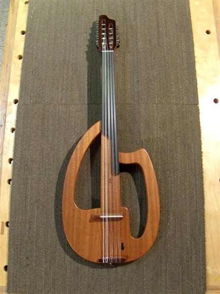

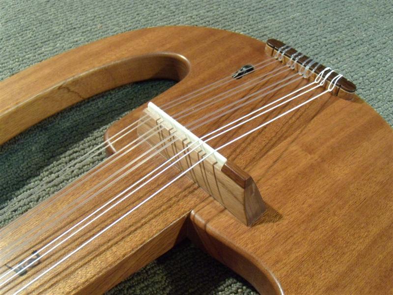

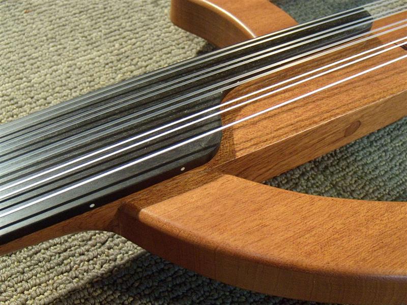

New instrument - Electric MandolaOud for Yaki Reuven + Video
A combination of an Electric Oud and a Mandola
5C - 4x2+1
Enjoy the photos - a video will come soon
Yaron Naor
Yaki's website: http://www.mandolinmusic.co.il
DSCN4297 (Medium).jpg - 93kB DSCN4298 (Medium).jpg - 136kB DSCN4299 (Medium).jpg - 116kB DSCN4300 (Medium).jpg - 90kB DSCN4301 (Medium).jpg - 102kB DSCN4304 (Medium).jpg - 59kB DSCN4305 (Medium).jpg - 60kB DSCN4311 (Medium).jpg - 63kB

Wow! Incredible player, amazing range on that instrument Yaron.
What are the dimensions, scale length, pick-up etc?

Thanks Sazi!

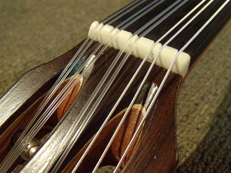

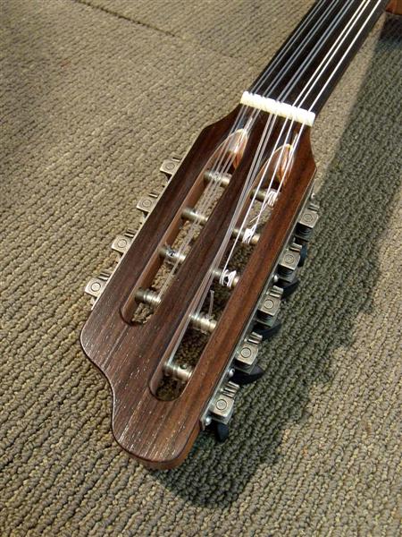

Yaki Reuven is a master mandolin player who is playing ethnic music and world music so I built this instrument to enable him play with ethnic band on the same octave
All Mahogany,
52.5 cm scale, 5C - 4x2+1 Mandola tune.
Nylon and wounded strings
Buffalo bone nut and saddle
Gotoh tuners
Yaron Naor

I'm sure he must be very happy with it.
I can see it's active, but what is the pick-up and pre-amp? (It sounds like a good combination.)
All the best, S

Hi Sazi,
Yaki is very happy with it...:D
The pick up is an under saddle pick with a preamp already inside the jack connector, he bought it.
