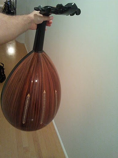

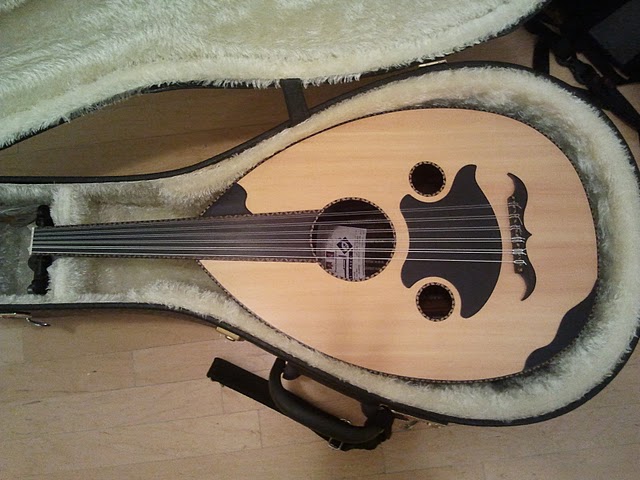

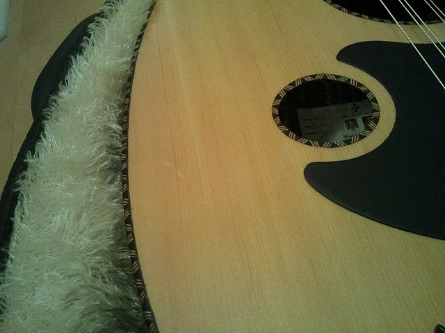

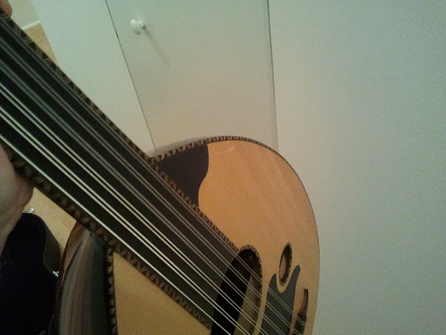

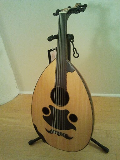

There's nothing broken in the oud (there are only 2 small scratches, see photos) but the strings are buzzing. There's no oud luthier in my area. I tried to take it to a guitar repair shop but he couldn't figure out where the buzzing was from. To be honest I have no clue how much it would cost to repair, so if you decide to buy it please keep this in mind.

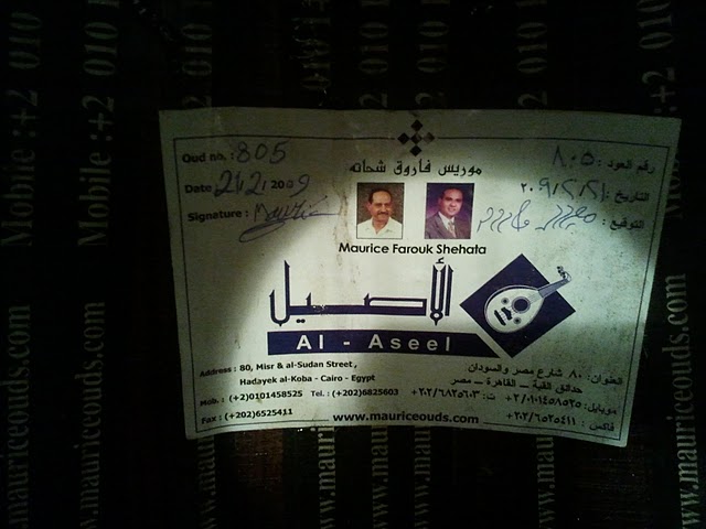

FYI, it is oud number 805, made on 21 February 2009. You could call Maurice Shehata to ask about it.
